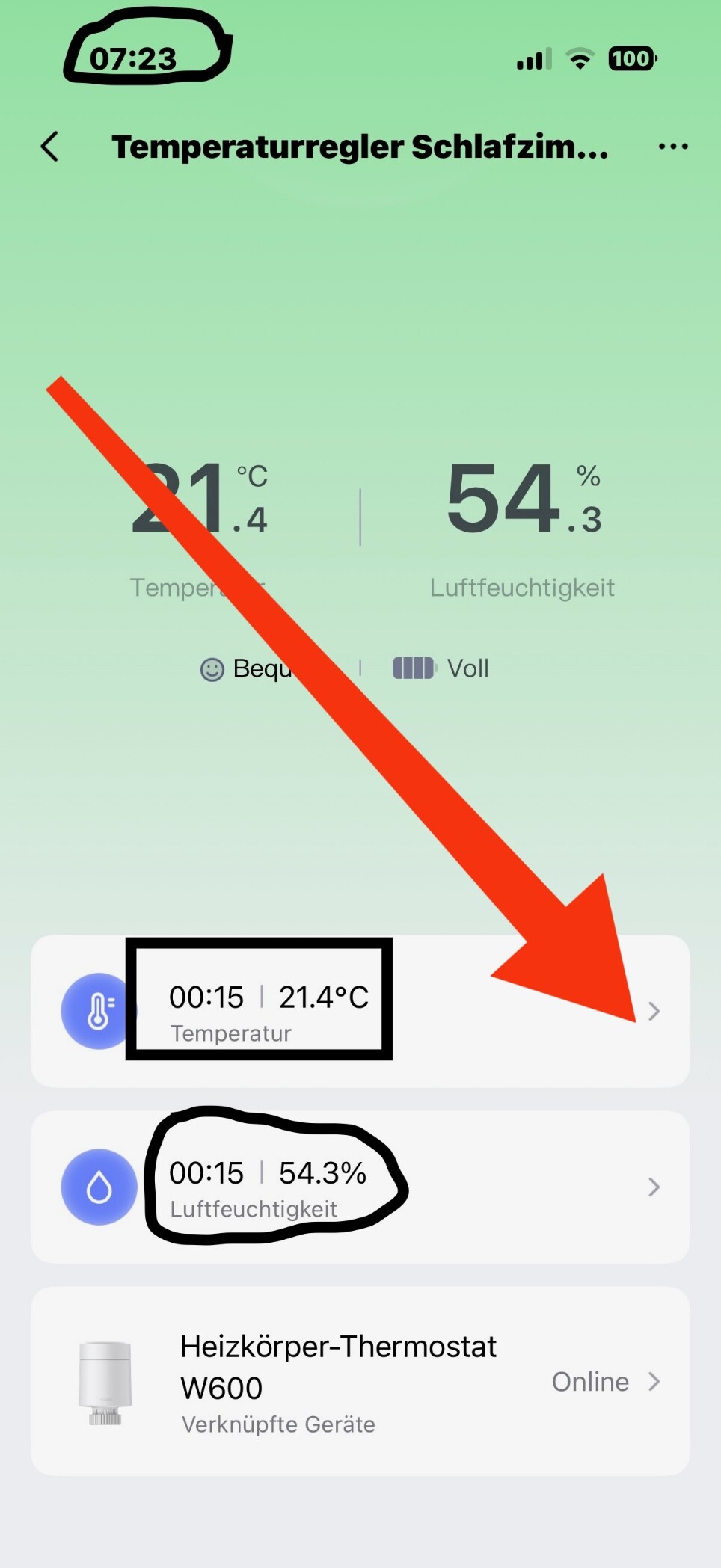

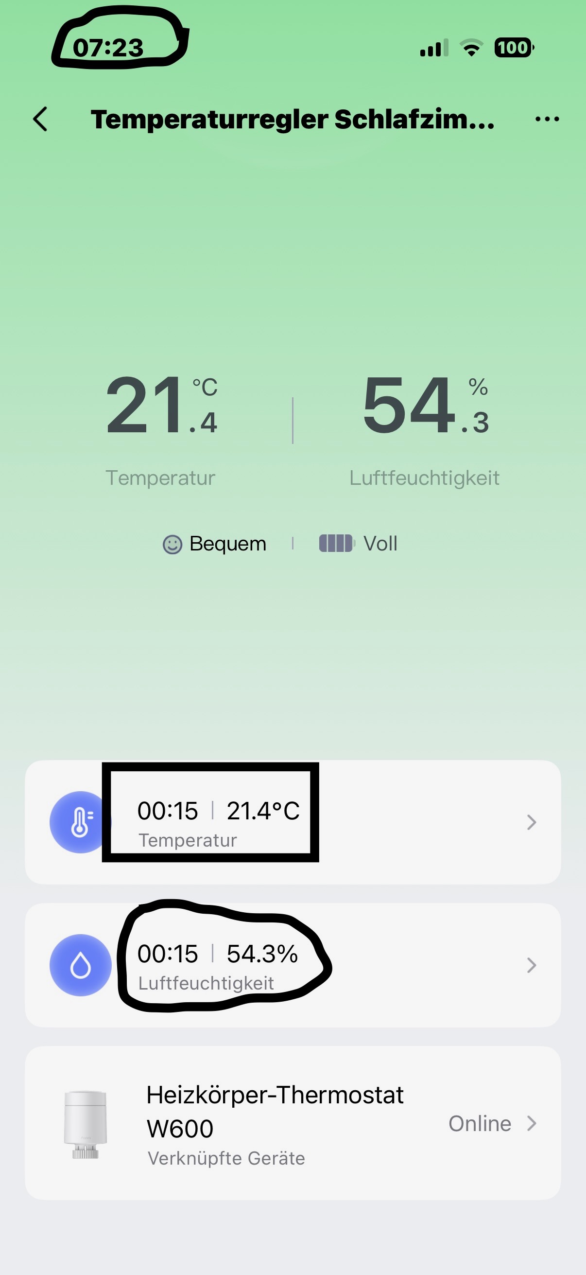

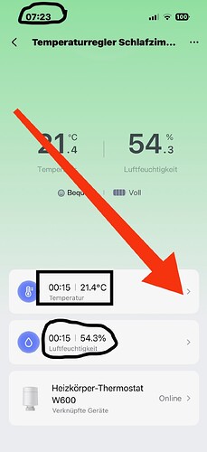

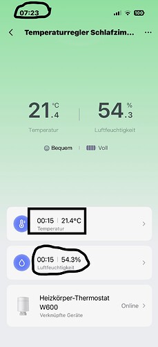

-Unfortunately, the view from the W100 does not update automatically in the app.
-The display in the app is frozen.
-The display only updated after I pressed a button on the W100 and completely closed and reopened the app.
-currently it works

Hi, can you open the temperature graph, what does it show?
