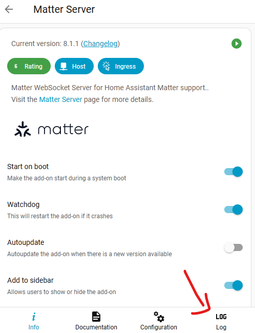

Did you look directly at the logs in the plug-in?
There, you should at least see the entry
“Starting Matter commissioning with code using Node ID.”

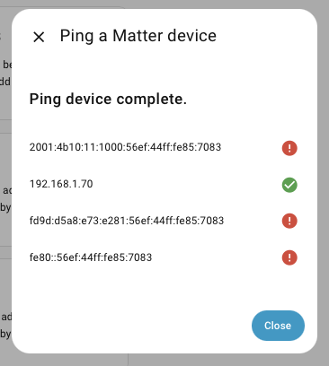

My disabling of ipv6 was on a previous system, not this one (my bad - I forgot). This one both shows an ipv6 address on the Ethernet interface end0 and responds to ping6. What it doesn’t do is receive a response to an outgoing ipv6 ping from the Thread integration, as per my screenshot. Which is weird.

The fact that Home Assistant lists the IPv6 addresses (via mDNS discovery) but fails to ping ANY of them strongly suggests a configuration issue on the Home Assistant host itself.
Please go to Settings → System → Network in Home Assistant.
Check the IPv6 setting of your Network Adapter. It is likely set to “Disabled”. Please set it to “Automatic” (DHCP).
Once HA acts as a proper IPv6 client, the Thread integration should be able to communicate with your Border Routers
