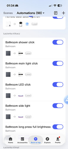

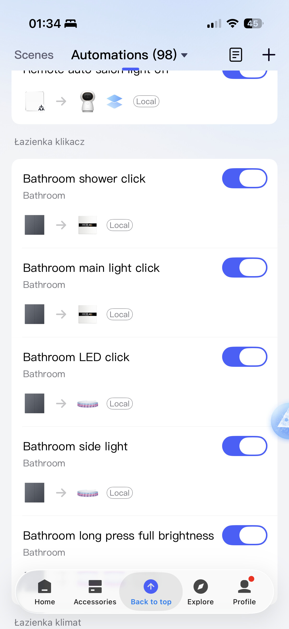

Check the label next to your automations. If it says “local”, then your hub does not need WiFi/internet to work.
You can also open the automation, click three dots and “Automation Type” to check if it’s run locally.
I have the Hub M3 and almost all my automations are local.
Mind you, if you have poor internet (WiFi connection is present, but the internet is barely working), then some automations may still work poorly/with a delay, because the hub will try to update the current state/settings of your devices in the cloud while running the automation. But when the internet is disconnected, the automations will work without any problem.
