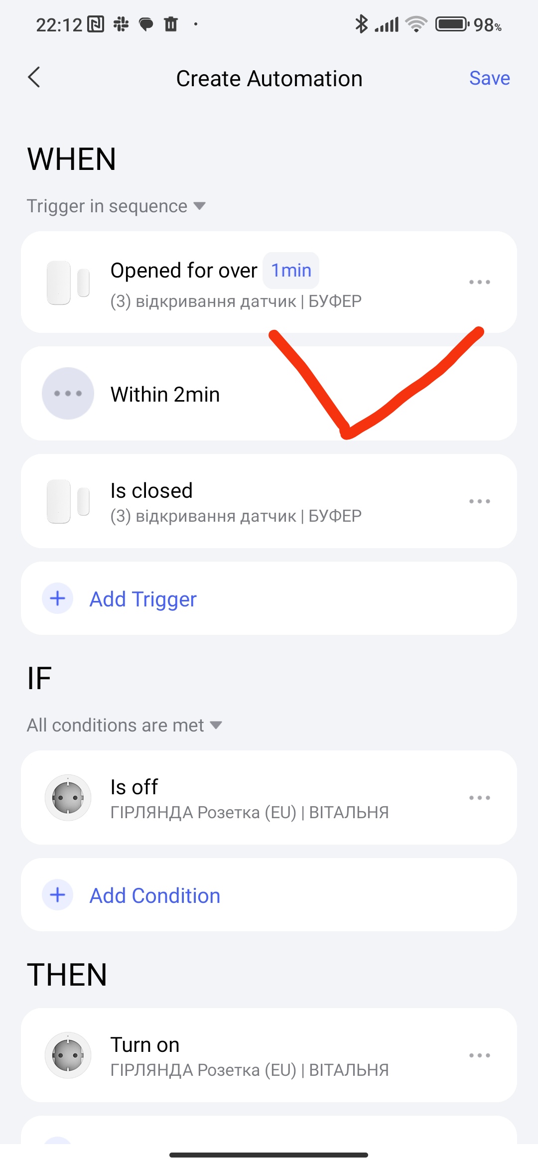

Hello, you need to make this type of automation. Also check out my lesson 5 about vector movement (in your case, vector opening/closing of the balcony). 2 minutes is a waiting period, after this time the first condition burns out (doors open for more than 1 min) so choose experimentally. It must be longer than 1 minute (to cover the time of 1 min. open doors). Automation 2.0, Lesson 5, vector lighting control by sensors

So the idea is to create a sequence trigger, where:
  1. The door (in my case, the balcony door) stays open for more than 1 minute
  2. Then within the next 2 minutes, it has to be closed
    → in order to trigger the automation.
However, in my situation it’s not very practical. I usually keep the balcony door open for about 10 minutes (In summer, it can also be significantly longer) when ventilating, and the “within” option can only go up to 5 minutes. After that time, the “opened for over 1 min” condition expires, so the automation doesn’t run when I finally close the door.
And it will probably be a little difficult to explain to my wife that she must close the balcony door within a specified period of time :wink:
That’s why I’m still looking for a way to express this logic more flexibly - something like “had been open for more than 1 minute before closing,” which worked in Automation 1.0.
Any ideas on how to achieve that behavior in Automation 2.0 would be very welcome - and thanks again for your helpful explanation!

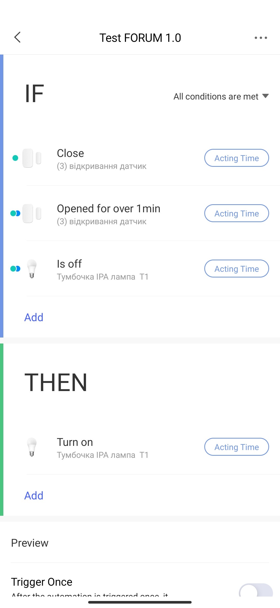

Hello, I tried different options, unfortunately at the moment the automation algorithm 2.0 cannot fulfill your conditions. My recommendations, switch to automation mode 1.0 and recreate your old automation. Fig.
Lesson 1, at the end I made a note 3, how to switch to 1.0.

Indeed, I had already considered simply recreating the automation as an older version. I have now done so.
