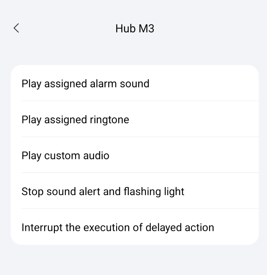

Can I set my pods to audibly sound an alert/siren if i have water leak along with text alerts? My condo board is now requiring this. If so how!?!

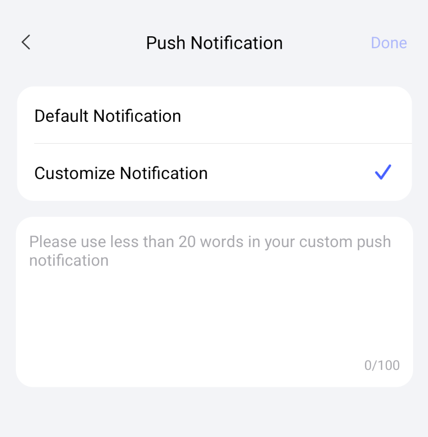

You can set up an automation with a trigger on a water leak sensor and actions to play an alert sound on a hub and send a push notification to your phone.
