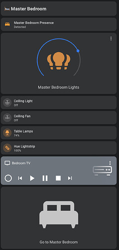

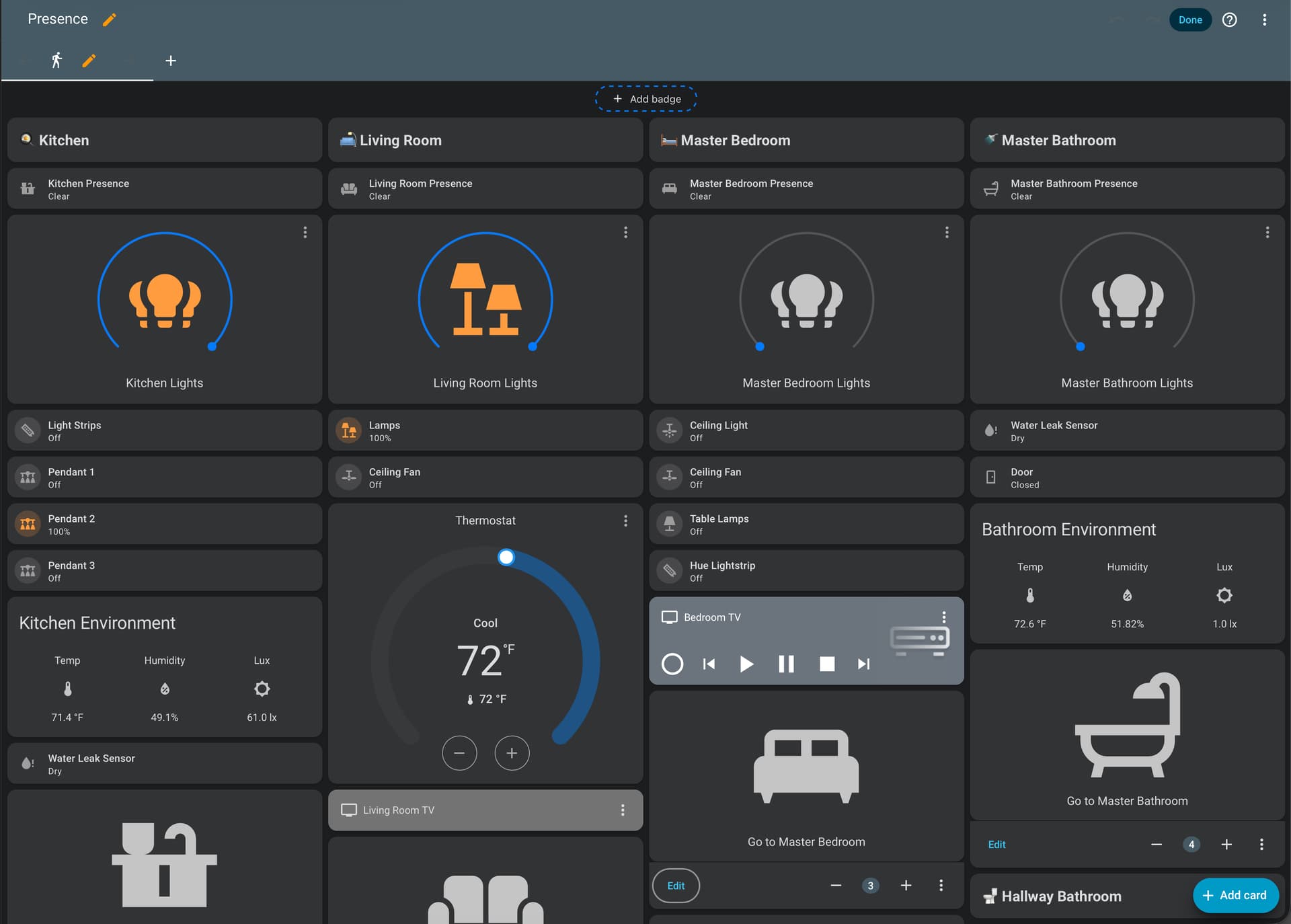

This is meant to be a quick dynamic mobile display as you move around your home. You can see what you want instantly on the screen and there is no scrolling and searching for different smart device controls.

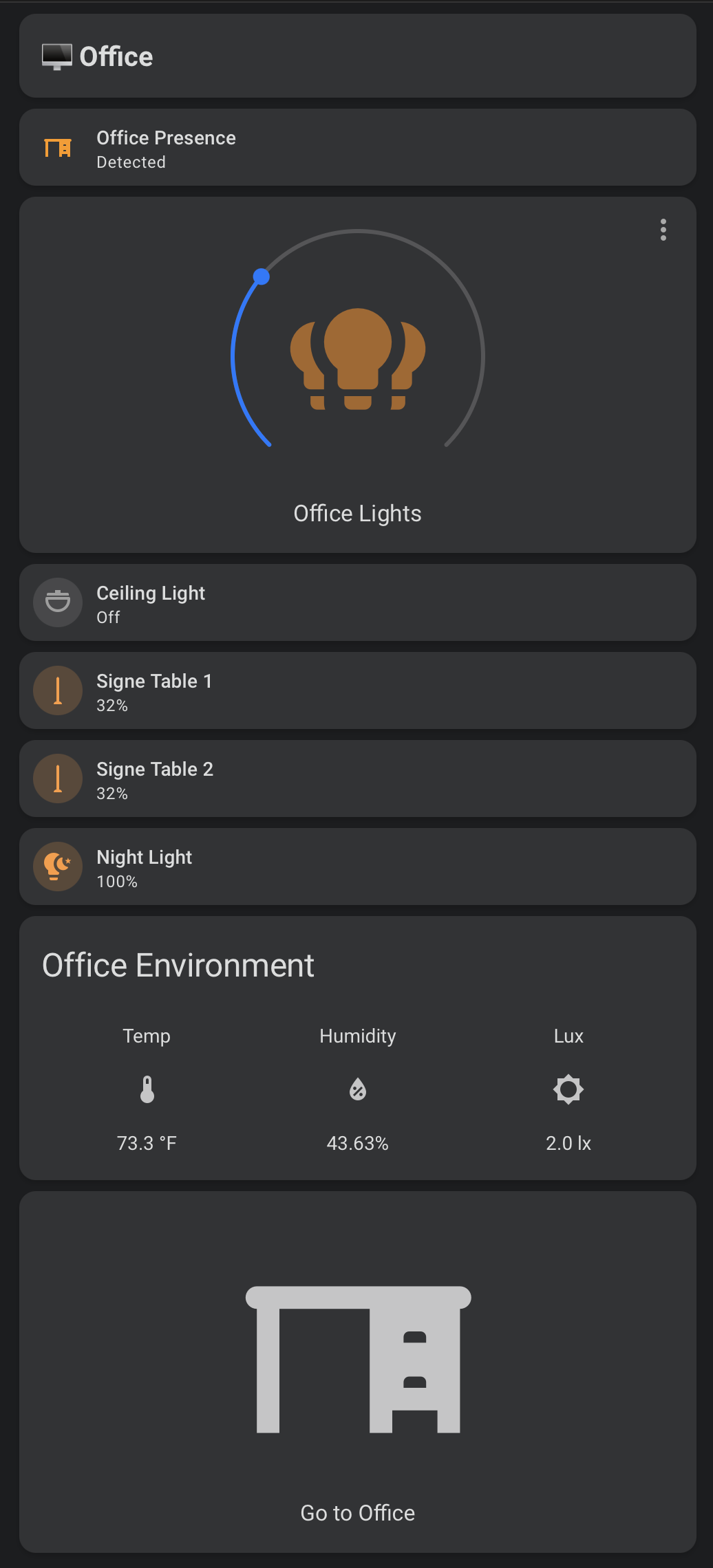

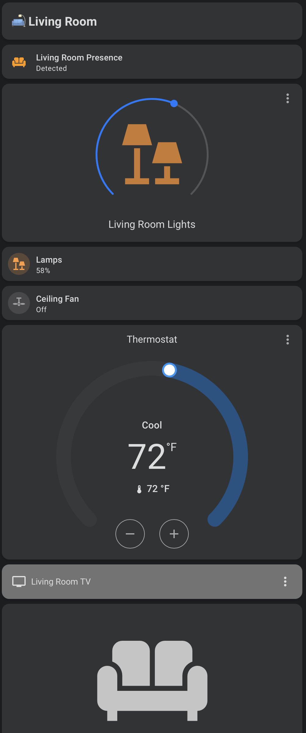

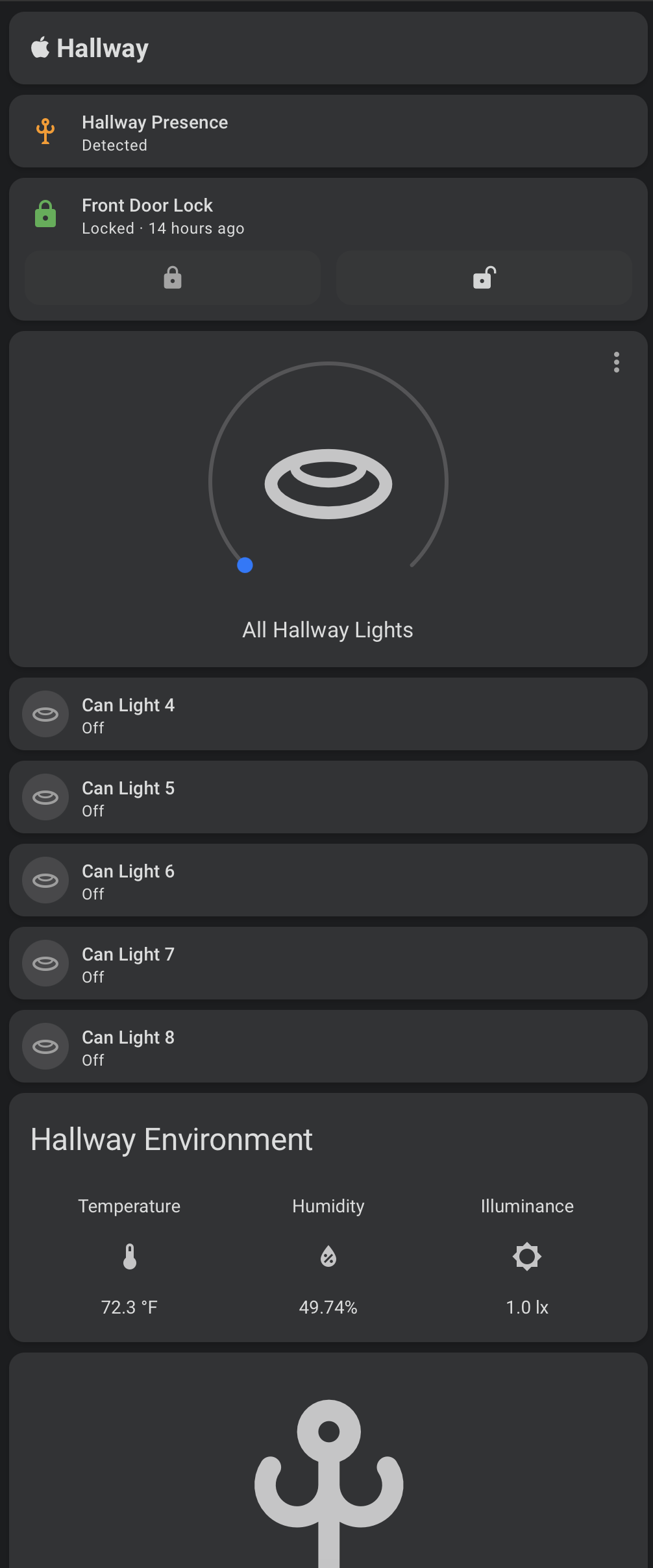

I added the Aqara FP300 MultiSensor to each room of my home that contains smart devices. When I enter that room the iPhone or iPad screen dynamically changes and displays the controls for the room. (Dynamic Presence Sensing) as I move around the home.
I tried to minimize the controls shown to keep things simple while leaving the option for the full room control at the bottom of each card. (See screen shots).

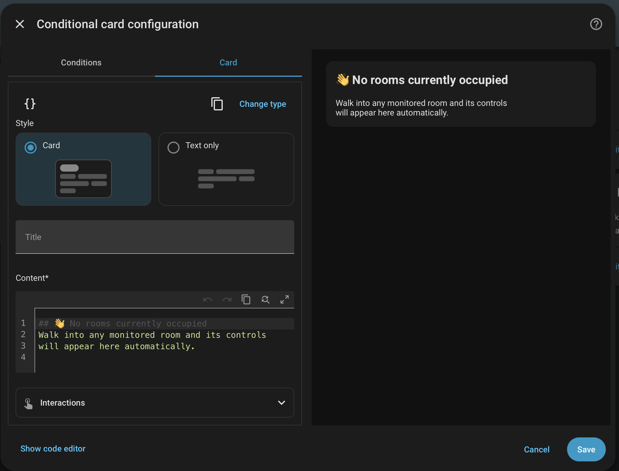

I’m using Home Assistant and the Conditional Card to display everything.
Since the FP300 MutiSensor displays Temperature, Humidity, Illuminance and Occupancy it gives the options for multiple uses and a well rounded display of information.
Conditional Card Views:
