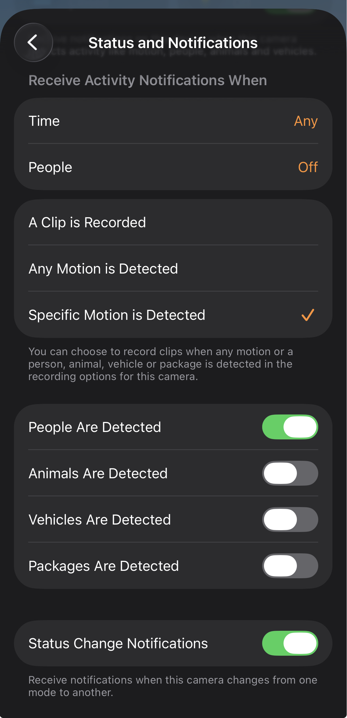

I believe Apple Home notifications have to be configured in Apple Home. So you can long press the camera/sensor and you can configure detection here. Or you can disable notifications when you’re at home if you go to “Status and notifications”. Or maybe I’ve misunderstood something and we’re talking about different kind of alerts

To avoid false alarms in Apple Home (like from headlights), you should choose the option “Specific Motion is Detected” instead of “Any Motion is Detected” in the recording settings. If you select only people or vehicles there, pure light changes are usually reliably ignored. If you use an iCloud+ subscription, you can additionally define “Activity Zones” in the Apple Home camera settings to completely hide areas like a street.

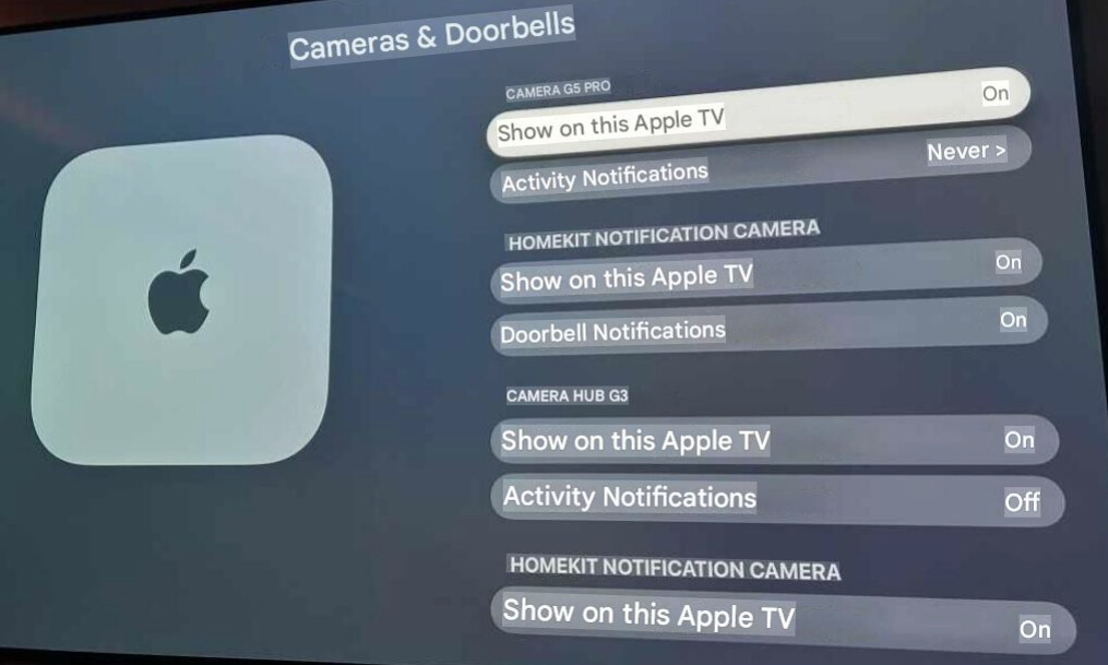

For notifications on the TV, the following also applies: Apple Home settings are transferred to other devices via iCloud, but the Apple TV additionally has its own setting for the overlay. Under Settings → AirPlay and HomeKit → Cameras & Doorbells, you can determine whether this specific Apple TV should display the image upon motion or not.
