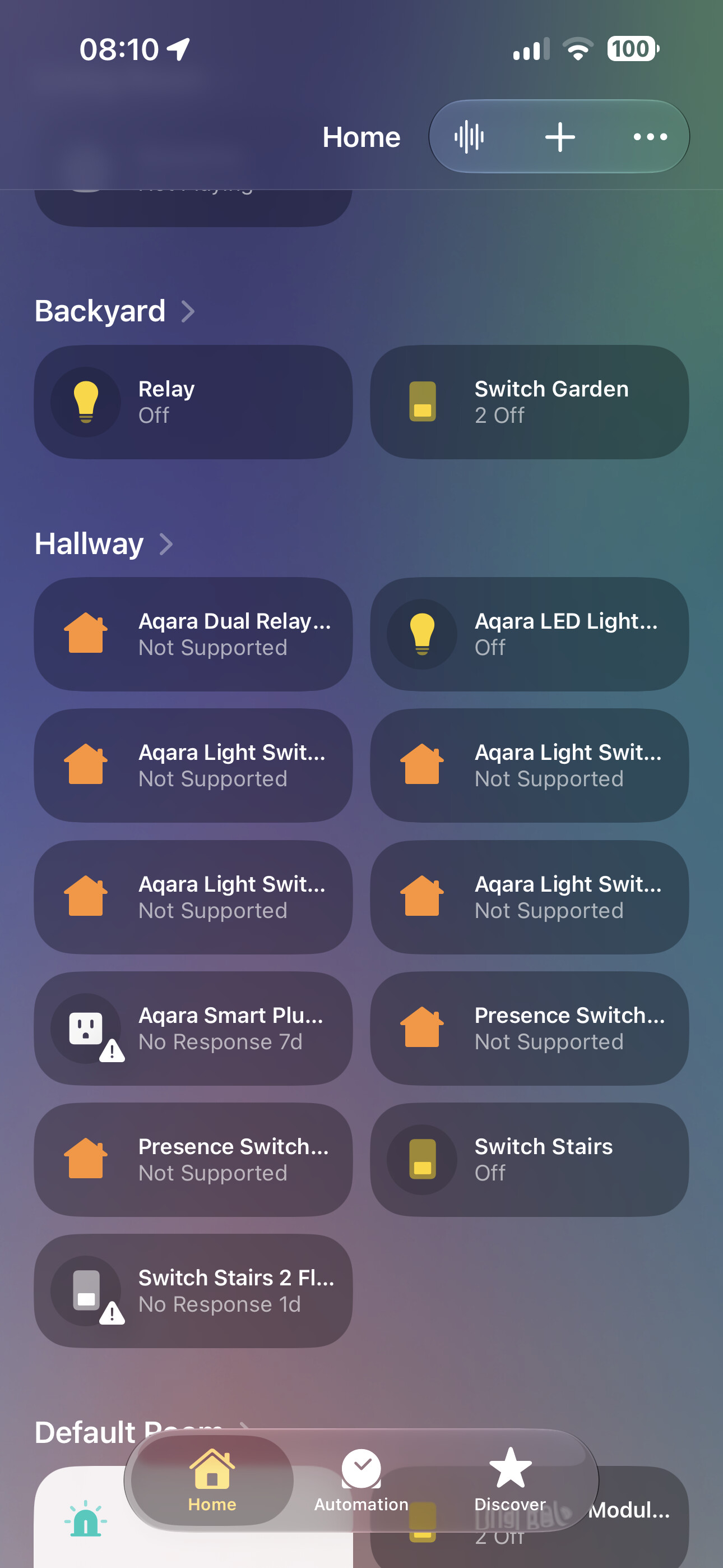

Apple Home with Services not supported after Aqara firmware upgrade
Hi.
After i upgrade Aqara hub m3. A lot of devices (switches) is showing as not supported.
Hello, try restarting the M3 with the Aqara APP. It helped me.
If they work on Aqara app also take out from the socket the apple device you use in home kit as controller for about 1 min as yesterday happen to me with an plug on aqara home app was working great but on Apple home app was without response.after I reboot my M3 was still the same till I also toke out my Apple TV 4K from the socket for about 1min then I plug it again and the plug was working again.
I’ve seen the fix mentioned a couple times now: restart the M3 from the Aqara app first, and if that doesn’t clear it, power-cycle whatever’s acting as your HomeKit hub too (Apple TV, HomePod, whatever). It’s the pairing between the two that gets stale, not necessarily either device on its own. What are you using as your Home hub — Apple TV, HomePod? That’ll help narrow down which side to reset first.
