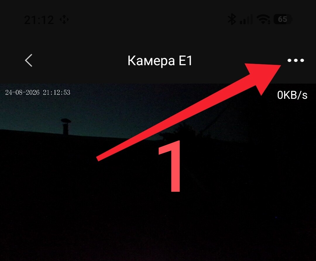

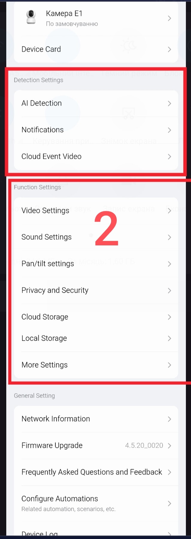

Like all devices, the settings window opens in this icon (…) in the upper right corner.
Fig.1.

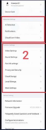

The main settings are divided into two fields “Detection Settings” and “Function Settings”.
Fig.2.

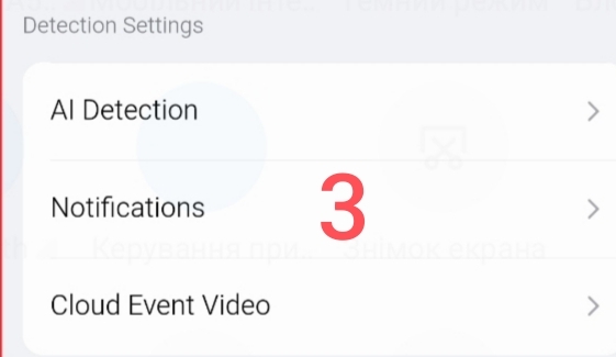

The “Detection Settings” setting has three sections.
Fig.3.

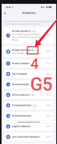

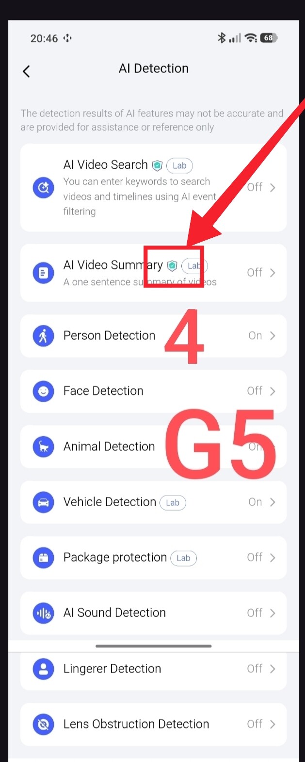

The first section “Al Detection”, this is the main event detection setting. If there is a “shield” icon next to the event setting, this means that the event detection service works via a cloud service. I want to explain, the cloud service is used because the camera processor cannot process video information. This information is processed on the paid Aqara cloud service.
How to connect the cloud service, I described here Lesson 4. Setting up the APP security system (video surveillance cameras)

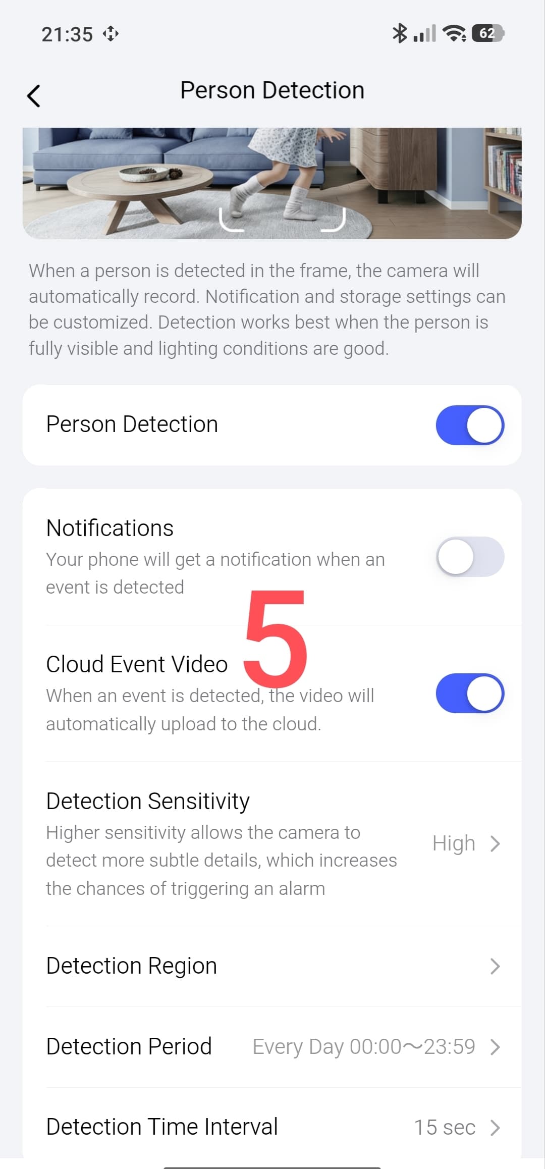

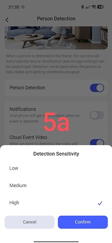

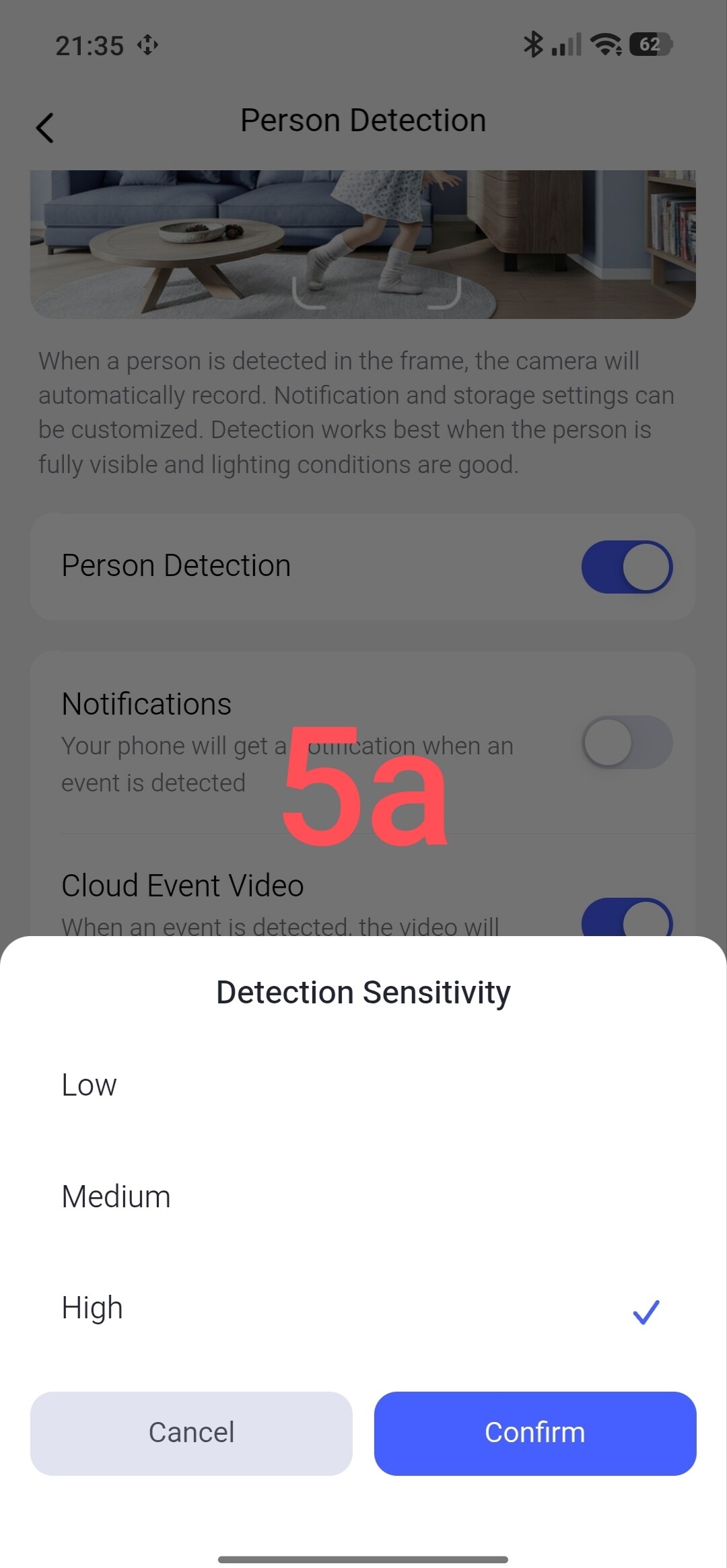

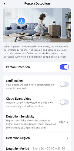

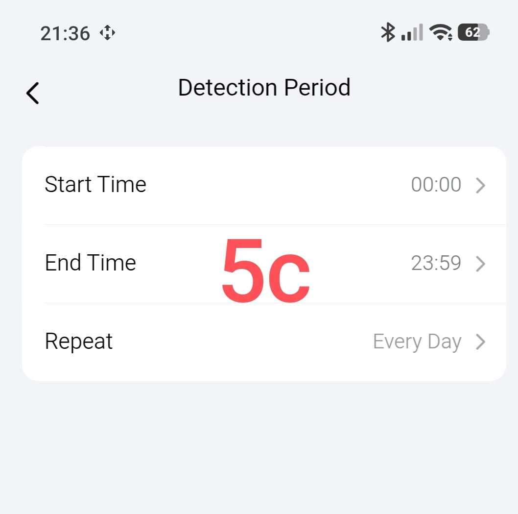

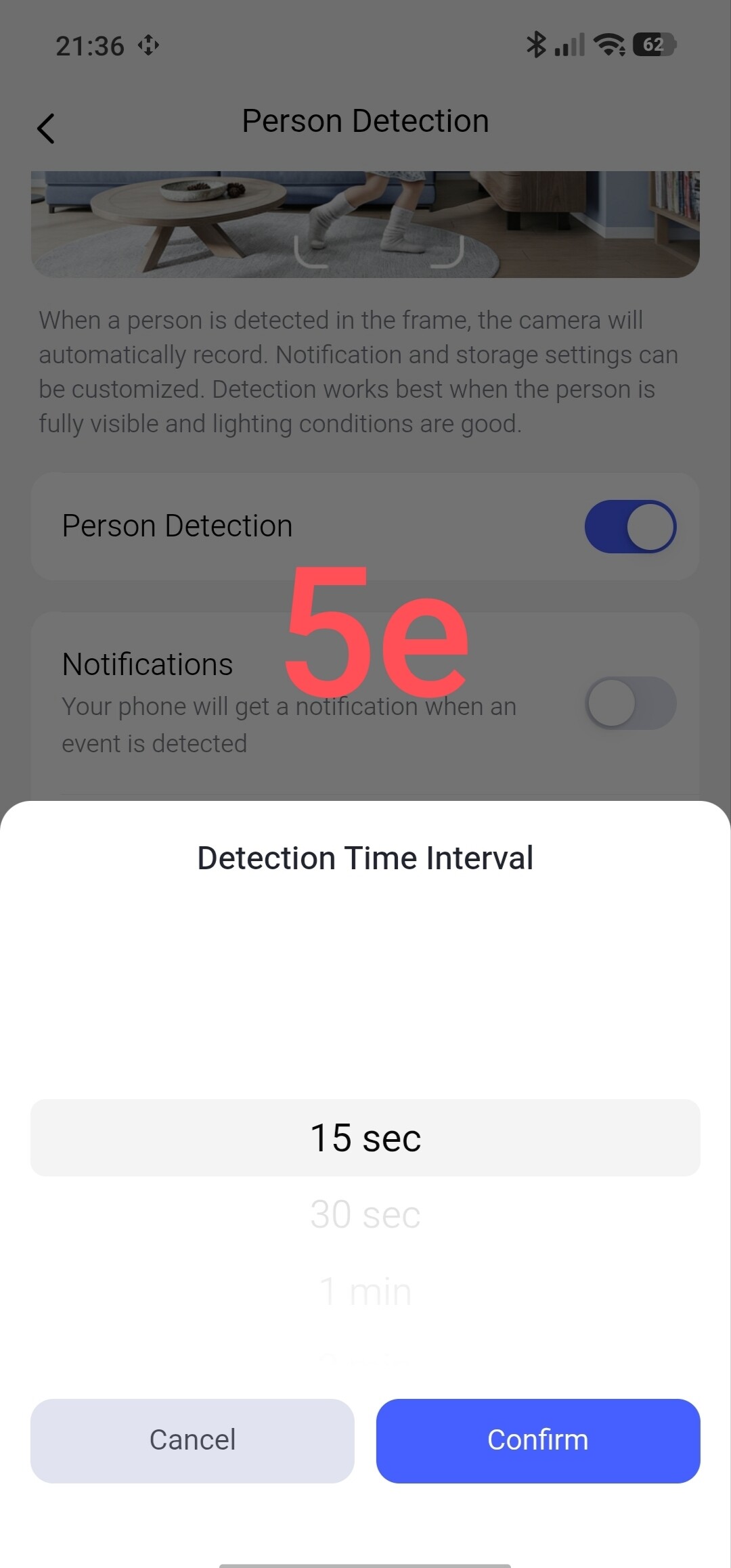

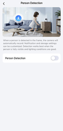

I will show pictures of the settings of the “Person detectipn” section. Similar settings for other functions. The settings contain sections for notifications, cloud recording, video analysis sensitivity, event detection region, re-search time. I show all the settings on the screenshots.
Fig5

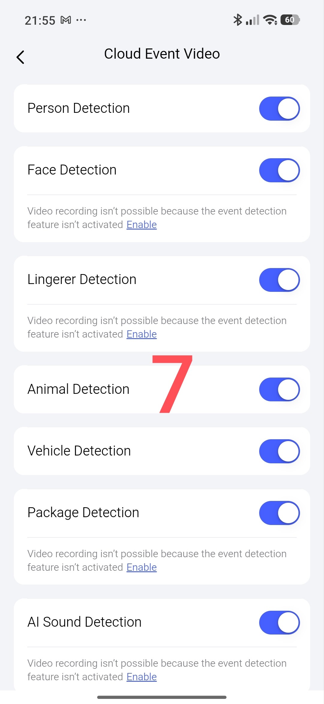

The third section “Cloud Event Video”. Similarly, this section also duplicates the settings that are in the first section. These settings are also for the efficiency of setting up storage in the cloud service.
Fig. 7

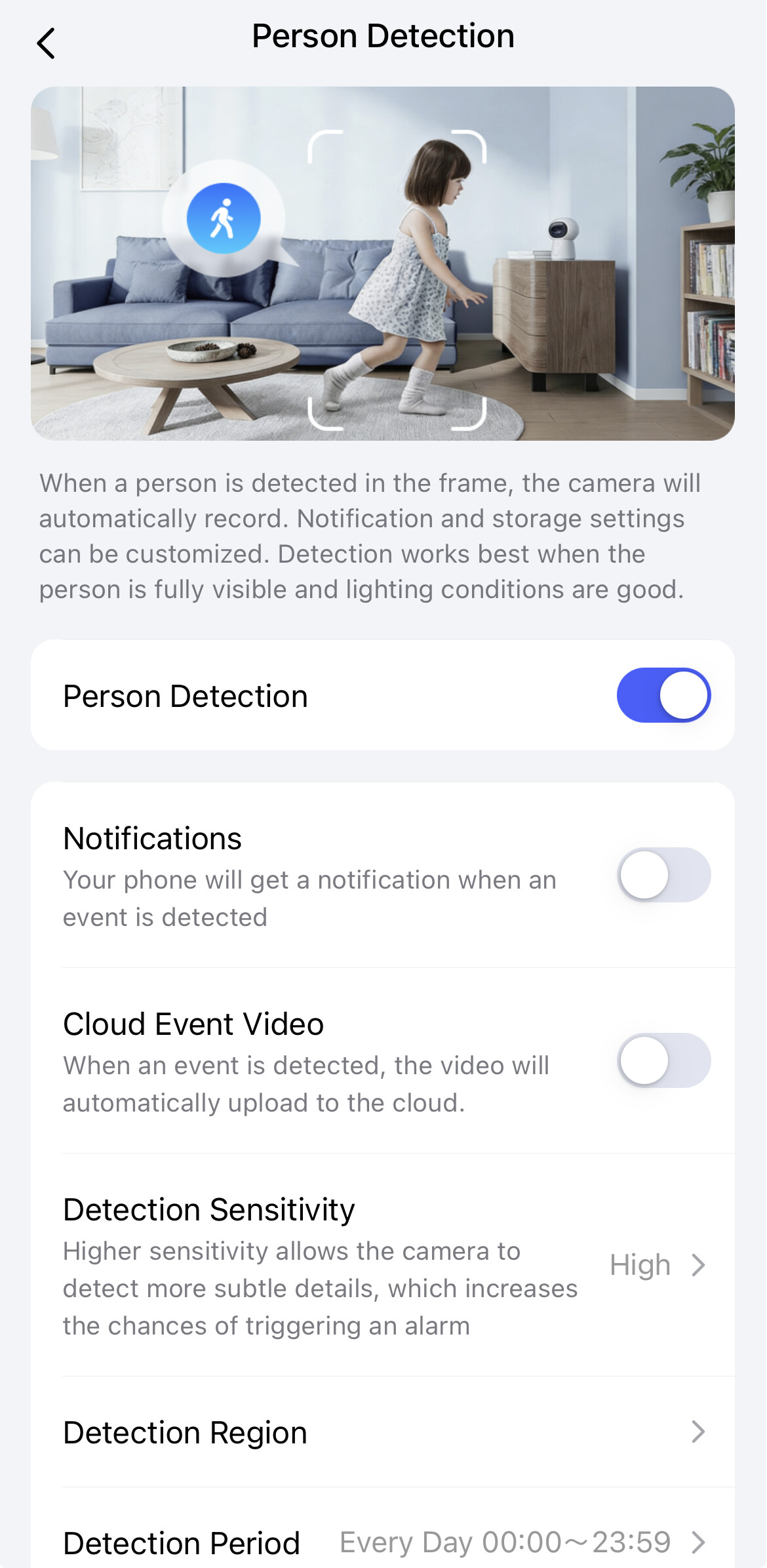

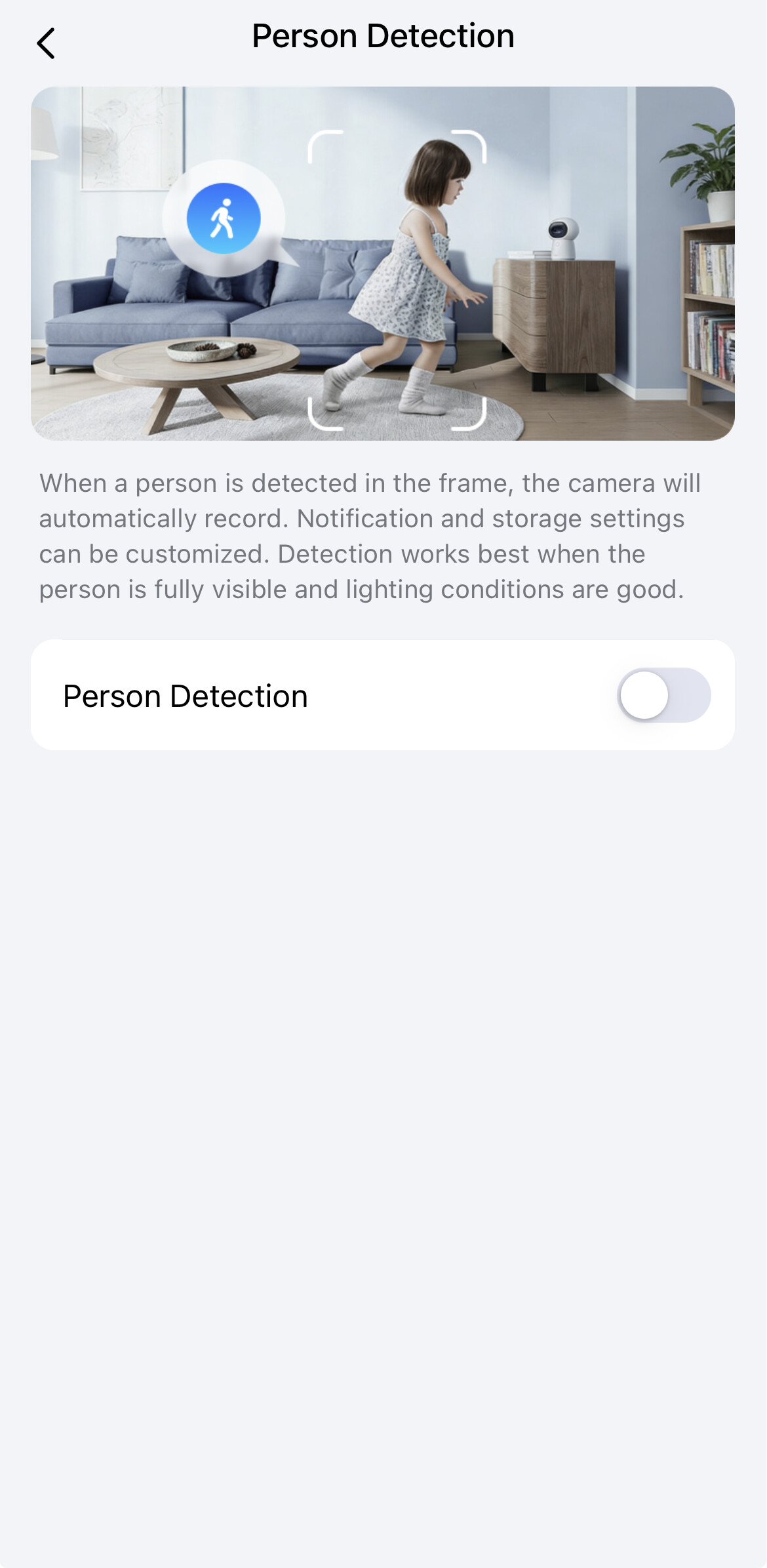

But I still have a question about this: If I enable one of the detection features but disable notifications and cloud event videos for it, what exactly happens then?
Hello, I wrote, it’s just a duplication, a quick duplication.
Thanks for the quick reply. I understand that, but my question is:
What does this setting do (Enabled, but everything else is disabled)?
Compared to this setting (completely disabled)?
Is it the same thing, or is there a difference?

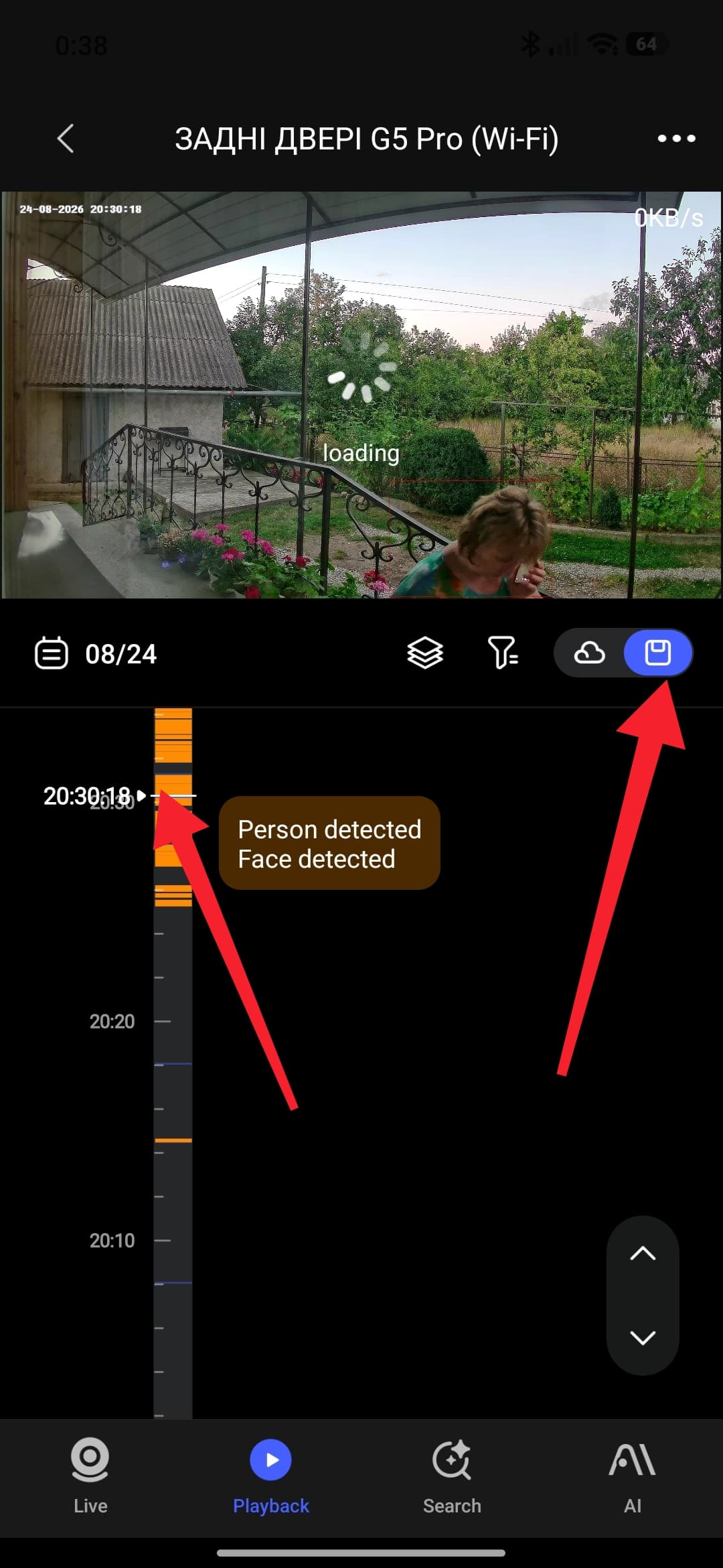

Theoretically, you will disable detection on the local storage scale (micro SD). I will give the answer for sure tomorrow.
Ah, you’re probably right about that. And only with active detection will anything show up in the timeline (log).

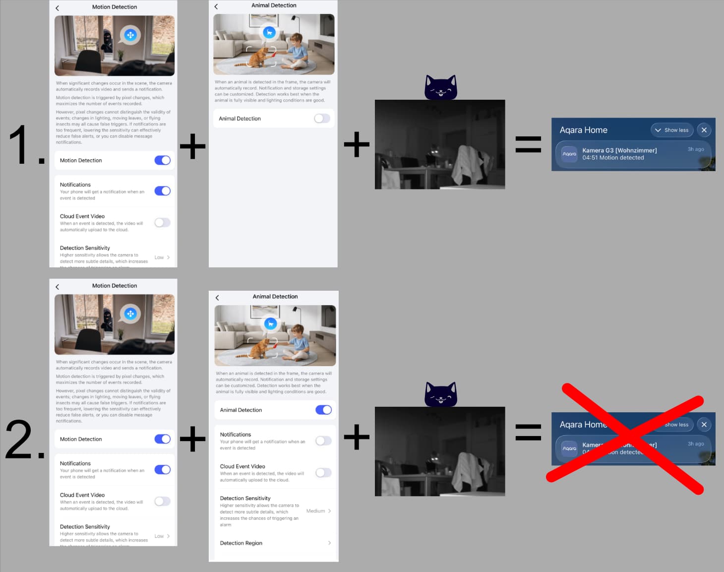

I’ve also been wondering if the following is true:
  1. Motion detection enabled with notifications enabled but pet detection disabled → as soon as a cat appears = notification
  2. Motion detection enabled with notification and pet detection enabled but notifications disabled → as soon as a cat appears = no notification
To me, that would make sense.
But I haven’t really been able to confirm it yet.
My cat is just camera-shy :rofl:
Edit: Okay, sorry. But I just figured it out myself.
It’s not what I thought. I just tried it with motion detection and person detection. The motion detection notification always comes through, even if you turn off the person detection notification. I thought that would distinguish between the two, but it detects both at the same time. So, if you have notifications enabled for both motion and person detection, you’ll receive two notifications at once. That’s too bad.
