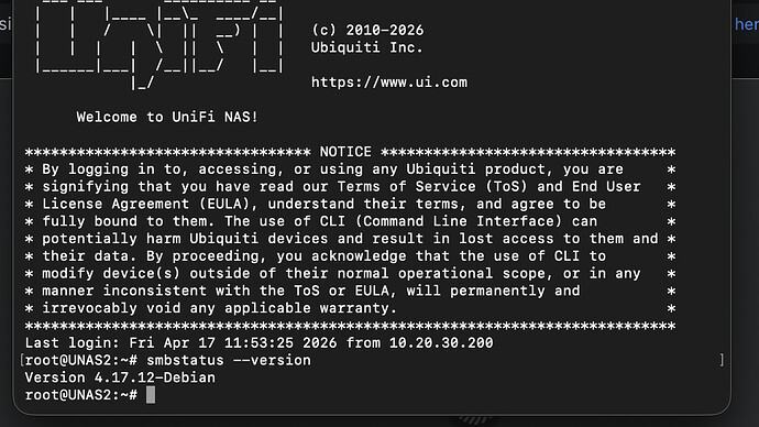

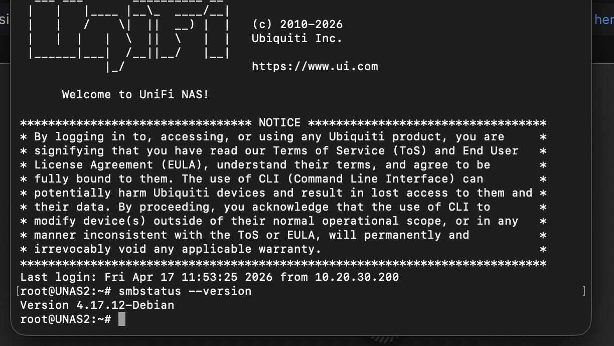

I SSH’d into the NAS and found that it’s running version 4.17.12-Debian, which is higher than 2.0:
Let me know if that helps.

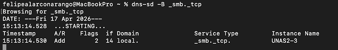

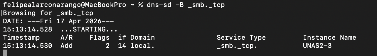

Update/Solution:
Ubiquiti has confirmed that SMB advertising is not enabled by default on their NAS products, which is a bit disappointing since other NAS brands typically have SMB services advertised out of the box.
As a result, after every reboot I have to SSH into the NAS and manually enable SMB advertising again. Since this setting isn’t part of the default configuration, it gets reset on every power cycle.
I’ve shared this feedback with them and asked that it be escalated to the product team.
