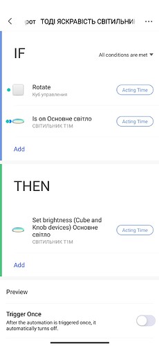

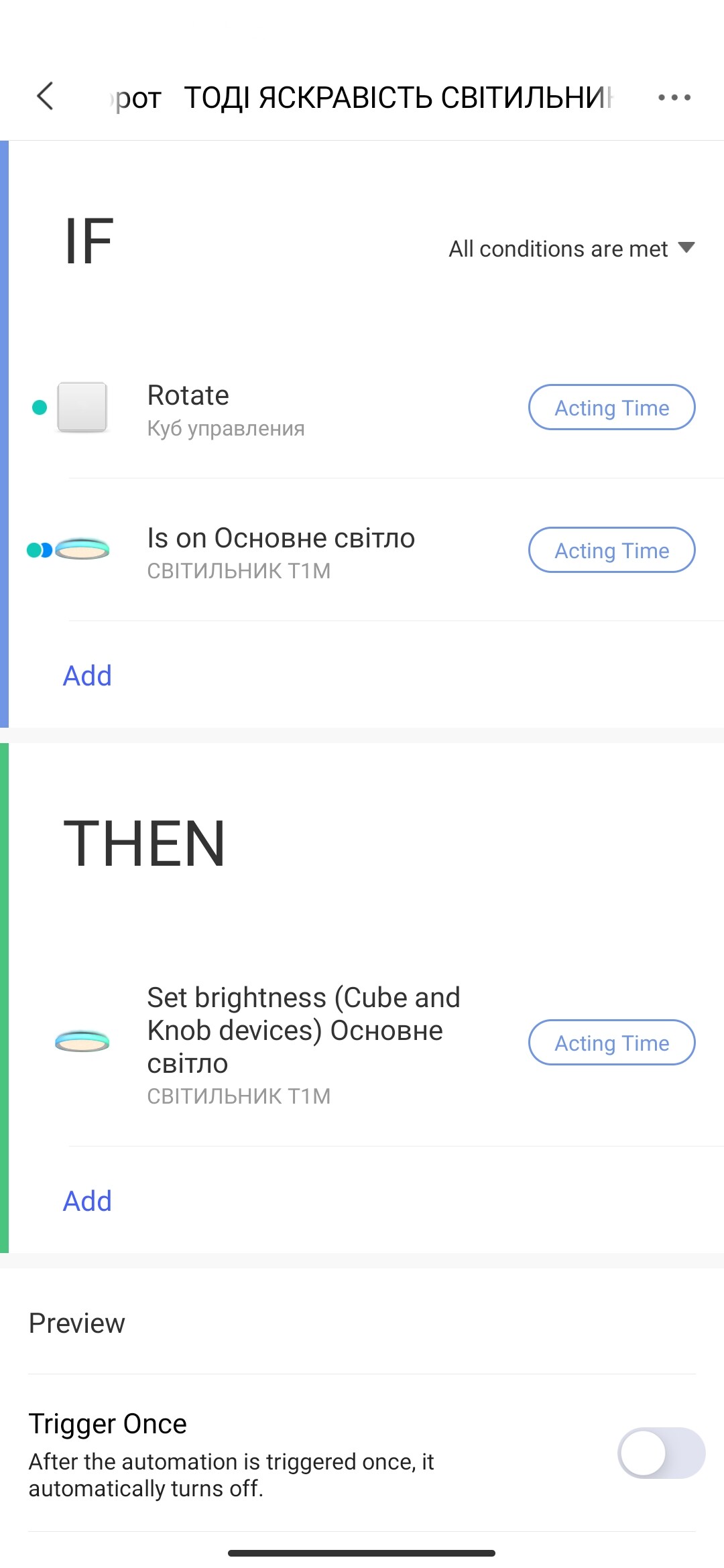

A sample of my automation. Clockwise increases the brightness of the lamp, counterclockwise - decreases the brightness… In the conditions, I put “if enabled” because there is another automation that controls the rotation of another lamp.
