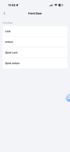

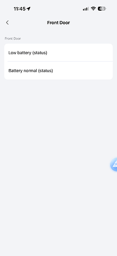

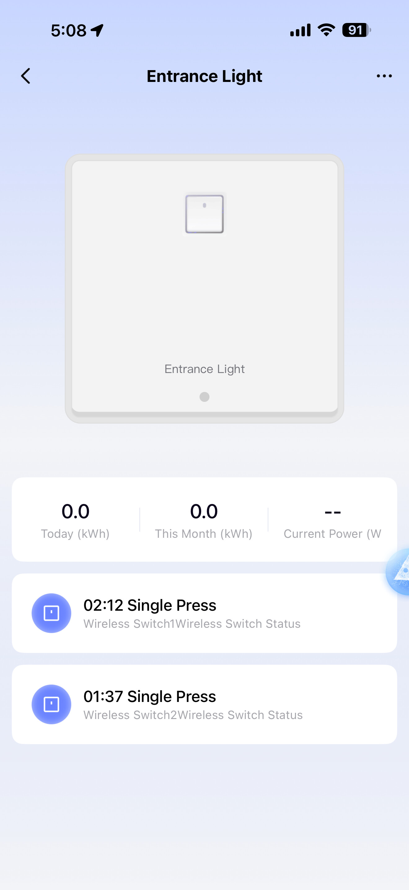

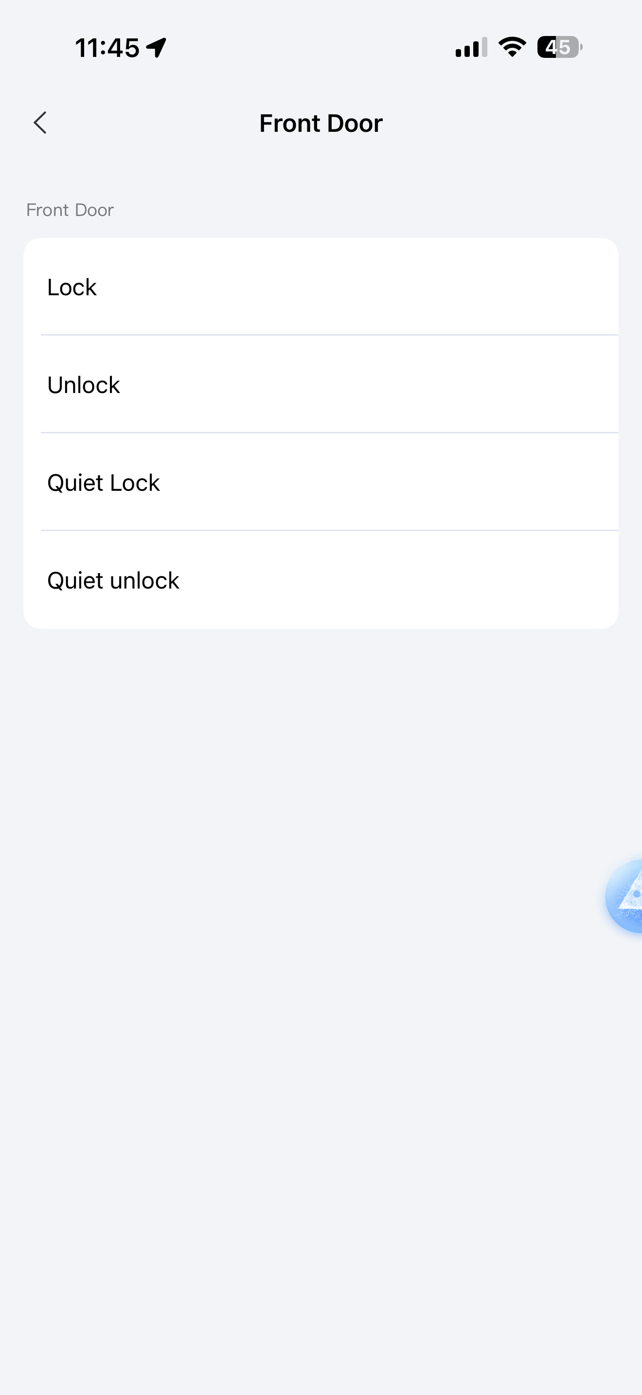

Hi, first of all thanks for the reply. So, if I try to add a simple automation, the options lock unlock are separate, if I try to add a condition like yo check the status first, and reverse, there is no option for lock unlock, only some battery status. Here you have some photos.

I think the problem is that there is no “is locked” or “is unlocked” condition to be used in the AND section.
When you configure and automation, you can select IF “single click” but you need an AND “U200 is locked” for the automation because THEN can only have “lock” or “unlock”.
The only AND you can use is the battery status (as shown above in the screenshots)
There is no universal “lock/unlock”, because those are two separate actions. And @Andrei.C probably wants a universal button that does that.
So he wants something like “IF single click AND U200 is locked THEN unlock” and “IF single click AND U200 is unlocked THEN lock”

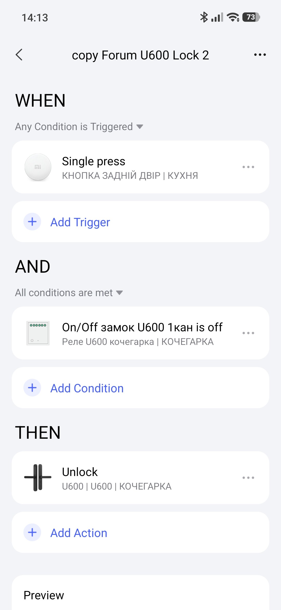

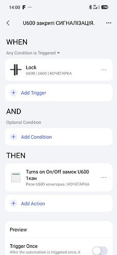

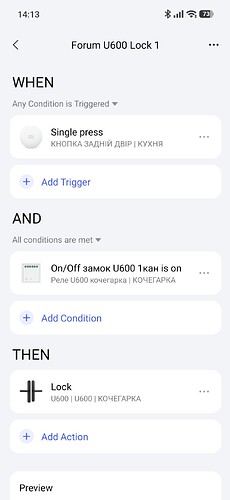

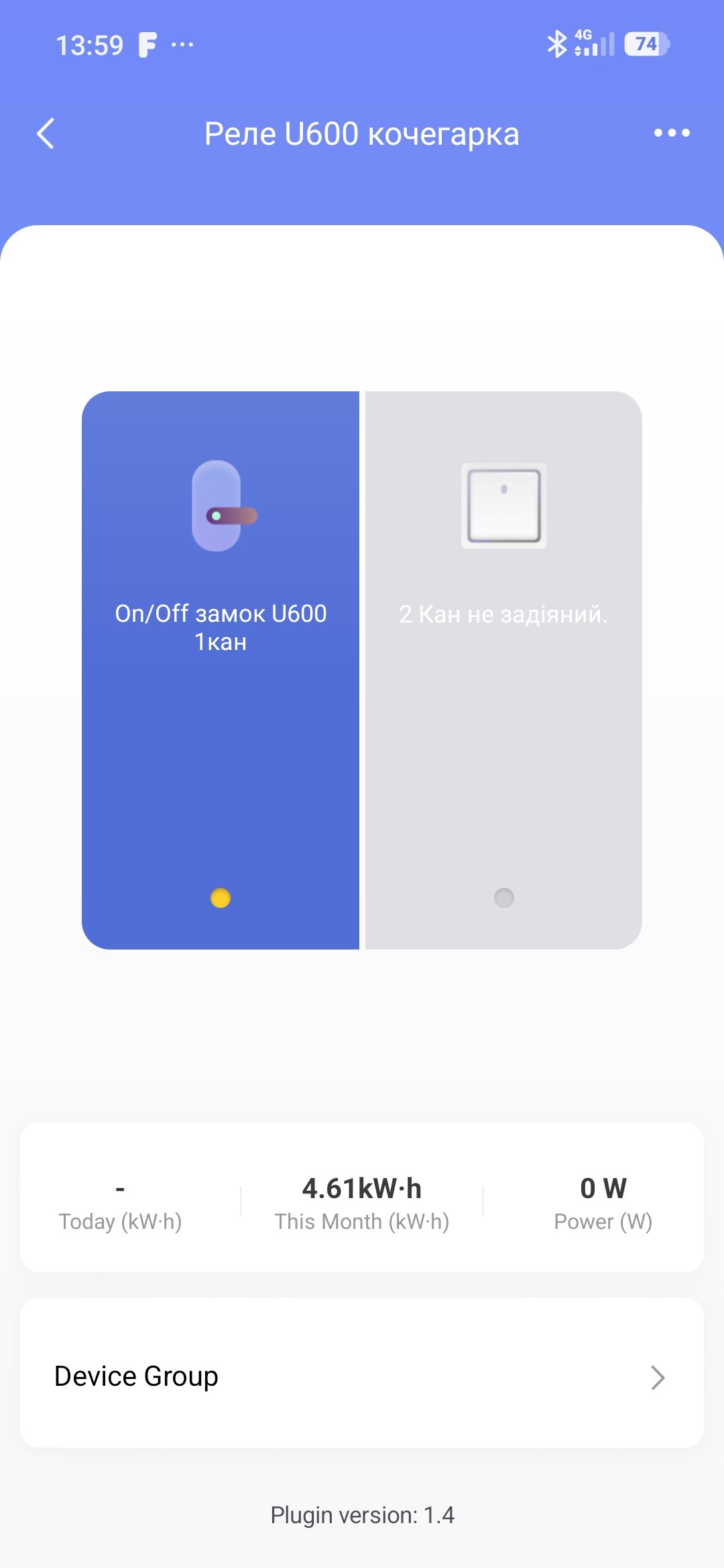

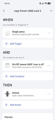

Hello, I did it without any problems in Aqara home. There are two options, a virtual switch or a physical switch that is not involved. You control the command “lock closed” or “lock open” to turn the switch (or virtual switch) On or Off, respectively. Then comes the technical part, these switches (their state) we use in the automation section IF. This is an analogue of controlling the light bulb that I described.
Lesson 3, pictures 15,16. Instead of the command for the lamp, we give a command to the lock On/Off. Automation 2.0. Lesson 3. Controlling lighting devices
By the way, @Andrei.C, why don’t you make pressing (short) the On lock and long pressing the Off lock.
Simple and fast😊
Oooh, you mean like this. Nice trick, I’ll remember this trick, thanks.
But if you don’t have a free relay channel to act as a state indicator (as in your example) then I think that my trick with the 4 automations is also ok :slight_smile:
No, I have a spare version with a virtual switch😊.
Everything is the same, only the On/Off virtual switch. Automation 2.0, lesson 12, blitz topic, VIRTUAL Aqara switch

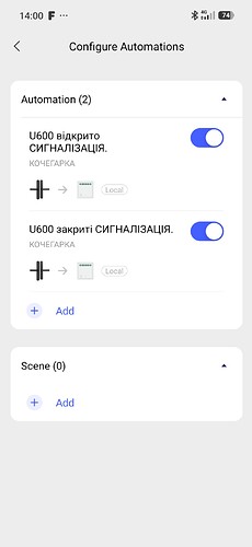

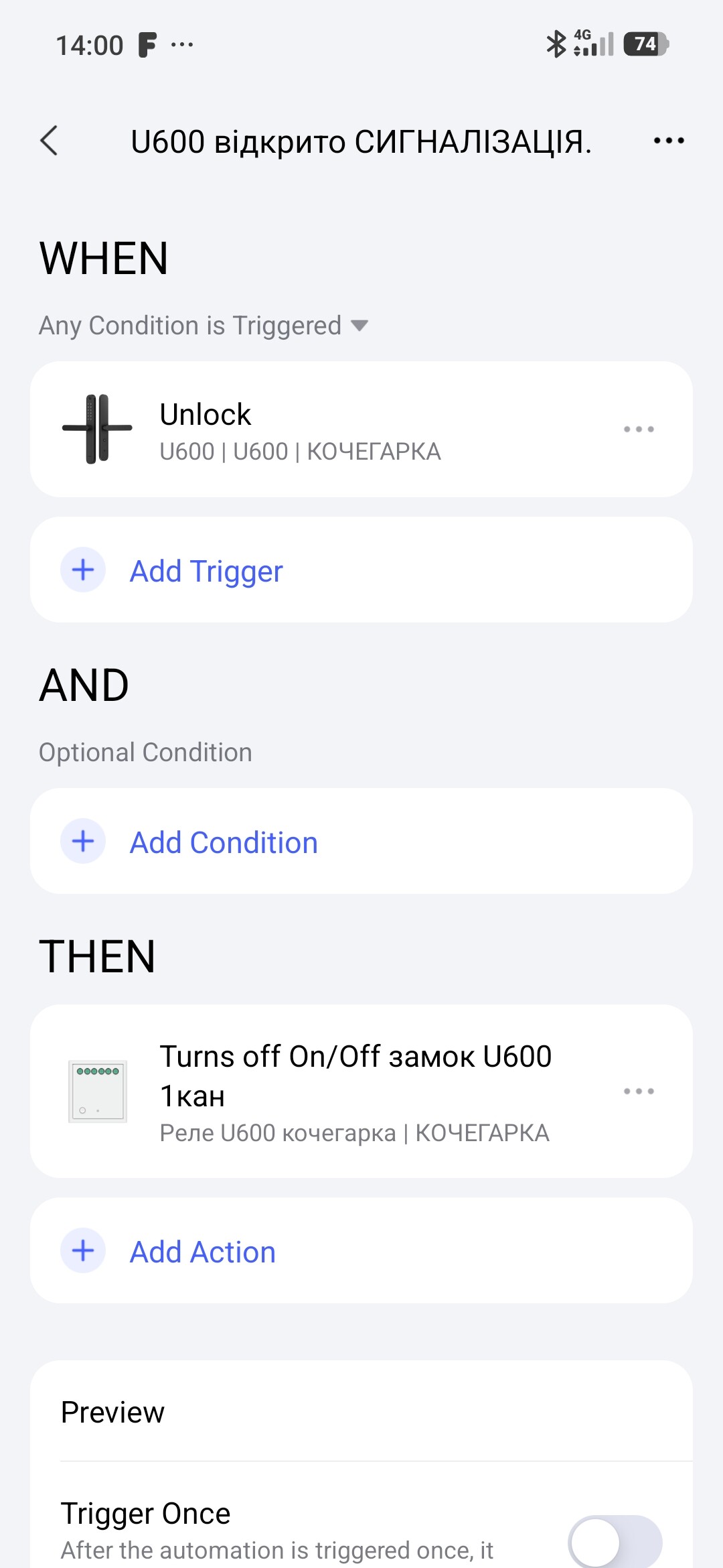

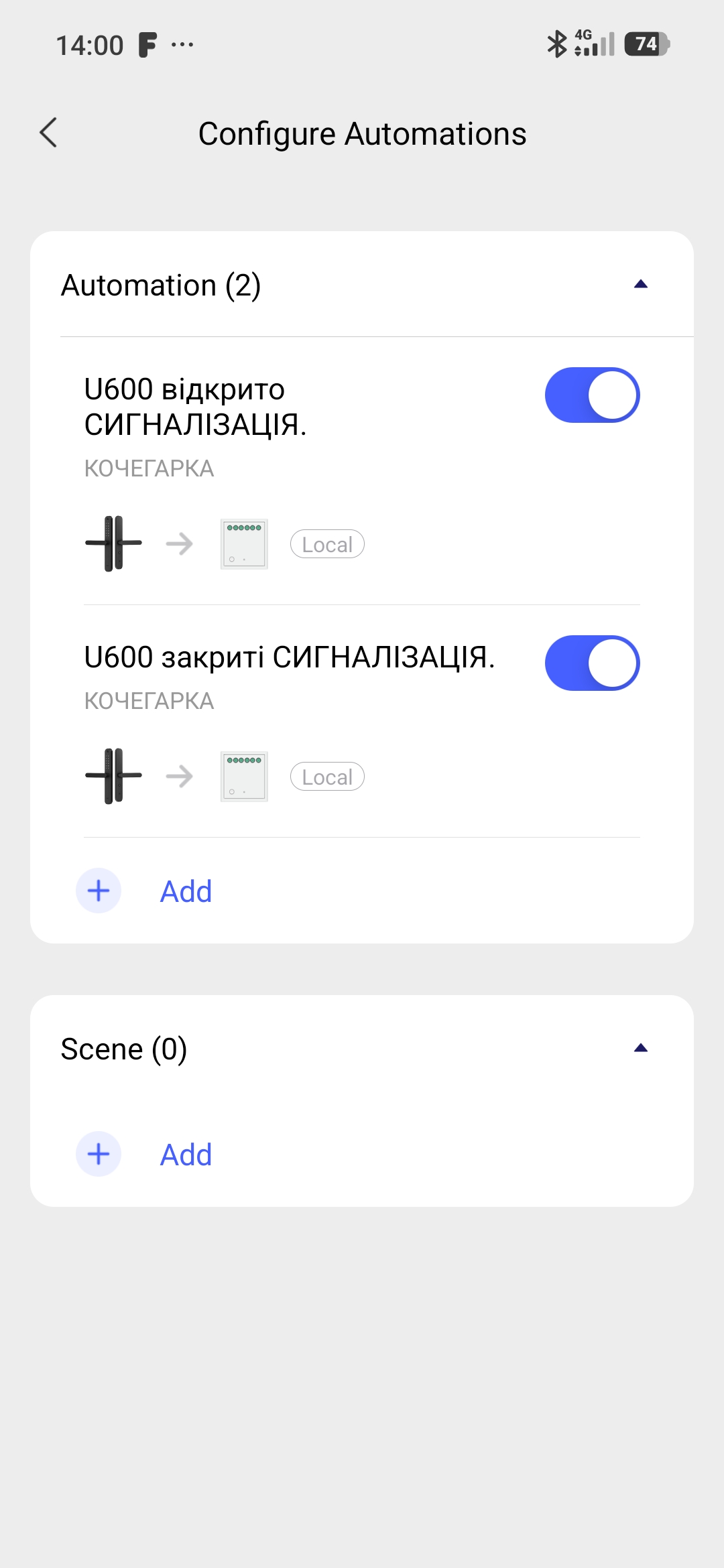

The screenshot of my working automation is a visual about the lock status On/Off. A low-current transformer (24 volts) simultaneously works for the lock and the relay on which the red signal lamp (indicator, low-current) turns on. The woman is happy, she can see visually that the door is closed🤣

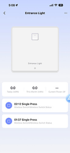

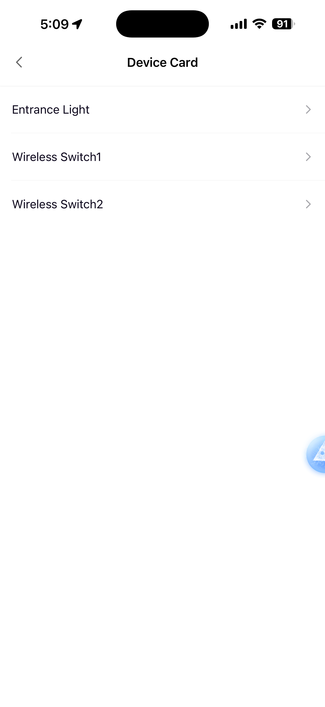

@gafich10 @cezary806 I have this Aqara Light Switch H2 EU, 2 buttons, 1 channel, the upper part is used for the entrance light on/off, and I intend to use the lower part, as wireless switch to make the door lock/unlock. I do not have NEUTRAL LINE.
