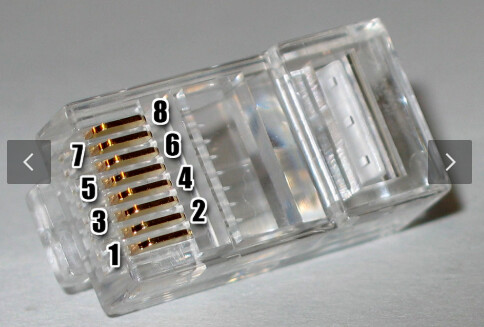

A LAN connector (RJ45) has 8 wires (4 wire pairs).
This means that it is not possible to enable an internet or network connection via the power supply.
