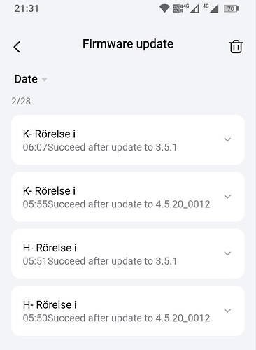

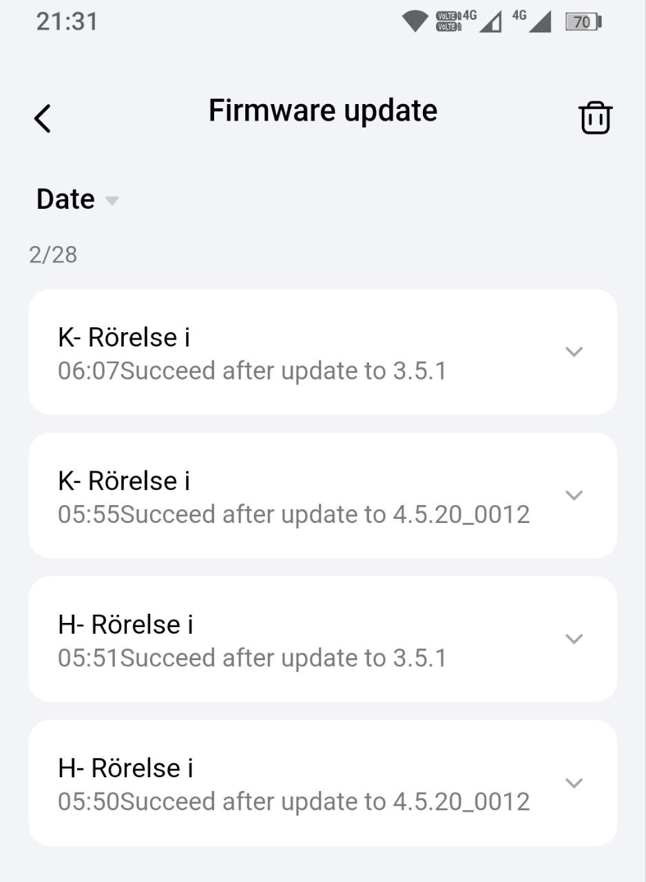

I have been in contact with the official customer service at [support@aqara.com]. And provided detailed instructions and a video, I reproduced the error. A few days later, I was contacted by customer service, who said that they had now been able to reproduce the same error themselves. They said this would be fixed in the next update. And that is good, because I assume that thousands—if not hundreds of thousands—now have the same error and problems after updating to the latest firmware for E1 camras.
HOWEVER! Customer service said they would send me an older version of the firmware, because the current harmful firmware is damaging my cameras, which over time will break. This was never done. I have now been waiting for months for this downgrade, which up to now has NOT arrived. I therefore want to ask you to release a downgrade firmware immediately, before my cameras break—damage you will not compensate me for.

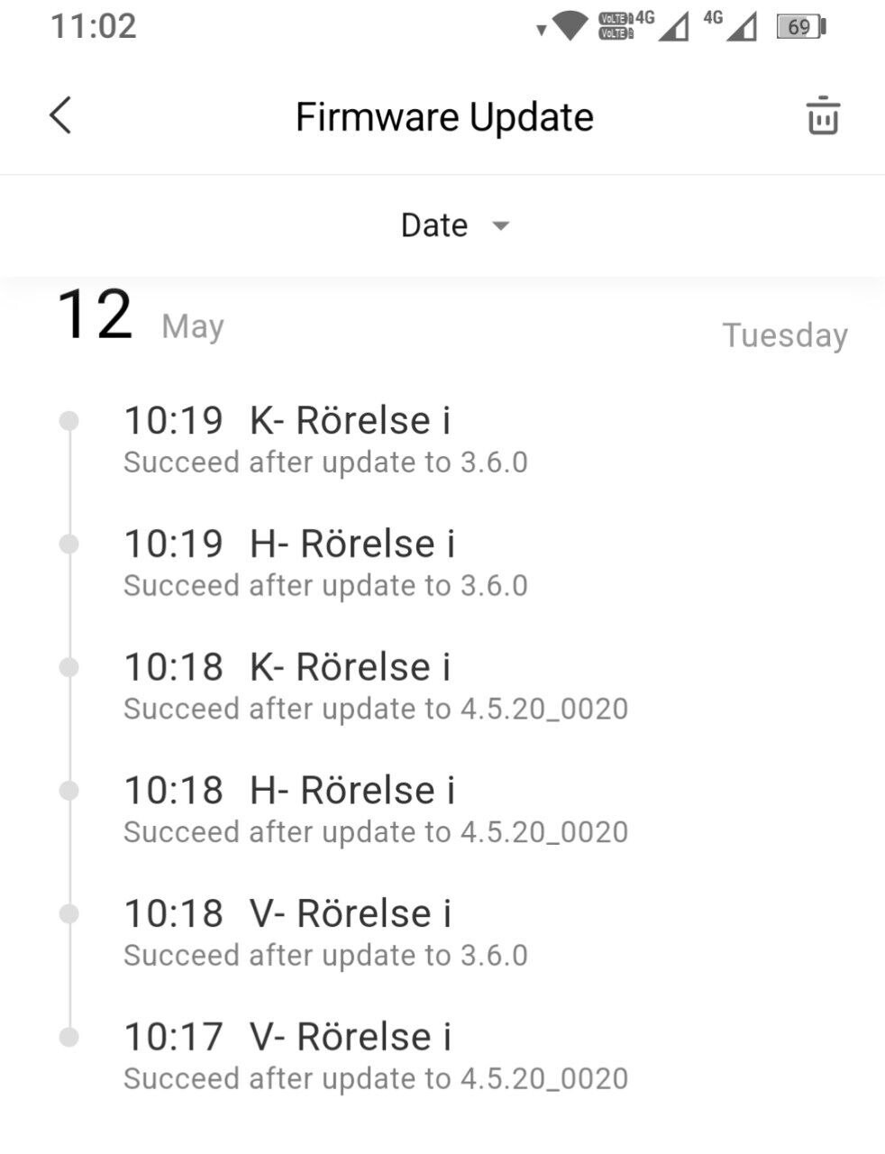

I have now updated to the brand new firmware 3.6.0 for the Aqara E1 camera.
After the firmware update, the IR-cut filter issue is still not fixed. The cut filter is still being moved with excessive force, causing it to slam into position, producing a loud clicking sound, and damaging the camera.
