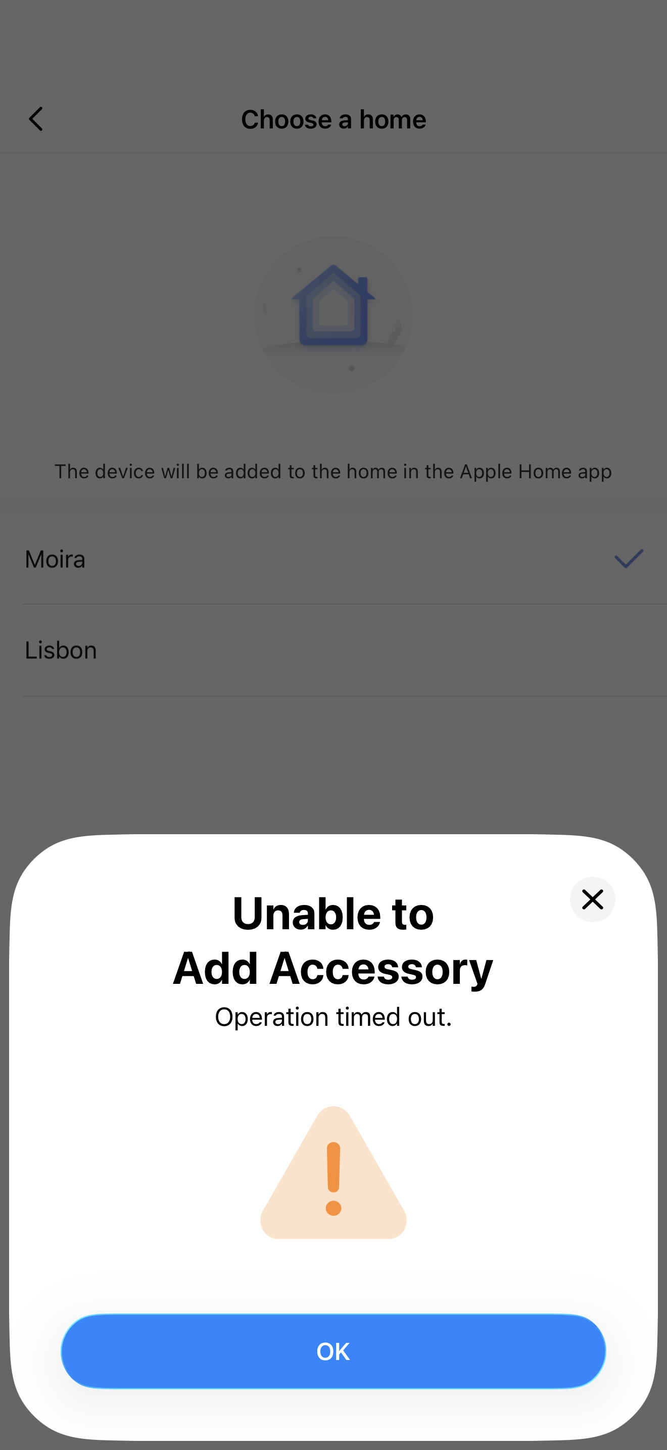

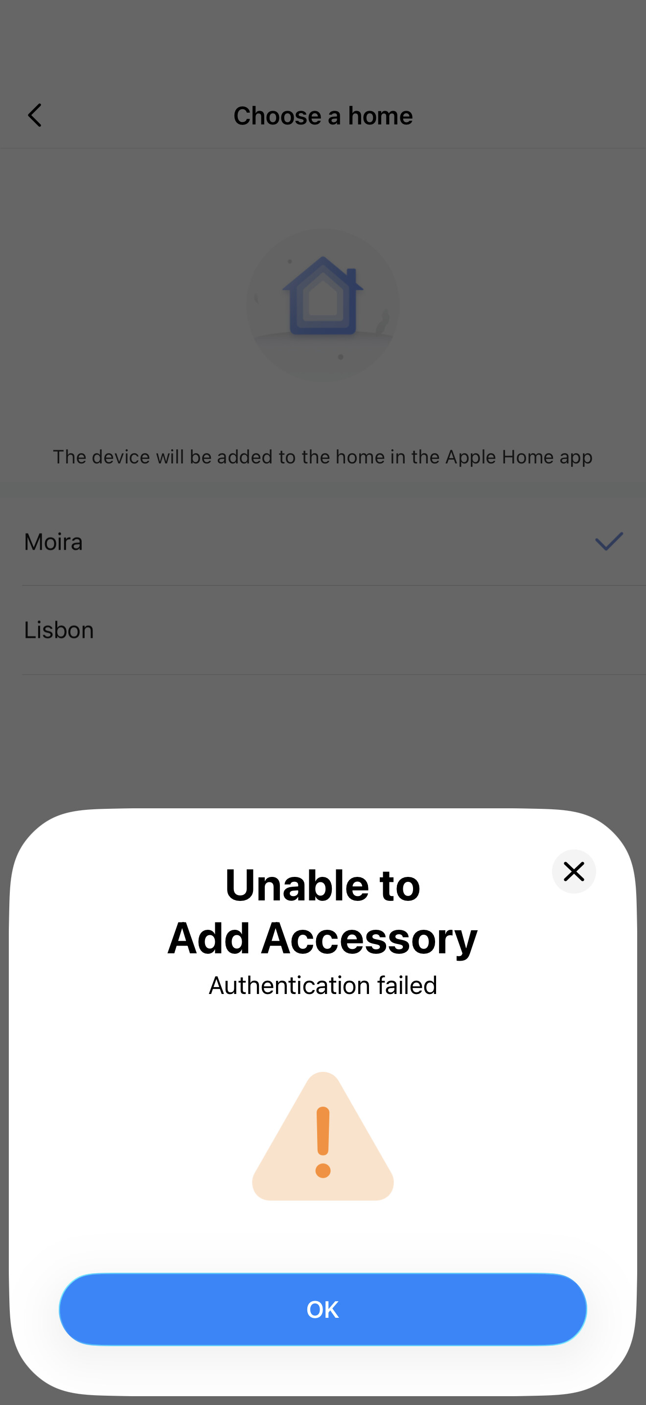

I’ve had this Aqara E1 hub for a couple of years. Recently I had to re-pair the Temp sensor to it after changing batteries on it, but it just would let it. So I reset the hub, by pressing the button for 10 seconds. Now it just won’t connect to the WiFi at all. I have tried two different Wifi networks, one specifically for IoT at 2.4Ghz. I have reset and tried three times, but I just keep getting Unable To Add: Accessory Operation Timed Out, or Authentication Failed. The app never discovers the hub either. I have to add it manually and scan the QR code on the device. The hub is few feet away from the router, so signal strength is not a problem.

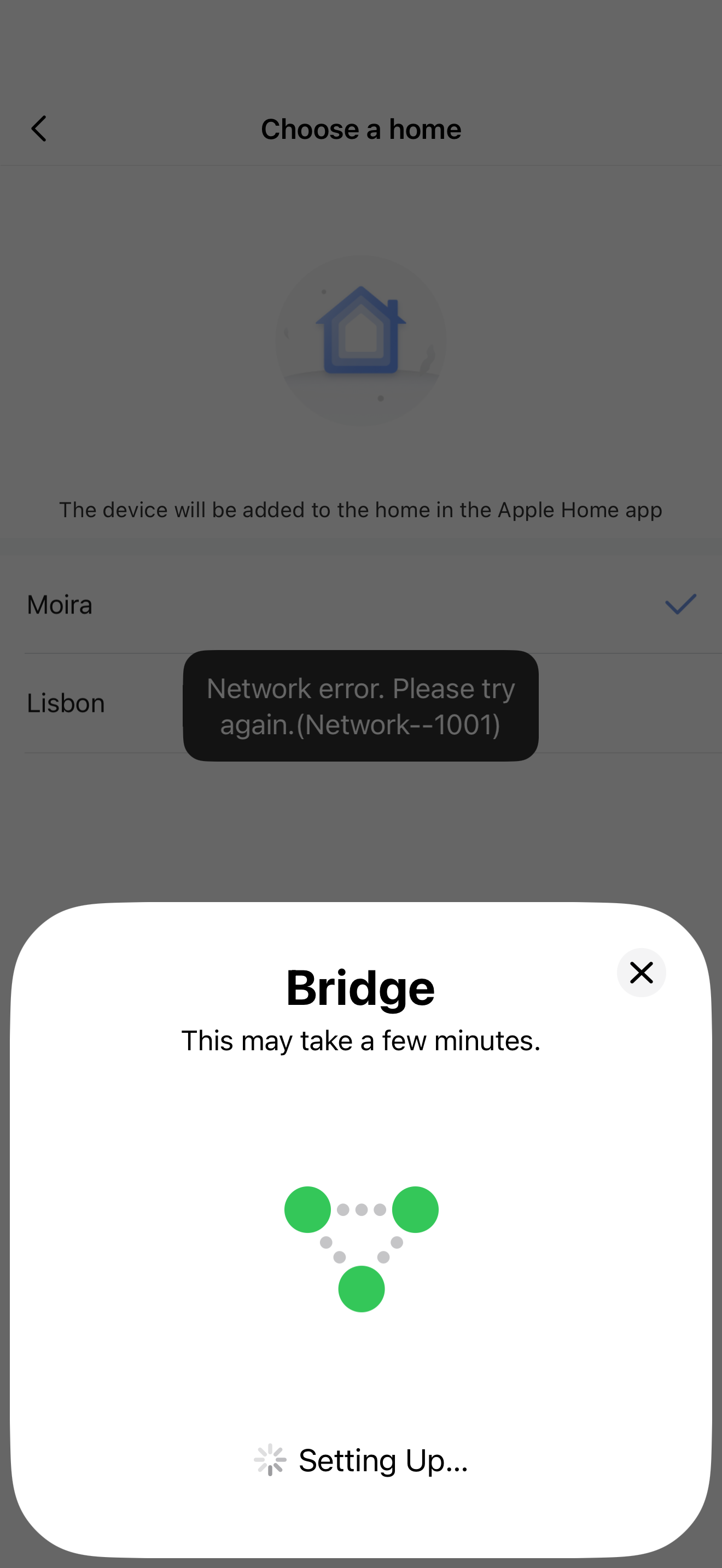

@DEChrisE Thanks for the reply. Do you mean Wifi router/SSID? I tried first with the same network it was on. It didn’t connect (see first failure screenshot). Then reset it (yes, the 10 sec trick) and tried again with a new SSID (I have TP-Link mesh routers) setup only for IoT devices. Second failure. Both times I saw that “Network error” popup (black, 1st screenshot). I’ve tried the reset option (10 sec+ to reset network) twice or maybe three times. Unable to Add Accessory is what I keep getting.
