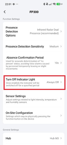

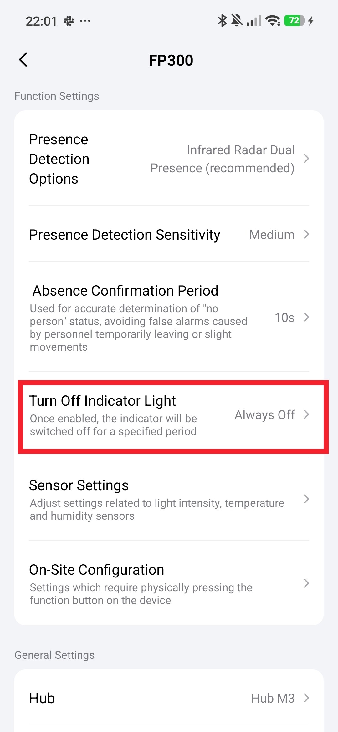

This is an LED indicator that, once turned on, will blink while driving. Again, this is just an indicator of sensor operation, it does not play any role other than visualizing the sensor operation.
Okay, this is a feature available when using an Aqara hub, but it’s not available in the Zigbee2MQTT version, so the option to disable the LED at night for Z2M users is useless. Thanks for the explanation :slight_smile: I was racking my brains trying to figure out what that meant.

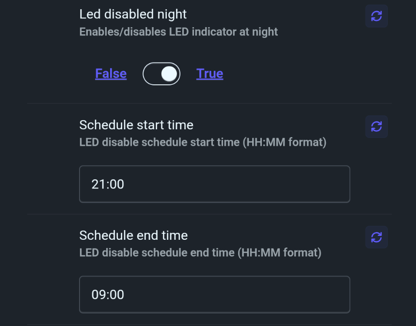

You can disable the LED in Zigbee2MQTT according to a set schedule. Enable the toggle and set the time scheduled for the disable, as shown in the screenshot. The device may need to be woken up with a button press before the settings will get written. I don’t think there was an always off option when the Z2M converter was originally written.
