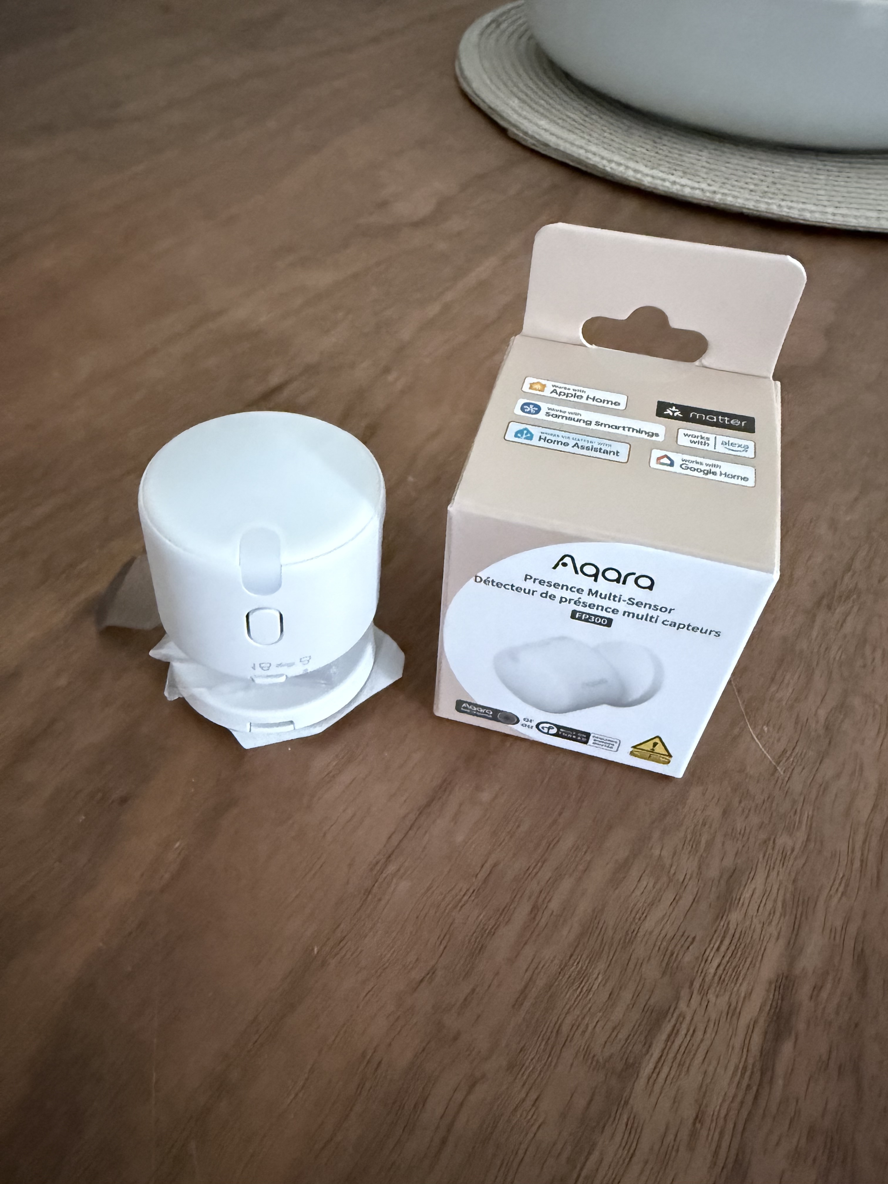

So, the FP300 arrived yesterday and I’ve installed it via Matter in the main bedroom.
Obviously early days in testing but initial impressions and observations:
Pros:
  • Smaller unit than expected. (Approx 5 x 4 cms)
  • Battery as opposed to mains power so can be placed in areas with no socket. (Note: See first con below)
Cons:
  • Expected USB charging but it uses replaceable CR battery instead
  • No manual/instructions available which would have been helpful for pre-release to aid testing

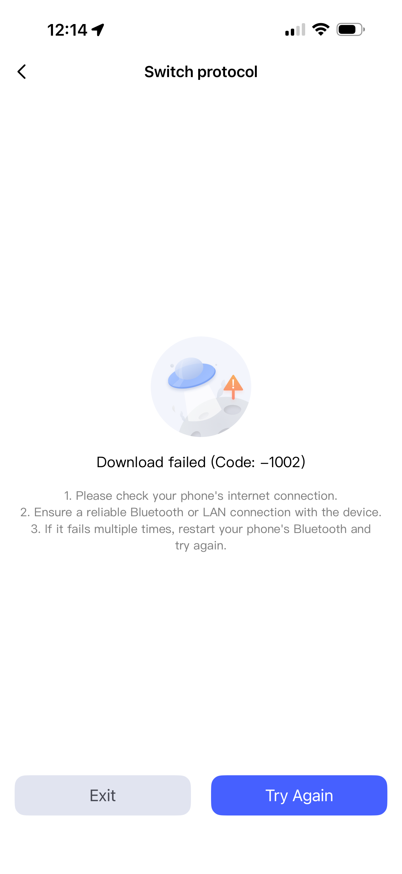

  • Errors received when trying to install using Zigbee (not sure if this is only because I initially installed using Matter)
  • Unsure of field of detection. Up to now the FP2 had a wider field of detection I think.
  • Can take quite a few seconds to identify presence. I encountered delays of around 4-5 seconds before the app picked me up. This was on all sensitivity settings.
  • Installs as a motion sensor, not presence sensor.
  • App just shows text to identify “Absence” or “Presence”. No room map to identify zones or where people are within a room like with the FP2. (This may be because of being installed via Matter instead of Zigbee but as it won’t let me change to Zigbee I don’t know)

It would be good if someone from Aqara could help us out with a manual and how to overcome the issue with the error (see image below) when trying to swap install from Matter to Zigbee.

You can only change the protocol if you remove the device an re-pair it. Do this in the Aqara app and it will guide you to choose protcols. It will need to download the alternate firmware, so make sure your connection is good as the error message indicates.

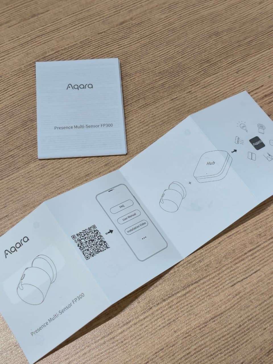

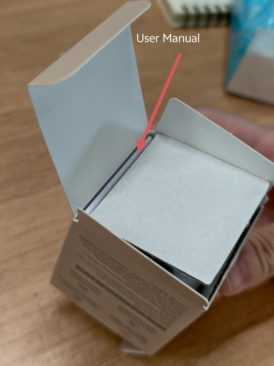

Hello, the user manual is on the edge of the box. Please take a look. There is a QR code inside to view the electronic instruction manual in multiple languages.

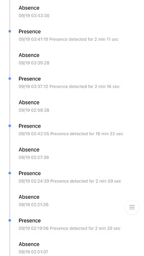

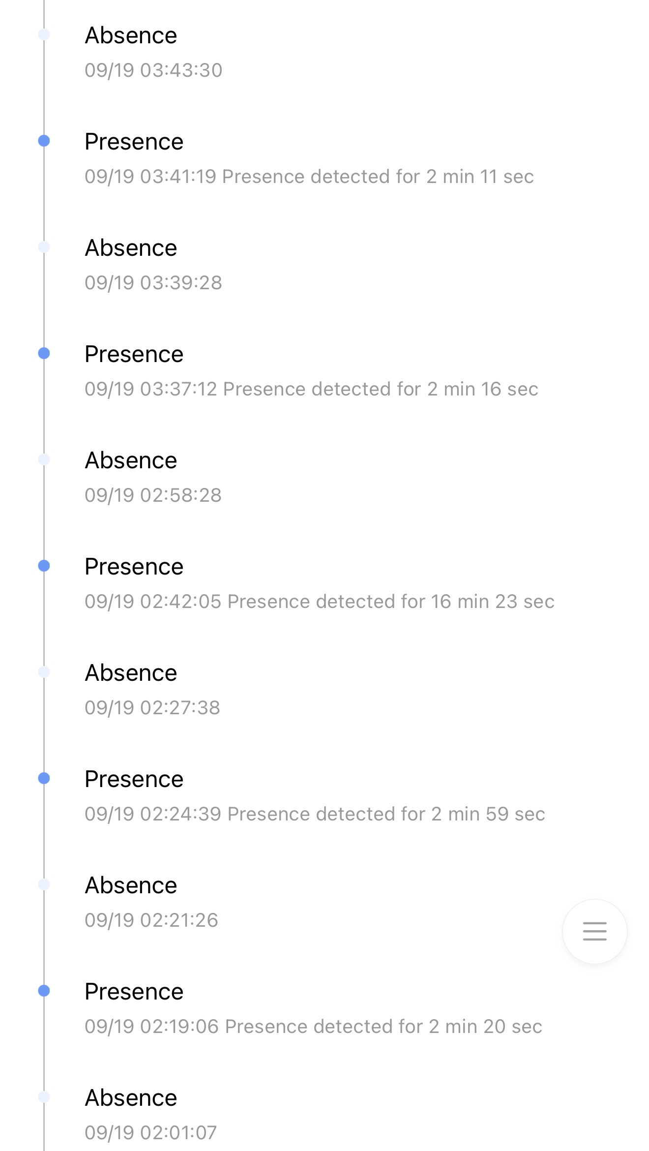

After having been installed for a few days, and quite a lot of changes to sensitivity to try and tune it as best as possible for the environment and many AI Spatial Learning ‘lessons’ on the device (available via the app) I have seen an improvement in presence detection when simply walking in/out of the room. However, as I originally stated, this FP300 has been placed in my main bedroom and I have found it constantly drops presence detection when we are in bed sleeping.
Below is an excerpt from last night’s log and, as you can see, in the middle of the night, with two of us in bed, it recorded a lot more absence than presence. In the roughly 90 minutes recorded in the log excerpt below it only records approximately 26 minutes presence. Dual Presence detection is turned on which should give the best accuracy and High sensitivity.
Hopefully this will be ironed out in a future firmware update but, as it is I can only currently use it as a motion sensor rather than its intended purpose as a presence sensor.
