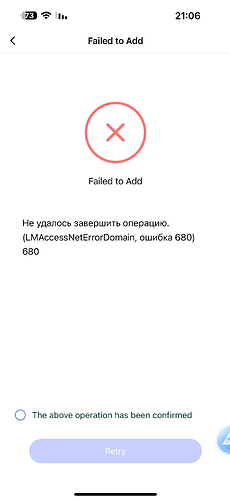

Aqara G3 не могу подключить
Не могу подключить камеру

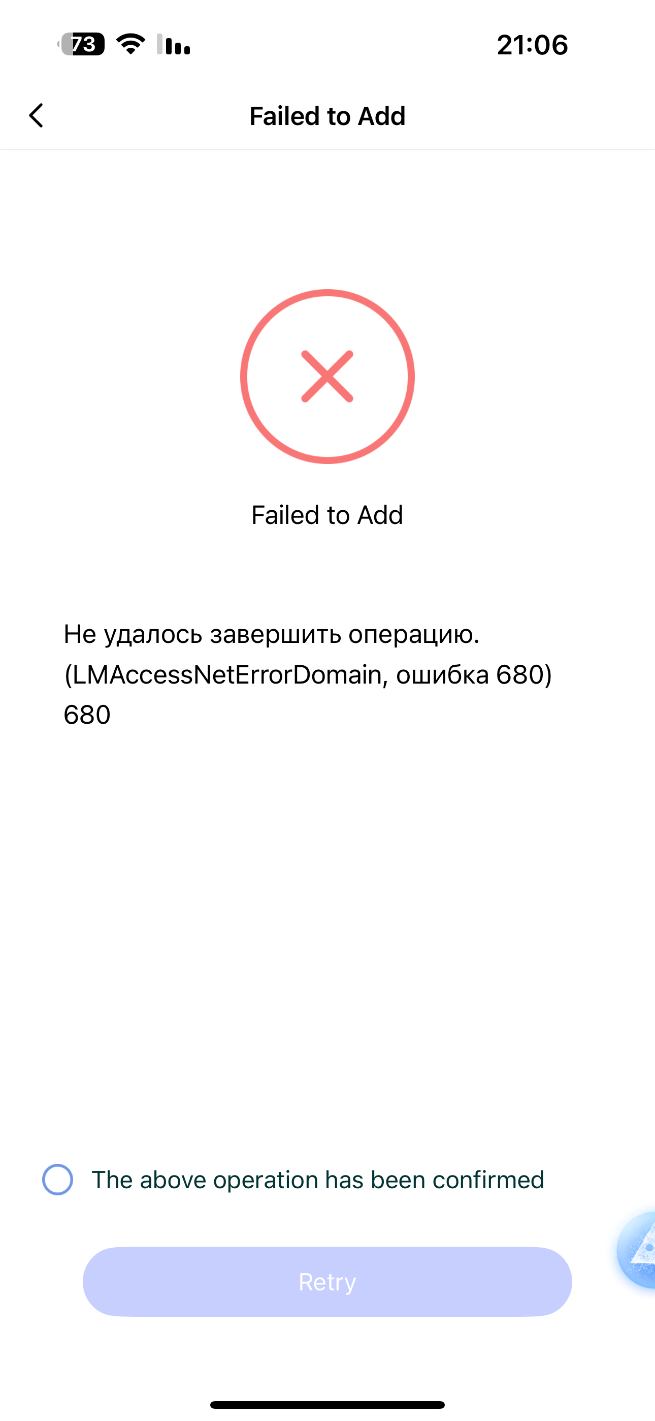

Проработала 1 час и потребовала пере подключение
Теперь выдает такую вот ошибку
Hello @kirilltsukerman
If you’re getting “(LMAccessNetErrorDomain error 680)” when trying to add your Aqara device, especially a G3 Camera Hub, here’s the truth: The device is still bound to a deleted or inaccessible Aqara account, and the cloud won’t let you rebind it, even if you’re the current owner.
Error 680 isn’t officially documented by Aqara, but from experience and reverse analysis:
It means network access to the Aqara cloud failed during device registration, likely due to one of the following:
• The device is already bound to an old account
• The account used has been deleted but still holds the device ID
• There’s no way to auto-unbind the device, even if the old account is gone.
thank you but the camera worked for a day and then it stopped and this problem started how can I unlink it?
Please provide your homekit code of the G3, the developer will help you to solve the issue
