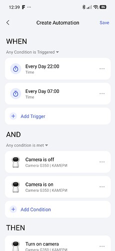

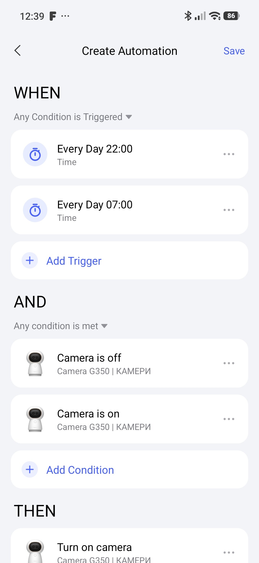

The automation option is to create such automation. Fig. 1 .

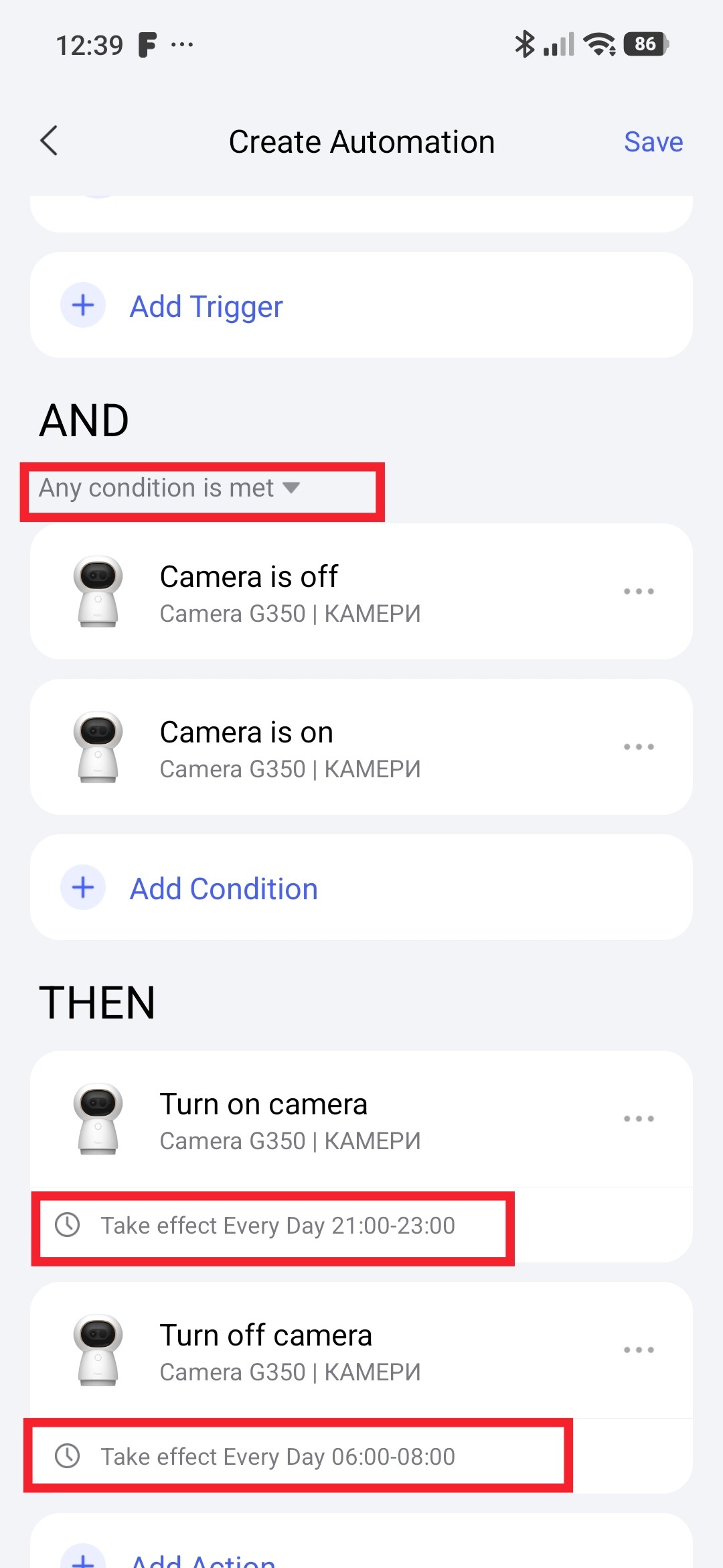

This is just one of the options I have proposed for night recording of the camera. Be sure to select the parameters that I have marked in red.

I’m following your example but I don’t see the “ take effect every day at a certain time”
So does mean every day at 22:00 if the camera off then turn it on.
And every day at 7:00 if it’s on then turn it off.
Will this example record motion / people between 22:00 - 7:00
Yes, the recording will be done if you choose the settings I recommended in the first answer.

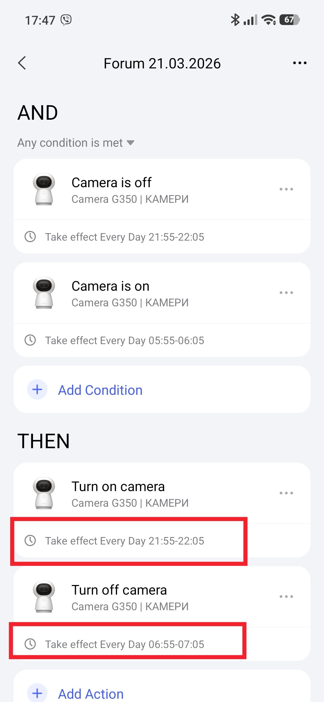

Ok, you mean following your screenshots, but I don’t see this appear in the red box, and the time ranges are different to 22:00 and 7:00

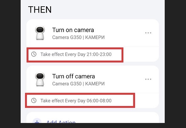

These parameters are set only in automation. I made you a universal On/Off automation. Most users don’t even know that you can do this. And the time you ask is in the IF condition, just to combine two automations into one😊
You came home, turned off the camera.
The time came 22.00 - the camera (time range 21.00-23.00) turned on.
The morning came (time range 06.00-07.00) - the camera turned off.
I just chose an arbitrary range so that it fell between 22.00 and 07.00
I don’t see an IF condition in automations, only WHEN, AND, THEN.

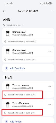

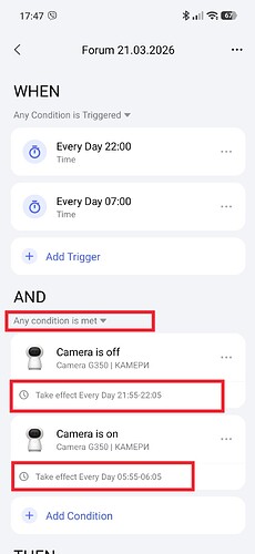

I have improved the automation so that the camera On/Off mode works in any case. To avoid confusion, I have reduced the range for the cameras so that you understand the principle of automation.
Thanks for tweaking it, sorry for all the questions but why would the camera be off, mine is on all the time. And why the take effect time ranges.
I see now the time ranges come from the 3 dots on the right hand side.

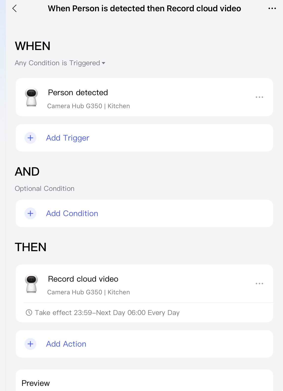

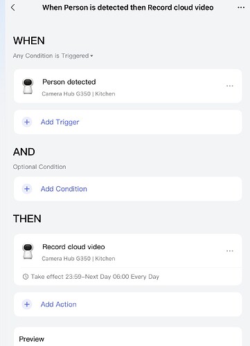

So I have made an automation by asking Gemini, and done this, probably wrong I know, the only thing is there is no record to sd card option only to the cloud, so as I have the cloud turned off I’m not sure if it will default to sd card.
Why turn off the cloud? It provides you with event recording for at least 24 hours. Select the events that should be recorded in the cloud in the settings that I showed you.

I don’t want to save anything to the cloud, I prefer to use the local storage option.
It’s only a trail period then there is a cost per month which I don’t want to subscribe to.
As such, not everything is stored in the cloud, only events are stored in the cloud, you set the length of the event yourself. Believe me, it is very, very convenient.
The permanent period allows storage for one day, this is completely for quick viewing. Everything else can be viewed on the SD card.
Yes that’s the thing, I don’t want to record all the time to the sd card, only during motion at night, or when I set the security guard to away mode when I go out.
Does not seem straight forward unfortunately, or even possible to achieve.

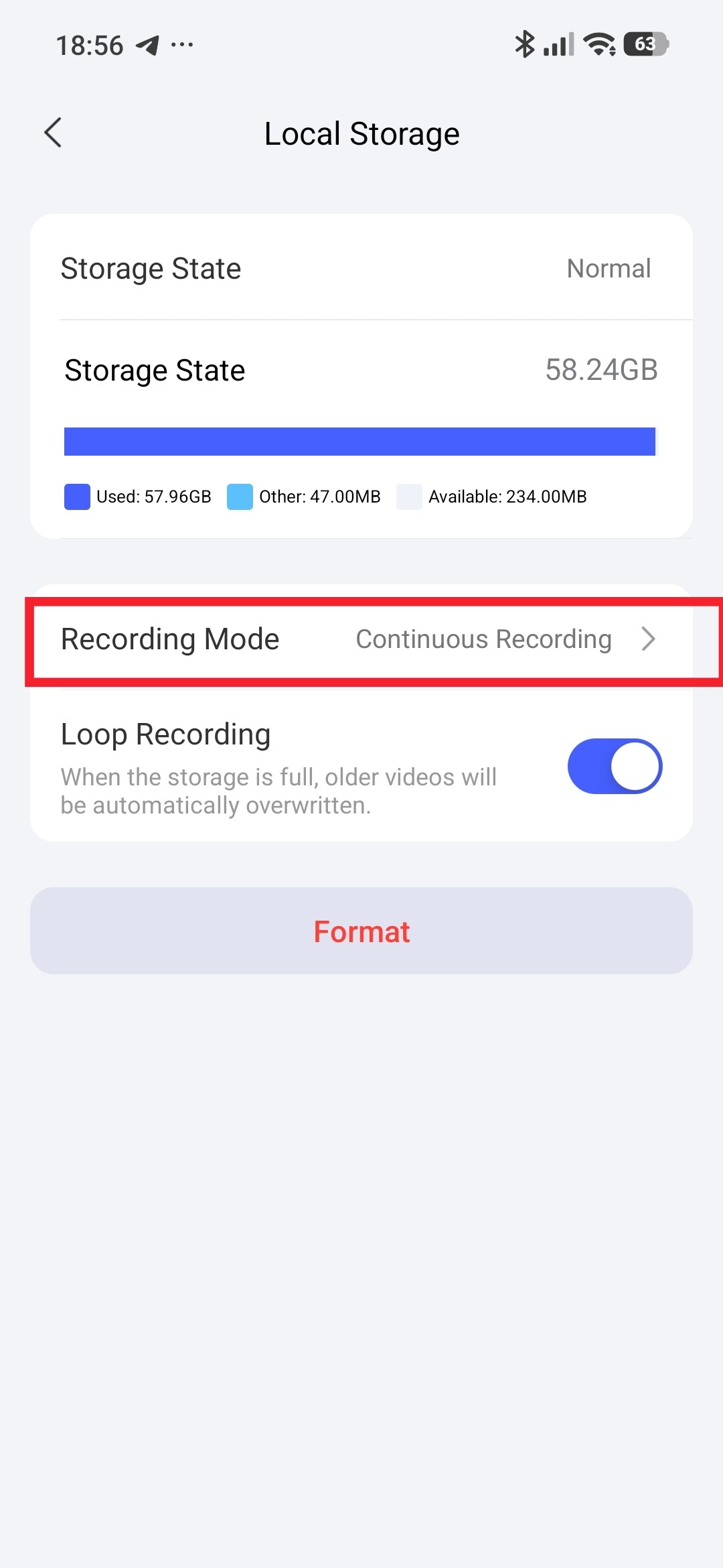

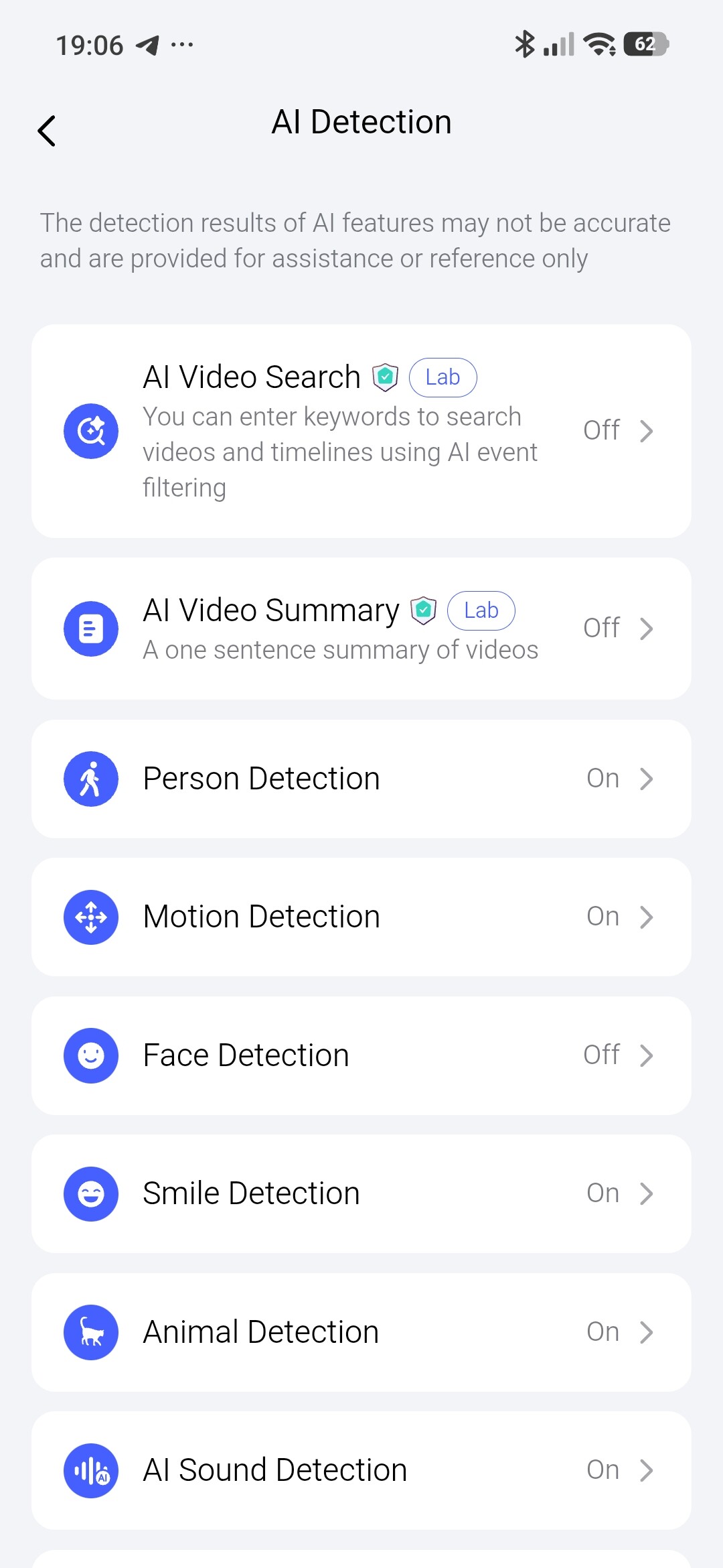

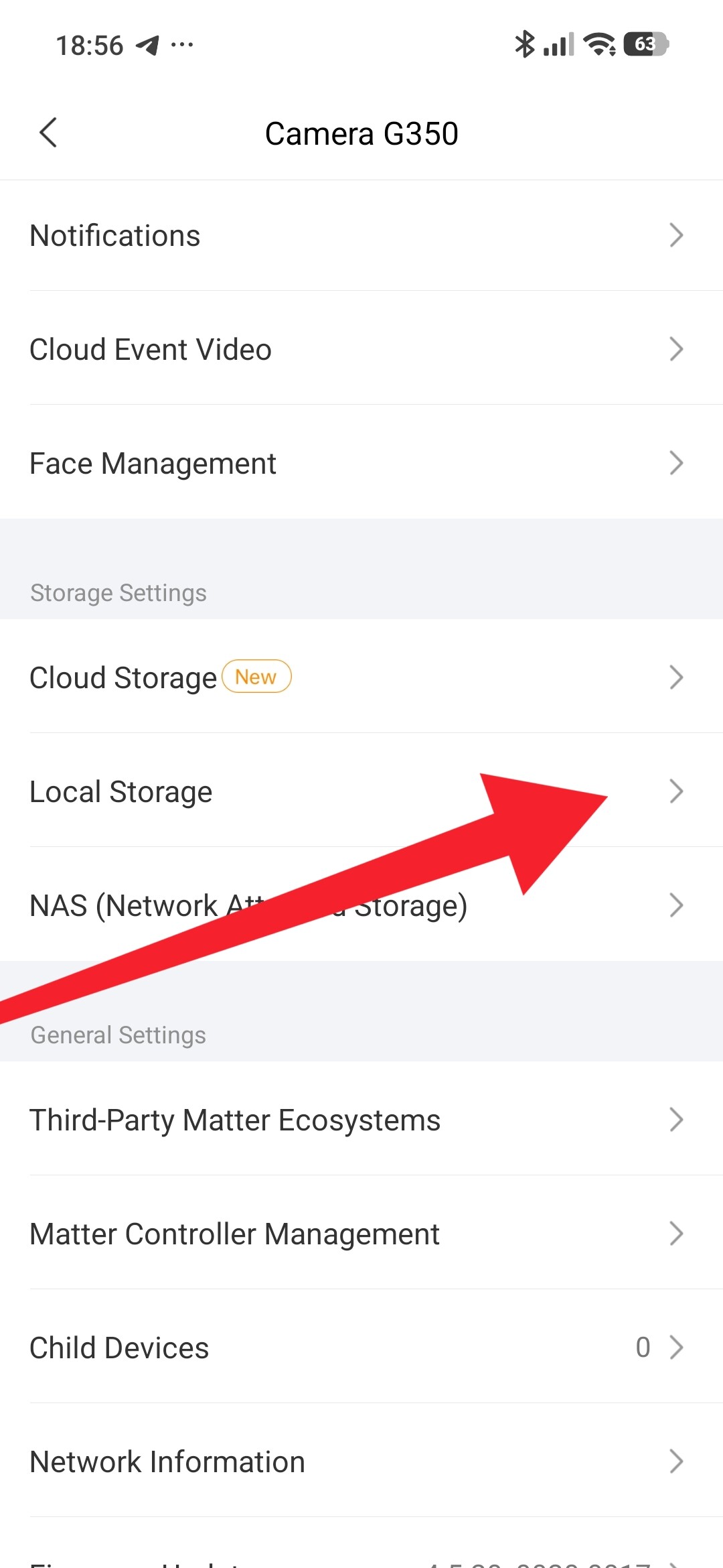

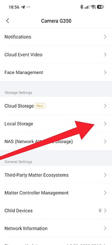

You can select this option here.
For your information, this setting is valid not only for cloud but also for local storage.

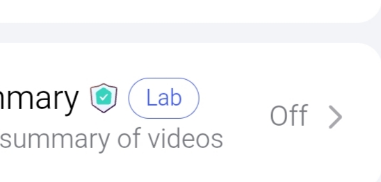

Just so you understand, only those services with a shield are paid.

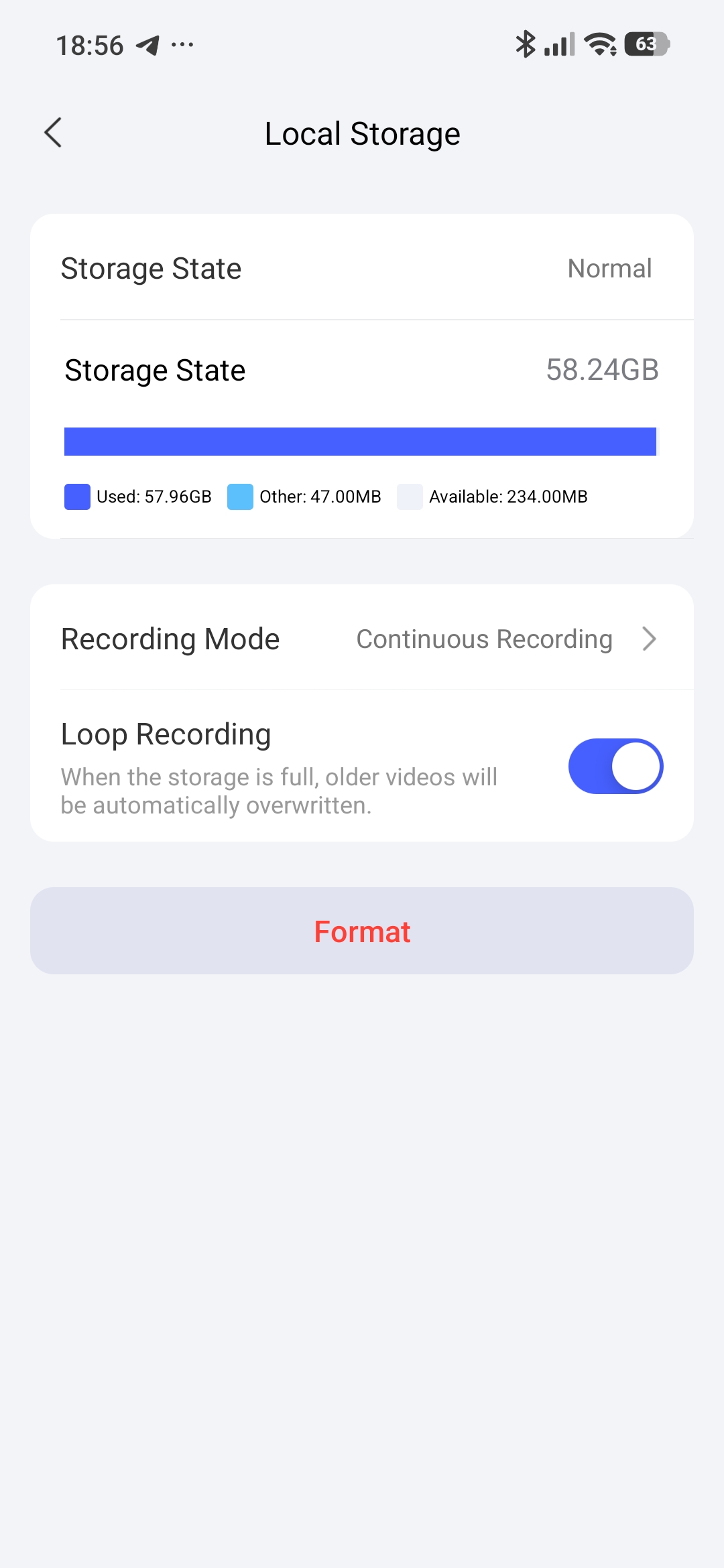

I tried that when I got the camera but the camera is always recording to the local storage so would fill up in no time, I know it can overwrite but still it records continuously, I don’t want it recording when I’m home pottering about.
