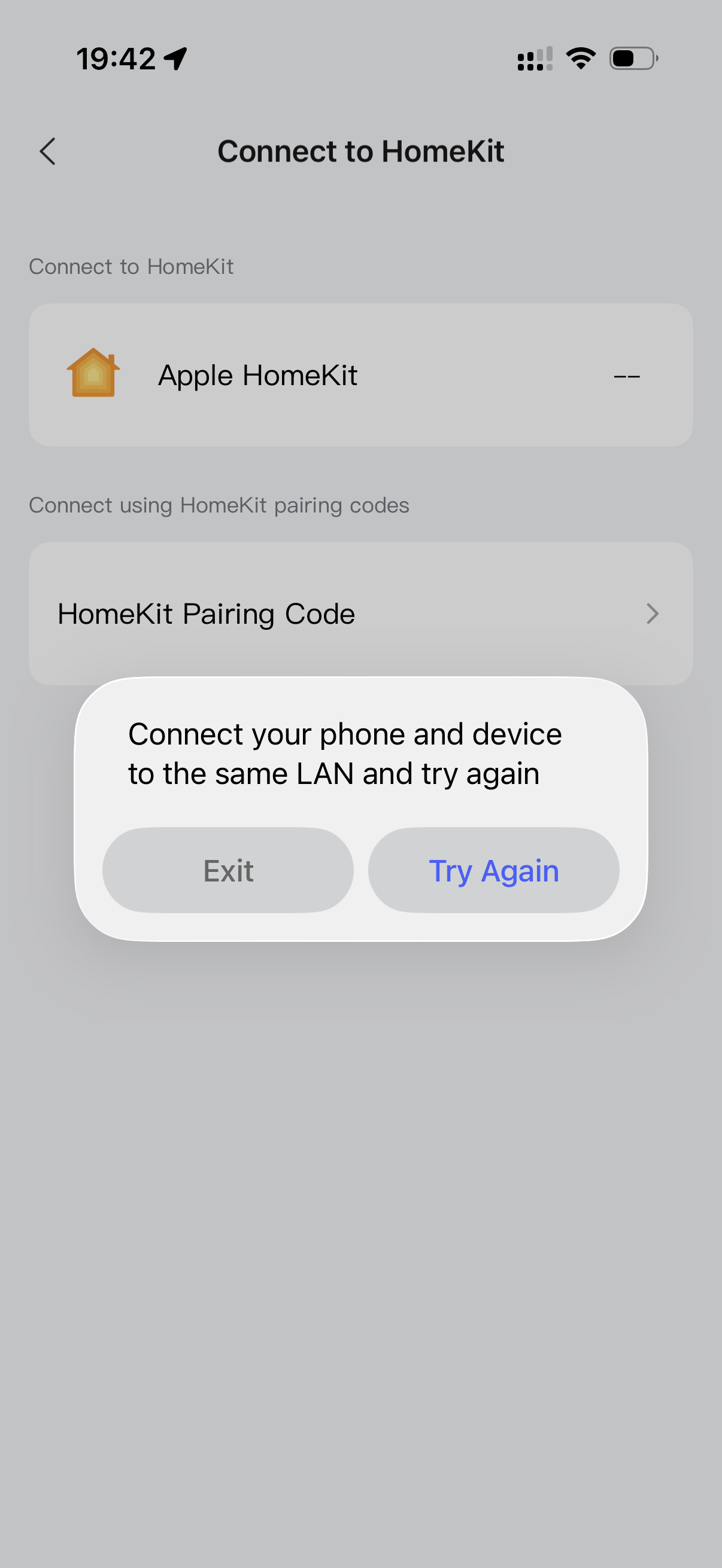

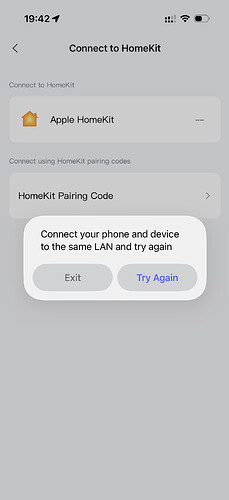

Aqara G400 - can’t add to HomeKit
After switching to a new transformer, the Aqara G400 is now working without rebooting all the time, as intended, however it is still not possible to connect it to HomeKit.
Aqara implies the device is not on the same LAN, but it is. We have one router and two extenders via PoE sharing the same WiFi name and password. My home network is working fine. Other HomeKit devices can be added without trouble.

Any screenshots or more details when you are attempting to add to HomeKit?
What does it say exactly when trying to add?
Does it fail immediately?

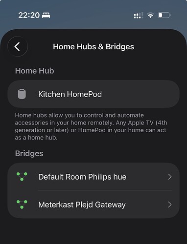

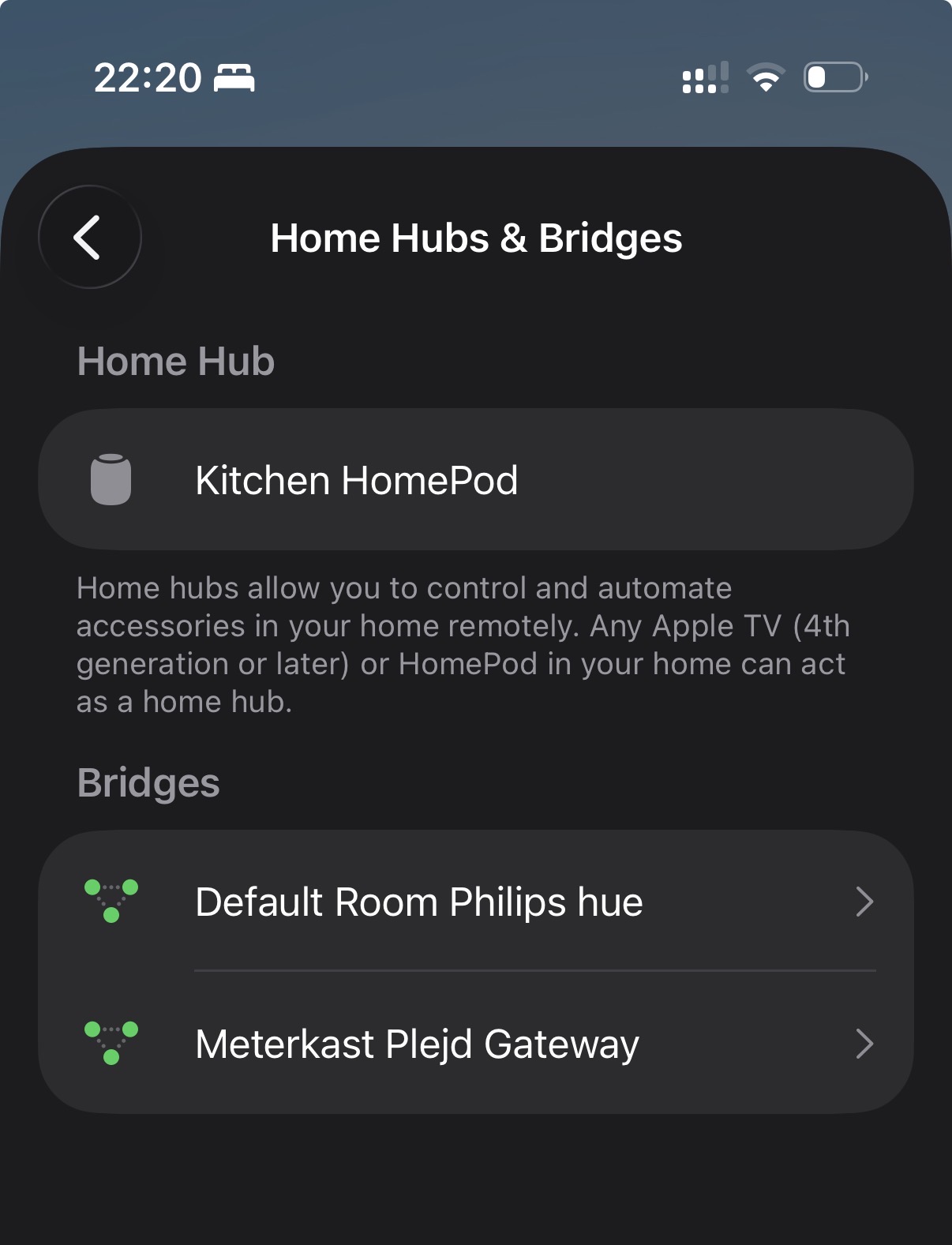

Do you have Apple home set to auto select a primary hub or manual? What is your primary home hub? I’ve have best success with Ethernet wired Apple TV, worst experience with HomePods as primary.

My setup:
HomeKit on newest architecture and 26.4
HomePod 1st gen
Router: Fritzbox 5690 Pro
I have reset the HomePod, Philips Hue bridge (probably unrelated) and Router several times, without resolve.
The reason why I don’t have Apple TV is that all the features I need are in my smart TV. But I realize it may not lead to the best situation regarding Matter or Thread. I want to buy a new HomePod if Apple hurries with something new. Do you think the HomePod is the culprit?

Is your G400 on that extender wifi? It sounds like it is, I bet the HomePod is on the main wifi. Apple is detecting that and that is reason for that Apple message.
Btw, that is not Aqara pop-up message, that seems like an Apple Home pop-up message.
