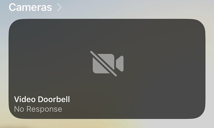

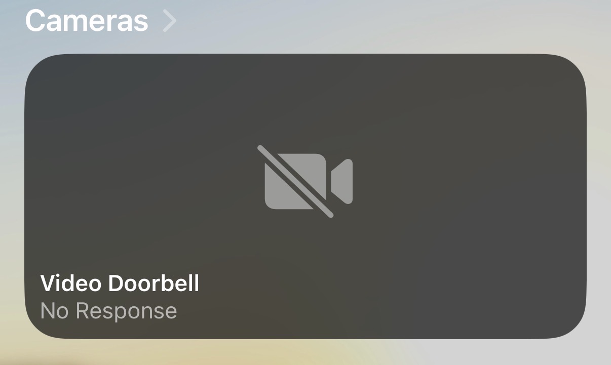

Unfortunately it rarely shows up on Home, but mostly claims there is No Response.

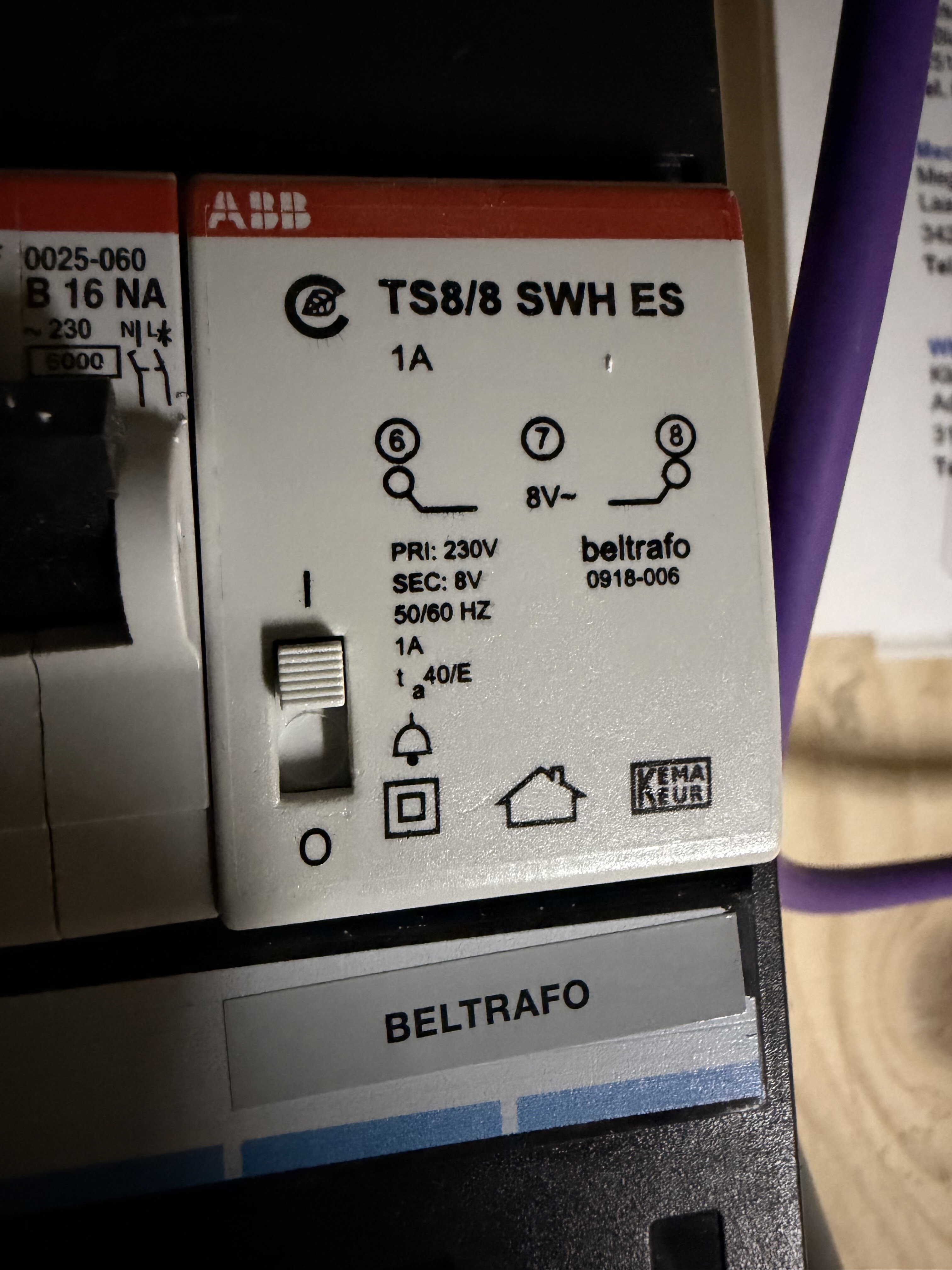

Thanks! It’s powered by a Dutch standard: 8 volt / 1 ampere.

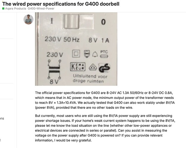

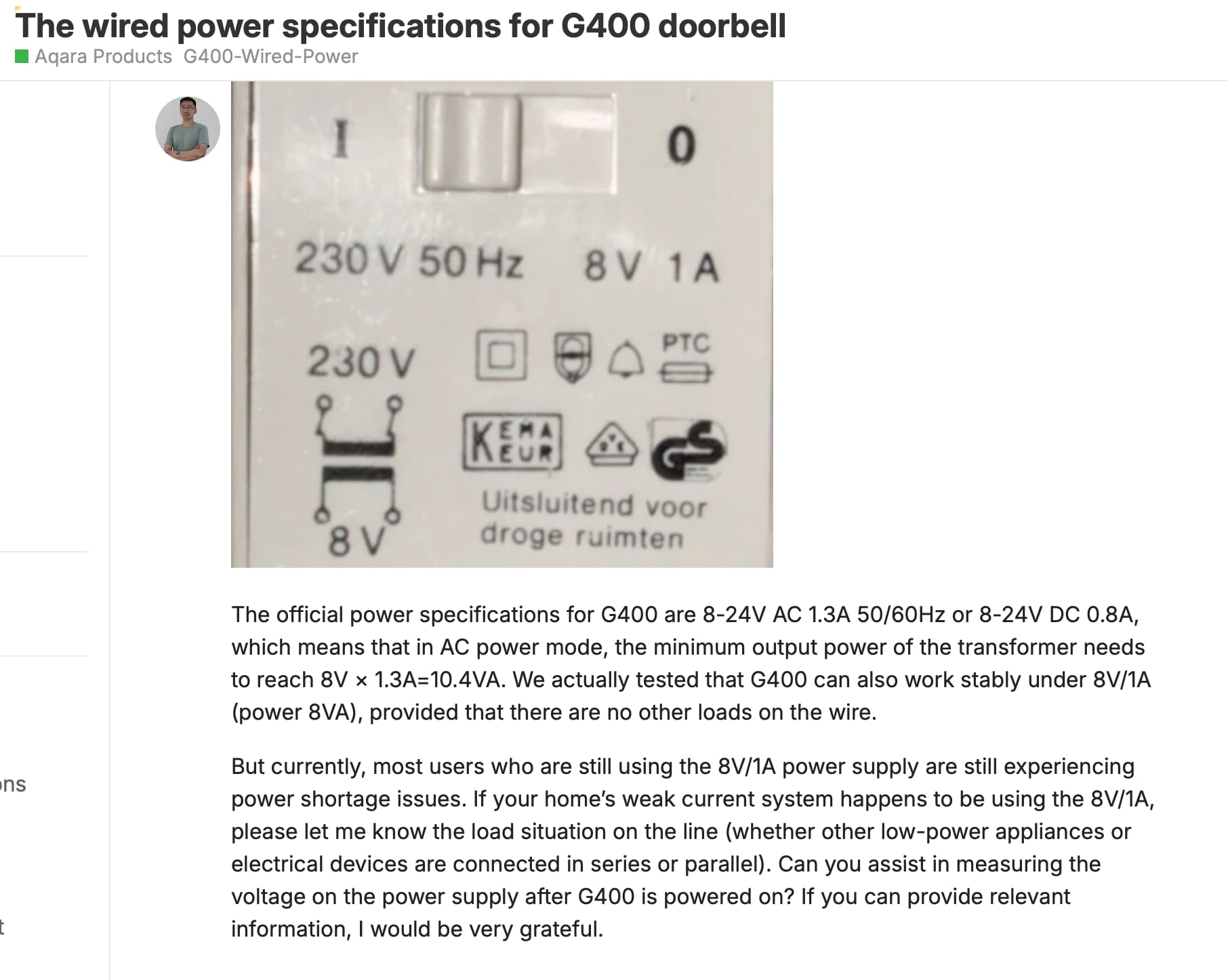

Hi @info1333 , please take a look at this post the other day by DONIE an Aqara PM, he talks about power specifications and that was my issue. Seems he says yours is too low too but please read and confirm for yourself. URL to post here →
Thanks! It’s 8V / 1a. Mine is integrated in the overall house circuits.
The product asks for:
8-24V AC, 1.3A 50/60Hz or 8-24V DC, 0.8A
Is 1a too little?
hi @info1333, unfortunately that is what Donie, the PM from Aqara is saying in that post I linked above. .1a is too low :(, need at least 1.3a. see screenshot of where he speaks about it below, dont feel bad, I had to replace mine too, and it was just 0.5a :(.
