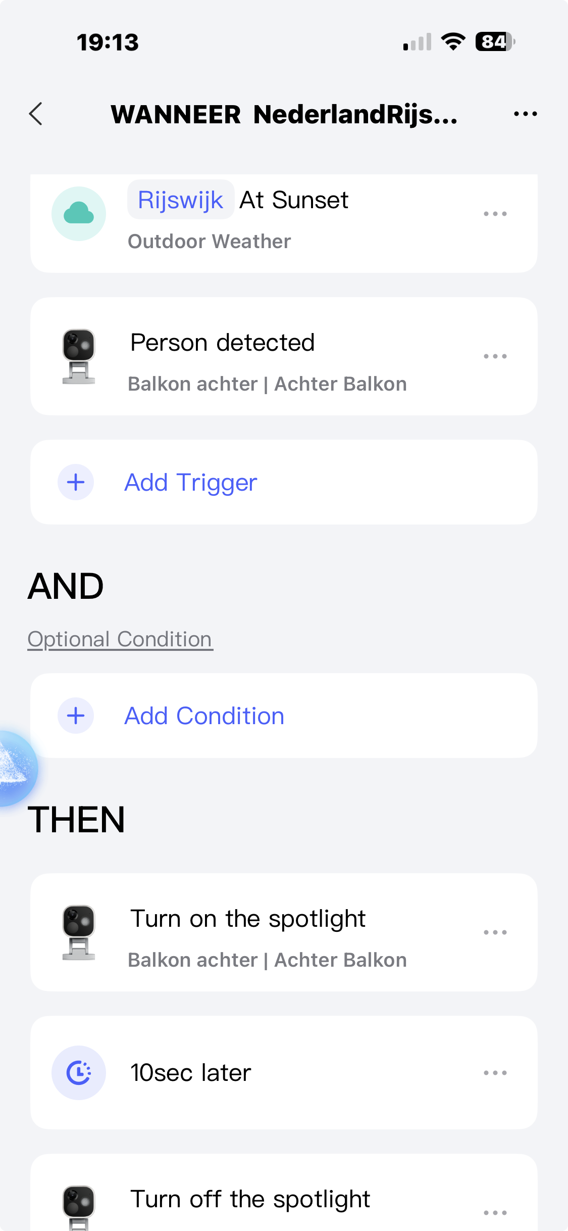

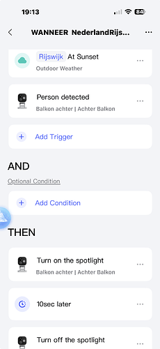

Hello all hope this is usefull for people who want their spotlight go on at sunset when a person is entering a special area
You have to make 2 automtions
1 for sunset to activate it
And
1 for sunrise to deactivate it
Hello @gregor_serban_junior
Thank you for sharing your automations for turning on the Aqara G5 pro floodlight.
Hello, welcome to the forum. Thank you for sharing your automation. I would like to make a remark, your automation (picture)
will work incorrectly at night. Theoretically, it will work throughout the day. The corrected automation for your case is described in my lesson 27(2)Automation 2.0, lesson 27 (part 2), controlling camera spotlights at night (G5, G100). Turning on when the camera sees an event.
