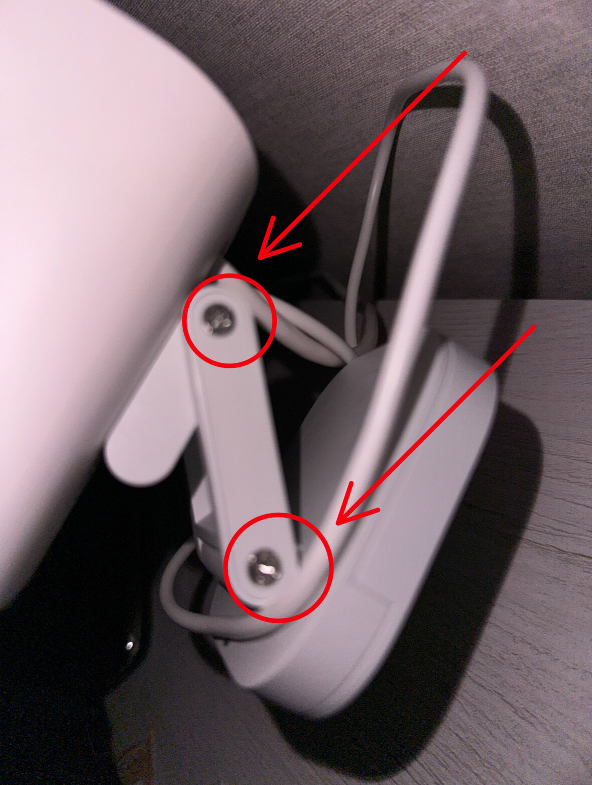

Hi. There is a solution, you need to tighten these screws on both sides and the camera will hold the position. Use a screwdriver and tighten the screws :handshake:
@johnsond28
I don’t have the screws on the arm like your showing !
How strange
There are screws, they are probably under your rubber bands. You need to carefully remove the rubber band and the screw under it with something sharp.
