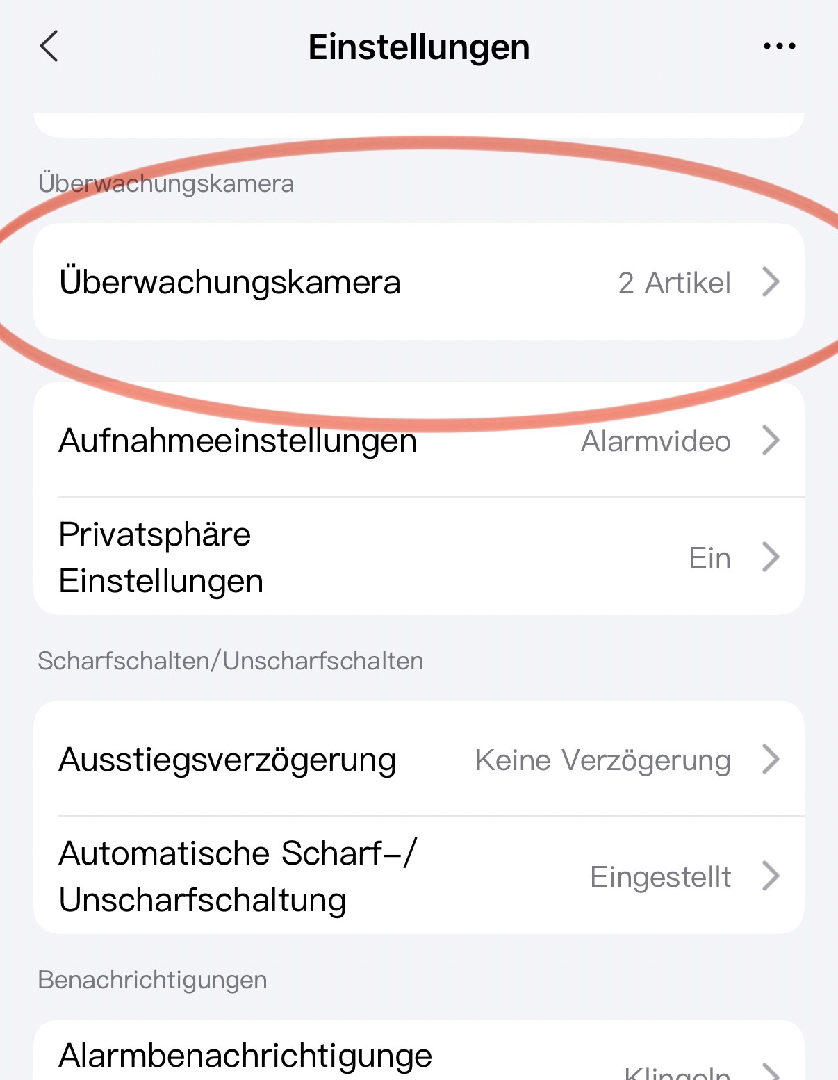

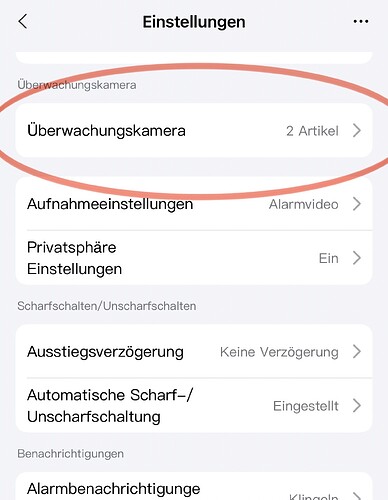

Have you selected both in the settings as surveillance cam? And have you selected one correctly as Primary Matter Controller for Apple Homekit in the settings?
I activate the alarm via M1S Gen2 hub and only one of the cameras arms Away. None of them are added as security cameras because I don’t pay for HomeGuardian.

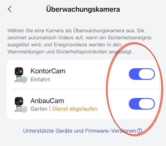

You can use the security camera without subscribing. When you activate a camera under “Security Camera” a video recording will start when an alarm is triggered, which will then be stored locally on the camera. For example, on a G5 Pro, the recording will be stored in the internal memory, whereas on a G3, it will be stored on the SD card if one is inserted.
However, I don’t think this option relates to activating or deactivating the alarm system. I have two deactivated cameras, yet they still activate or deactivate the alarm system.

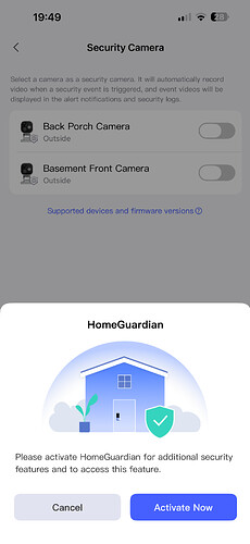

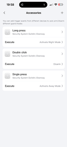

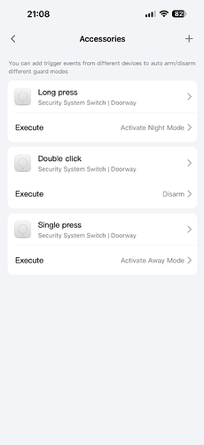

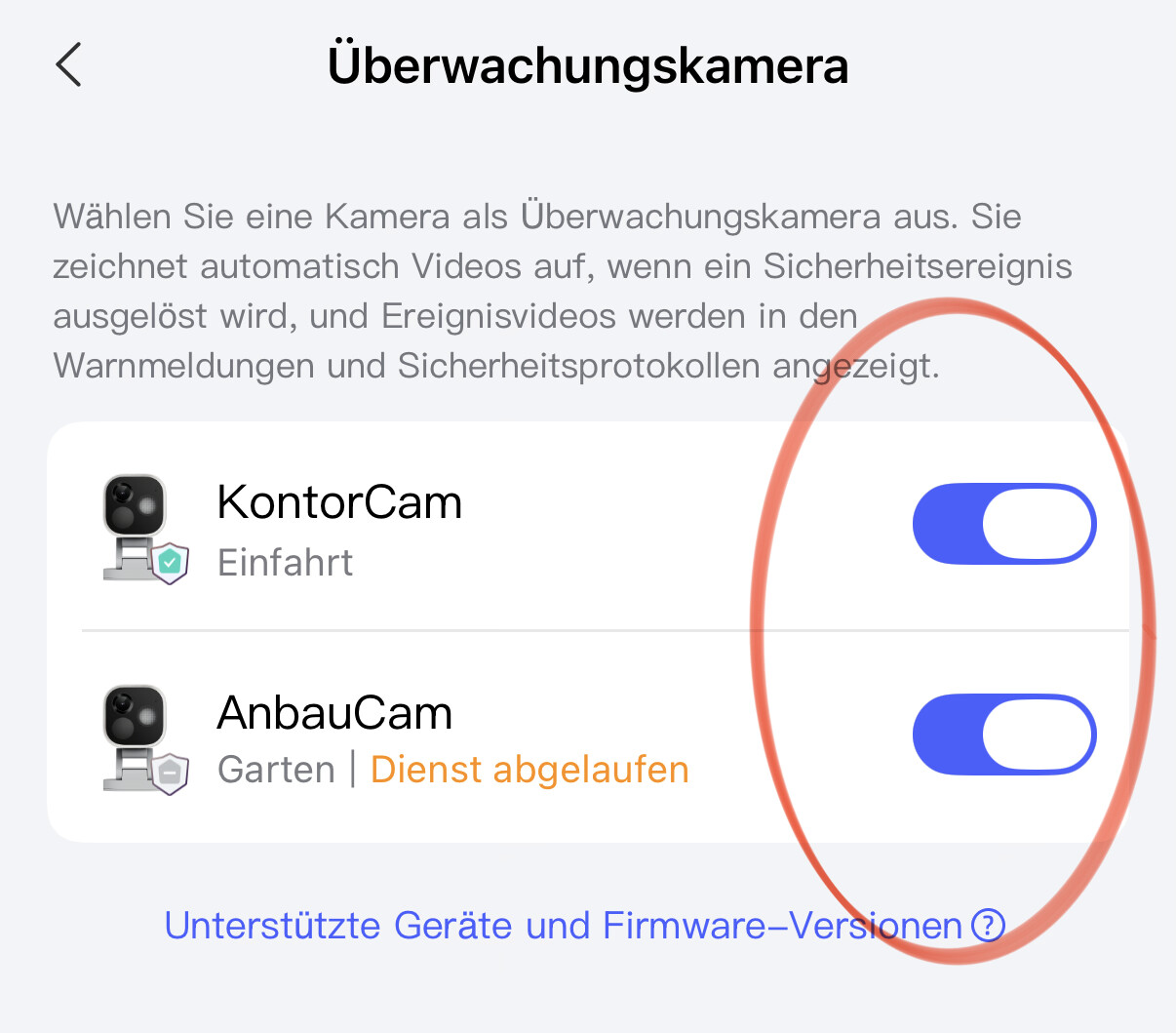

Actually, not quite true… you NEED HomeGuardian for that (see attached image). And one of the cameras does turn on Away but the other one doesn’t. I trigger Away mode via Mini Button Switch.
Oh, yes, sorry. I still had a trial subscription for one of the cameras and hadn’t realised.

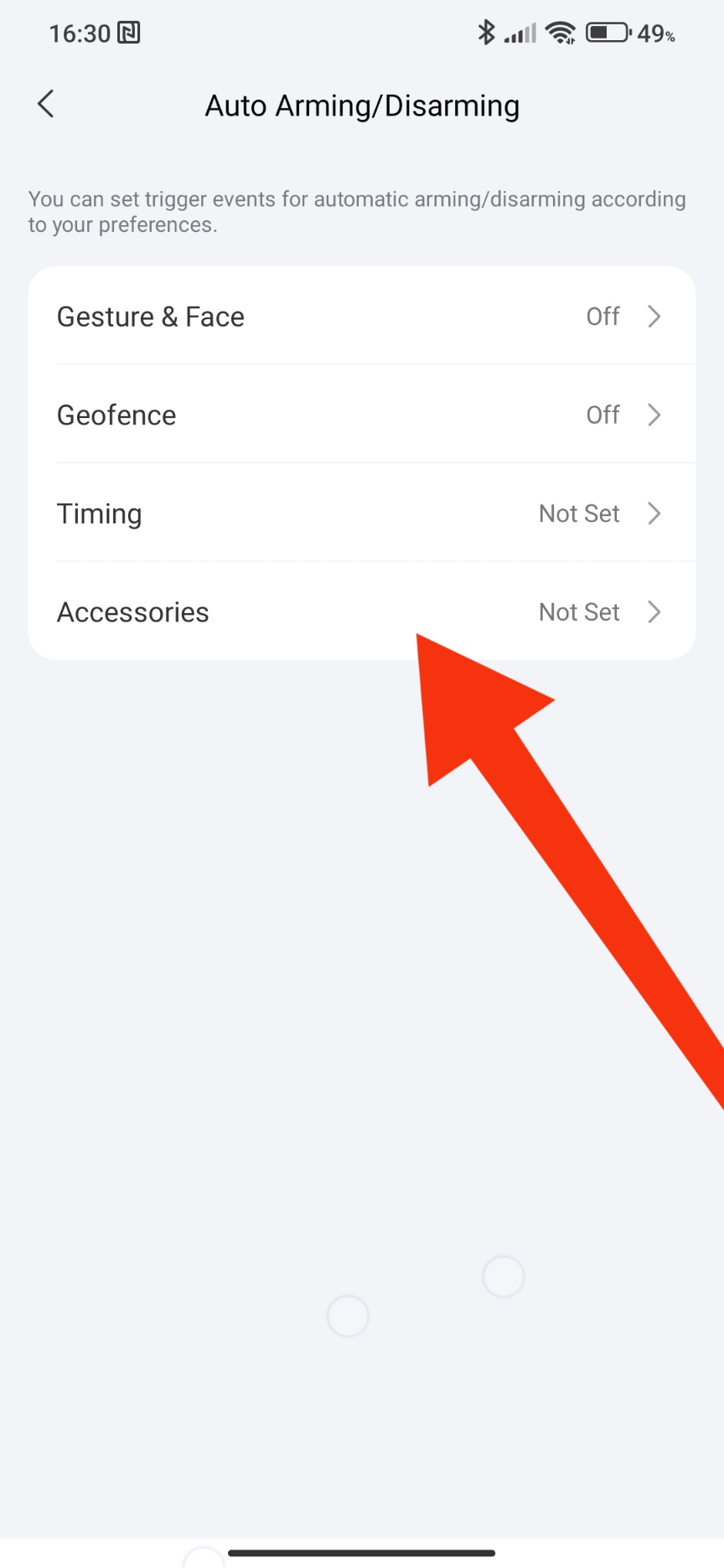

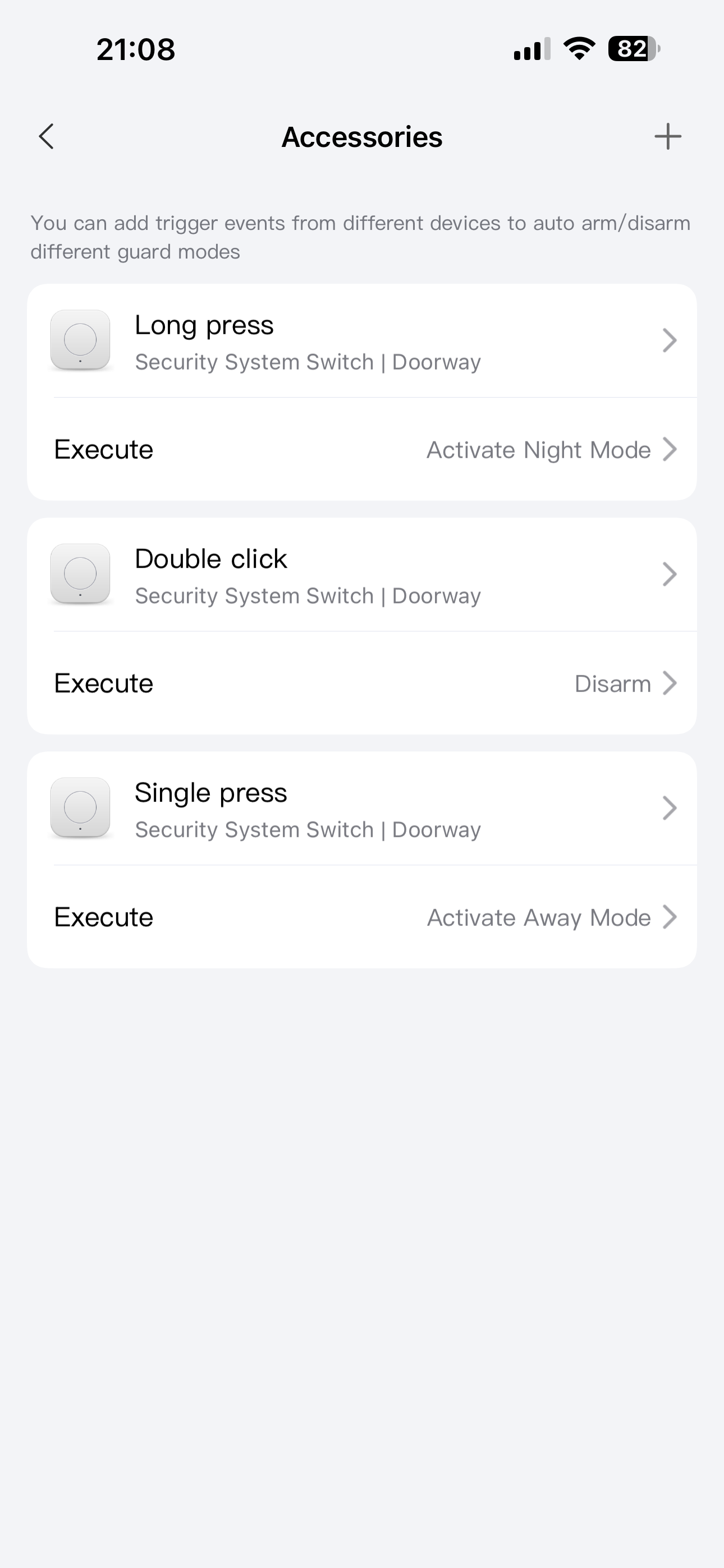

It’s not an automation, it’s setup in Auto Arming/Disarming…

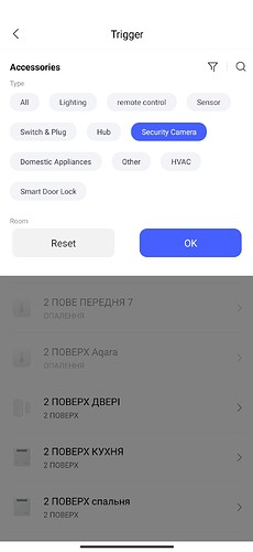

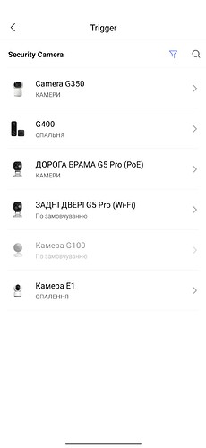

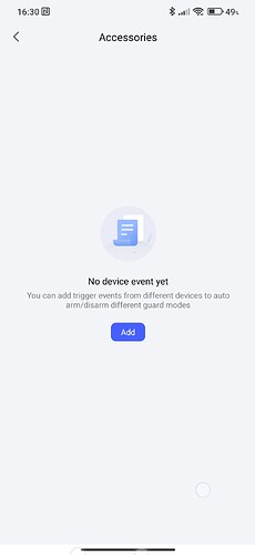

Hi, are you using these settings?

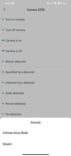

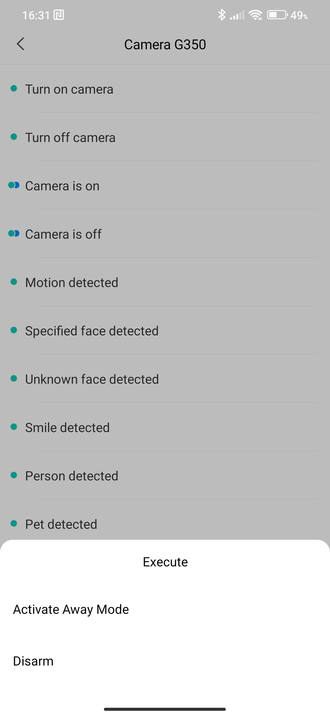

Explanation, insert cameras that turn on/off security depending on the state (On/Off) of the camera. Then make automation so that whether the camera is On or Off (incognito mode) will start/stop automation.

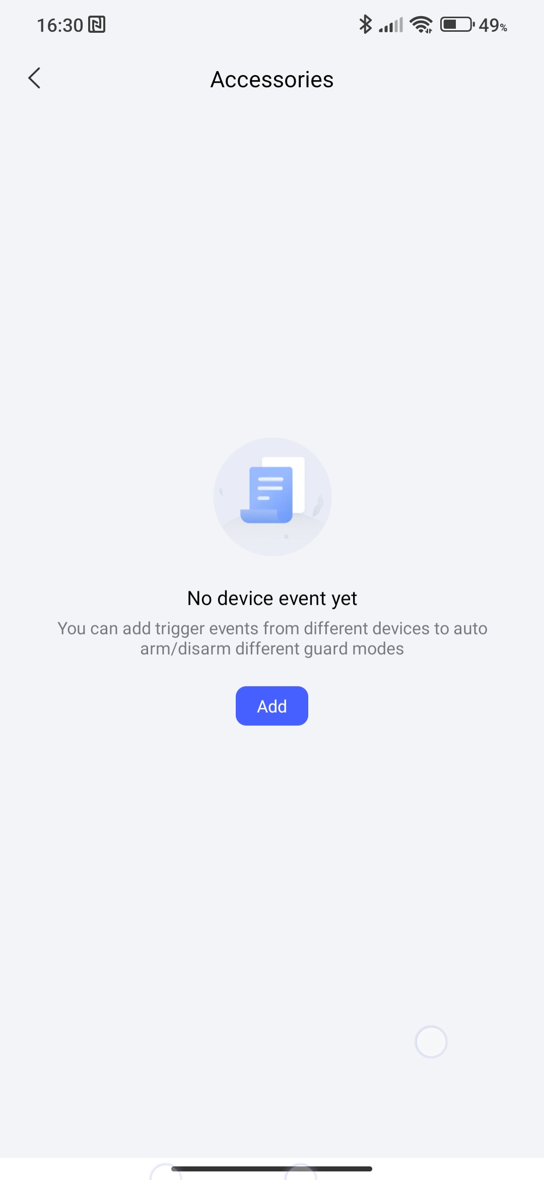

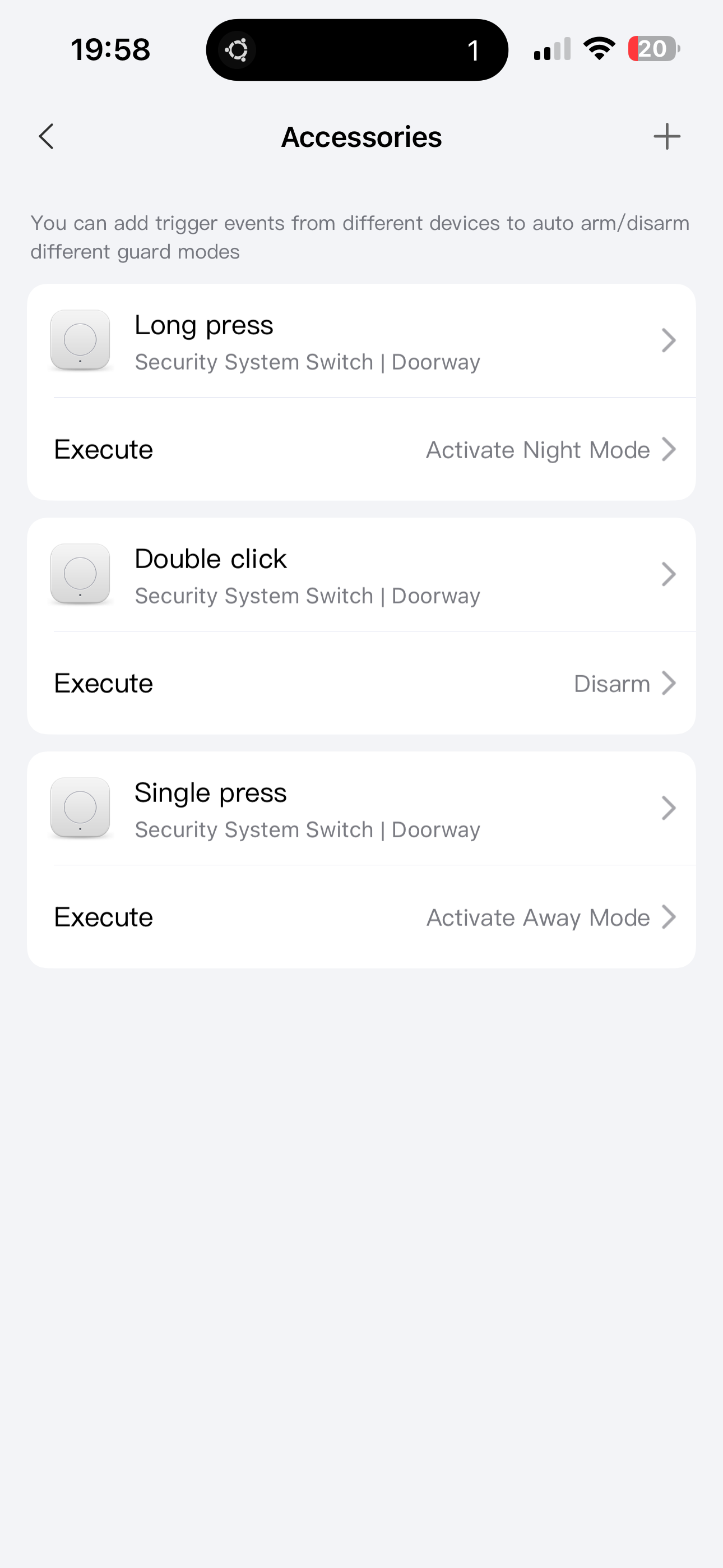

I have only this set in here, and the first camera still goes into Away mode if the hub is set to Away.

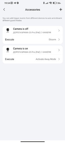

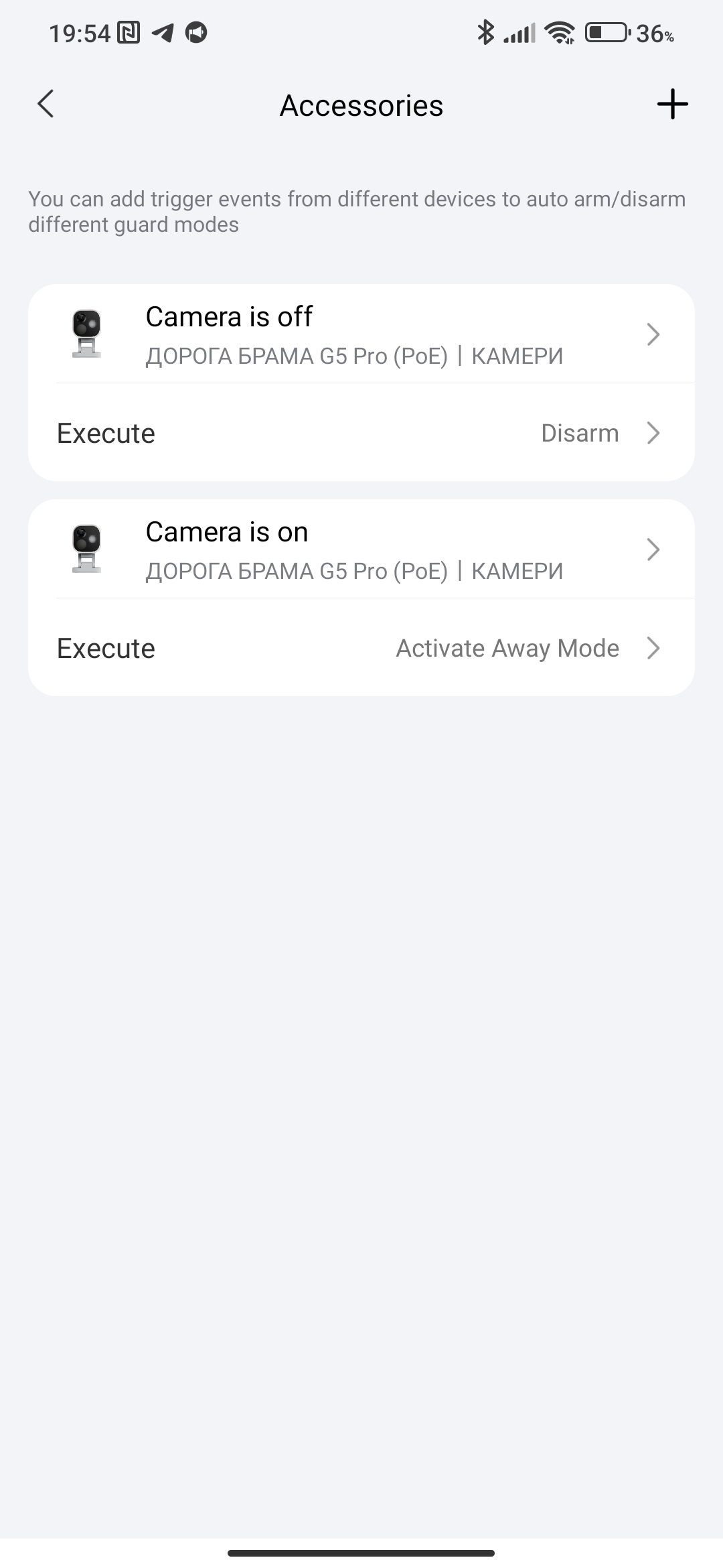

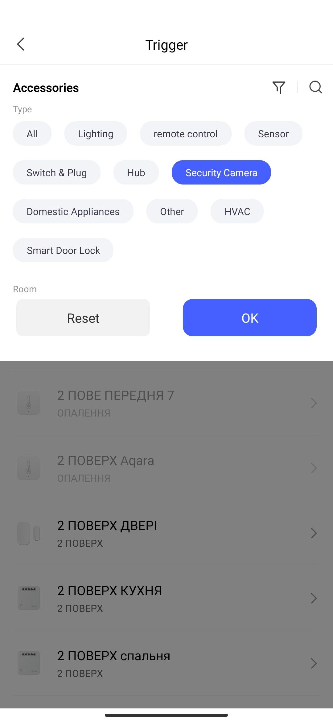

Try my suggestion. Control the On/Off security using cameras. And use the button to On/Off the cameras (two pieces) using automation.
G5 Pro’s don’t have that as an option I see…
It was actually this setting! Now both of the G5 Pros activate Away mode when arming.
