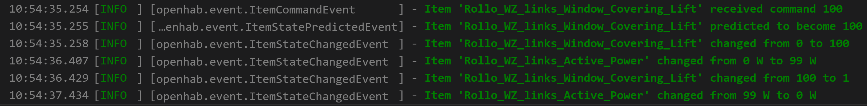

Now for the weird part: When I try to use OpenHAB to send a command to the “H2 EU” that tells it to drive it to 100%, it just moves a few centimeters. In the Aqara App, it shows that it has moved exactly 1%. Sending any commands via matter with percentages below 100% always drive the shutter to fully opened position.

Here is btw the log from OpenHAB, showing that it sends the command correctly and shortly thereafter receives from the device, the new state as “1”.
