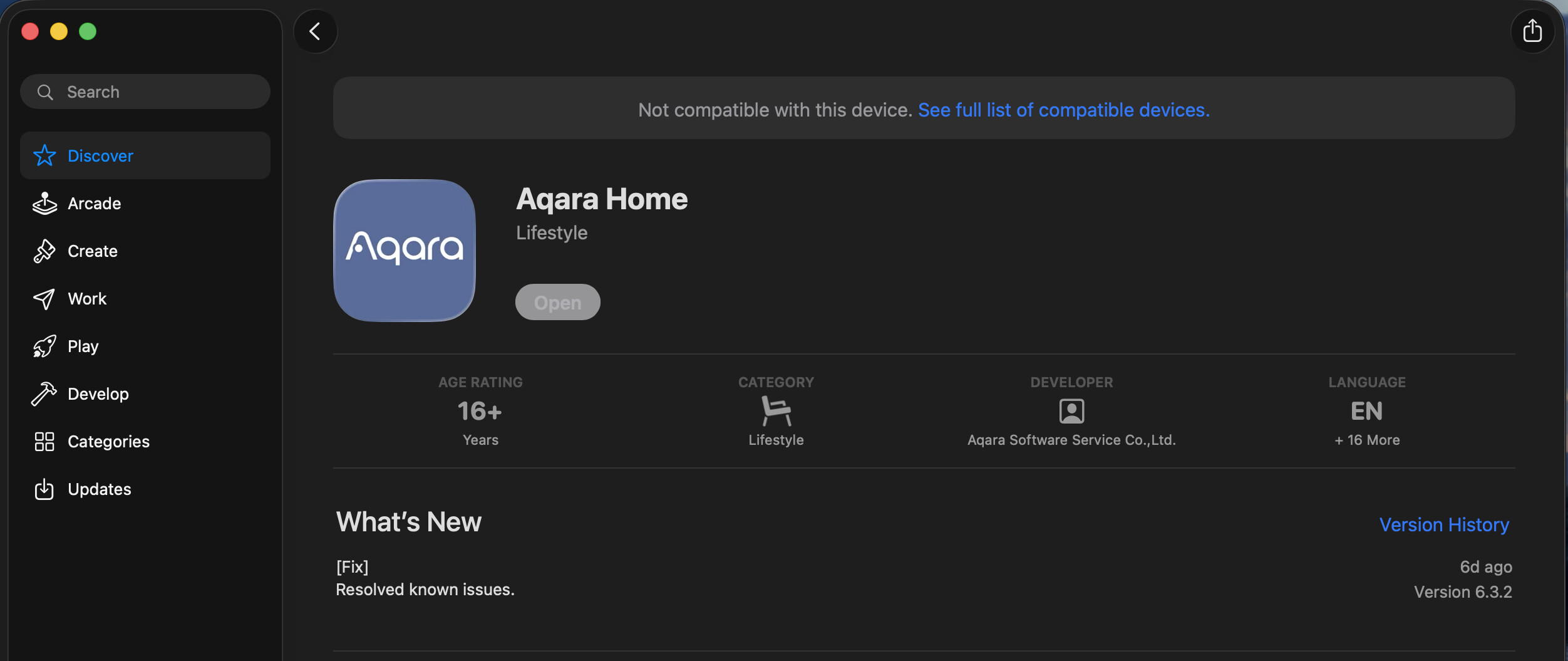

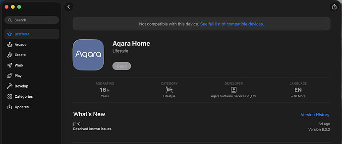

Since over a week now I am not able to update the Aqara home app on my MacBook Pro M4 laptop, there is a new version out but it now says its not compatible with this device.
it has been fine updating with all the previous versions.
any ideas why please.

Ok yes sorry I meant the mirrored app, but was just saying it happily was updating until a week or so ago.
No I’m not currently using beta software. It’s version 26.5.1

still can no longer update the iPhone/iPad Aqara home app on my Mac.
Is there going to be a fix for this ?

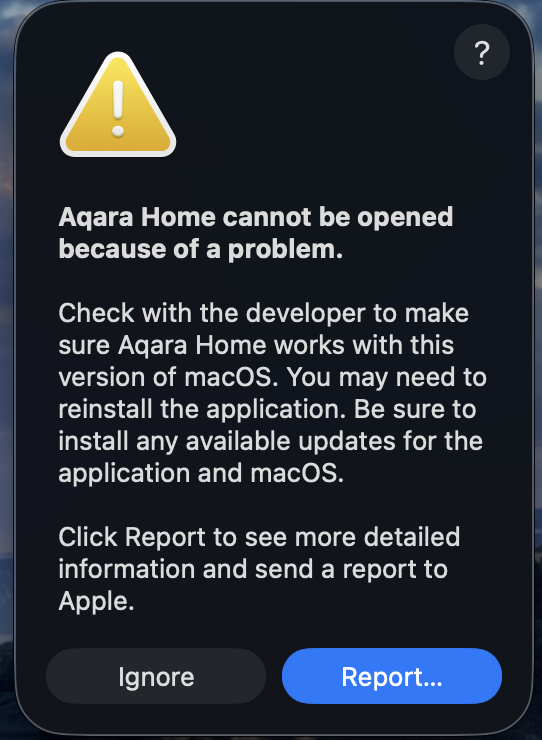

An update came out today so finally was able to update the app on my Mac, but now it won’t run at all and always comes up with this error.
Even after a restart same issue.
Also removed the app and installed it again, same issue.
Sent the report to Apple.

Hi everyone, Aqara Support is already on the case.
Just to clear up the comments about it being an iPad app and not being compatible with Mac – that’s not really the issue here. Apple Silicon Macs can run iPad apps straight away, and Aqara has been doing this for ages. The app didn’t suddenly become permanently incompatible; it’s just a simple coding oversight introduced in version 6.3.3.
I had a look at the macOS crash report, and it seems the app is crashing straight away when it’s launched because it tries to call a specific new HomeKit tool (HMAccessorySetupManager). This tool works fine on iOS/iPadOS, but it doesn’t exist (or is restricted) in the macOS environment.
The developers forgot to add a basic platform check before calling this tool, so macOS panics and instantly kills the process.
It’s a piece of cake for their iOS team (they just need to add a couple of lines of code to check if the device is a Mac before running that specific function). I’ve sent them the exact stack trace showing the missing symbol, so they know exactly where the bug is.
Hopefully, they’ll push a hotfix update very soon.

Hello @_Ross
The issue has already been resolved and will be included in the new update; the scheduled update date is July 2.
Ok good news, thanks very much.
Version 6.3.6 has been released. Try it. It’s now working for me without any errors.
ok good news, I will install it later on, thanks
