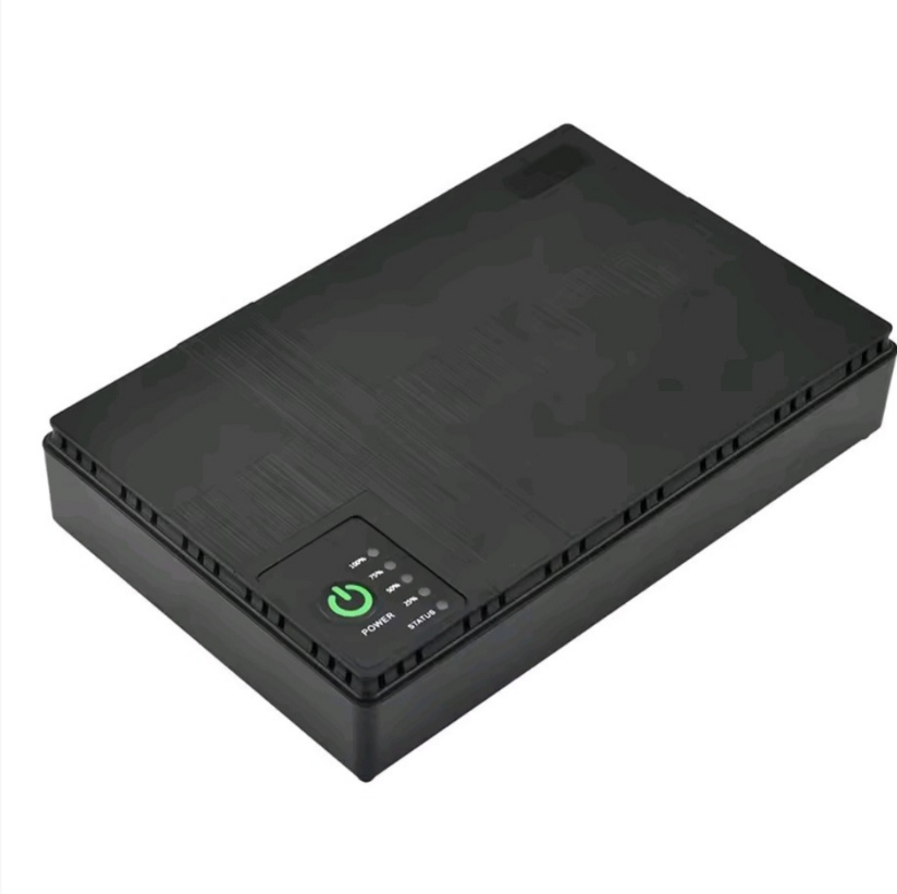

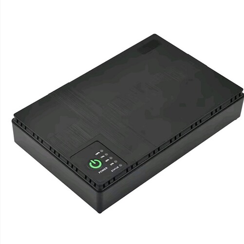

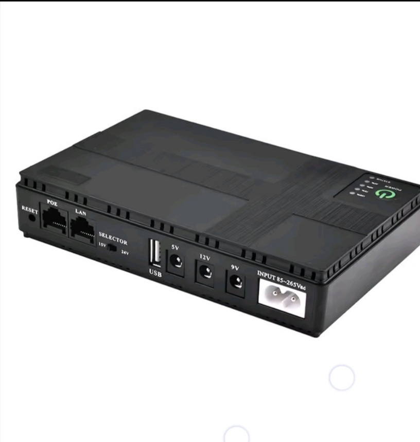

In fact, I wrote this explanation so that users understand what power low-voltage UPS (5, 9, 12 volts) should be used for stable operation of the gateway. This is a very, very important component of the reliable operation of a smart home. I have each gateway (which is involved in the management) has its own mini UPS.
100%, it will completely work. Read my top post, I recommend doing that.
