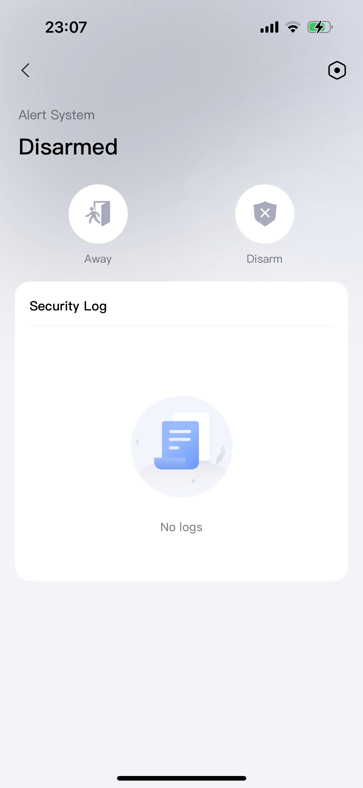

Hi! Ihave a aqara M3 chinese version bounded on my homekit and 5 sensos (doors and windows) only! I only use aqara as security system and operates by homekit! When I chosse “away” mode to engage alarm system all are ok! But, when returning to disable alarm in “OFF” and change the app to another one, on return to homekit the state back to AWAY

First I mind the problem is Homekit (every time start the home page the security system show the last state, and when turn off, back to away again…) later I do aqara software tests and I see greyed the disarm button and can’t disarm…

Swap the power supply… maybe it’s the problem! Until now all settings prevail away and off…
Maybe my later powersupply has deprecated
Happy to have helped you👍.
Thank You! Work like new! :smiley::+1:t3:
