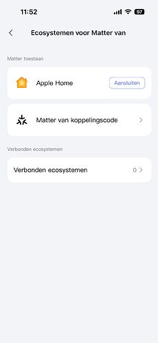

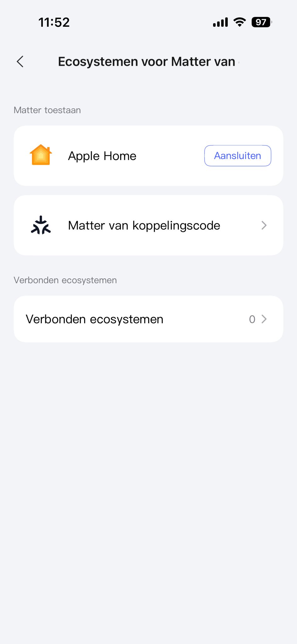

This is what I see in the Aqara app
Oh, now I know what you mean.
When you press “Matter van koppelingscode,” you get the pairing code that you need to enter into another system, such as Home Assistant. After that, the devices in the system can be controlled via Matter.
