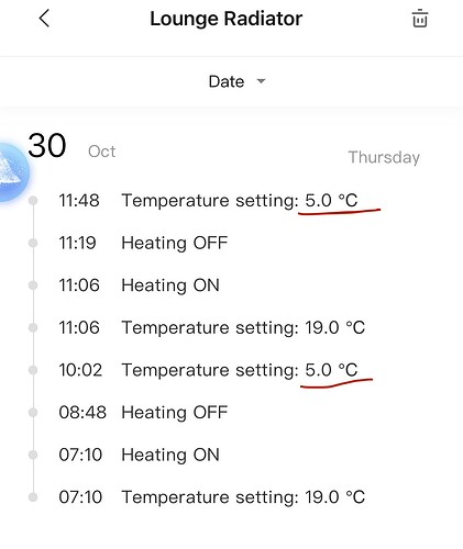

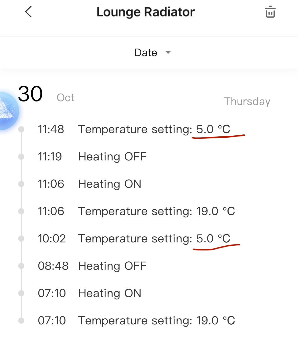

Don’t really understand the logic behind Aqara making the radiator thermostat automatically set the temperature to 5 degrees after being turned off for a while. I set it at 19 degrees and expect my radiator to automatically come back on when my room drops below 19.
Hello, in Off mode, the thermostat stops controlling the temperature and operates in “emergency” anti-freeze mode.
I set the anti-freeze temp to 10 degrees tho… so the software is definitely doing something wrong!
