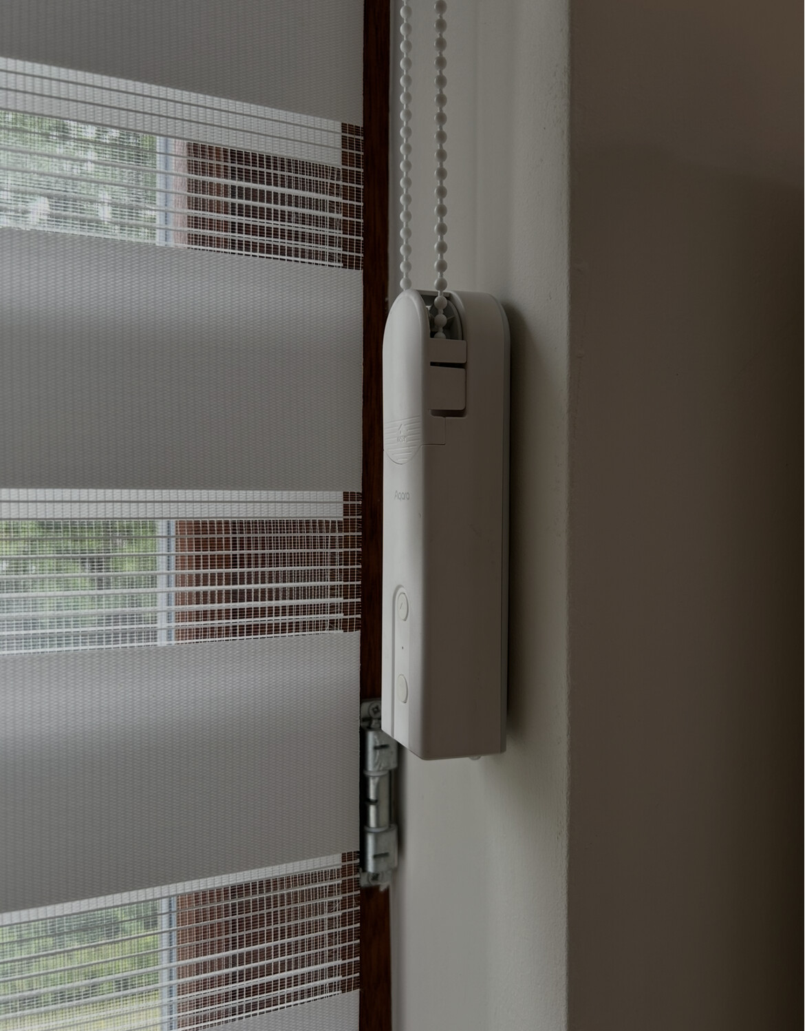

If you have a window reveal painted in a light color, then the dark color of the window shouldn’t really matter that much, right?
That’s true. However, I have a triple window with three roller blinds, and the middle E1 driver has to be mounted on the window frame anyway. That’s why I’d love to find a safe way to change the housing color to better match the dark brown frames.

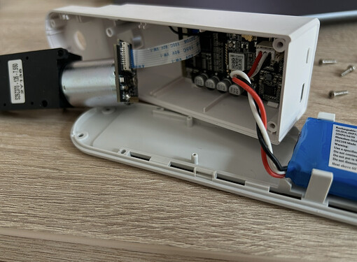

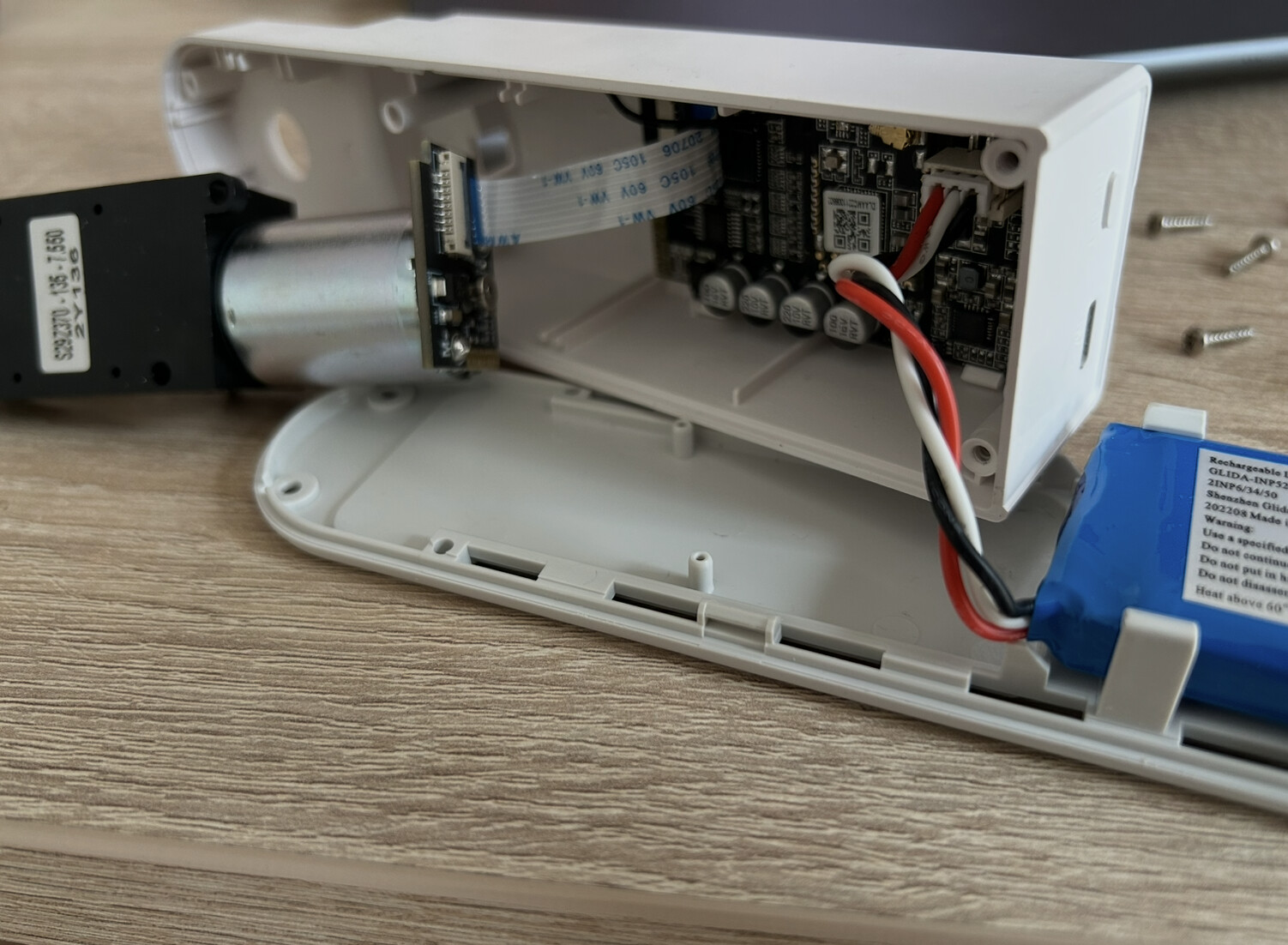

Can you separate the housing and spray paint it?
I’ve contemplated doing this on my E1 Curtain motors, but only the top part is visible there and isn’t electronic at all.
Remove the four screws and carefully take off the back cover. The internal components are simply plugged in and can also be carefully removed. Only the circuit board is secured by plastic tabs, which must be carefully pushed back, leaving you with the bare plastic housing.
But please note: opening the device will likely void the warranty.
A tinkerer like me - always ready to take things apart :slight_smile:
I’d say this is the way to go if painting is a must.
