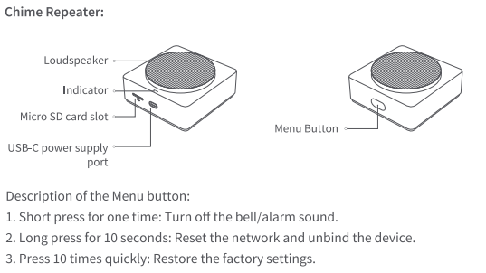

Did you perform a network reset or a full factory reset?

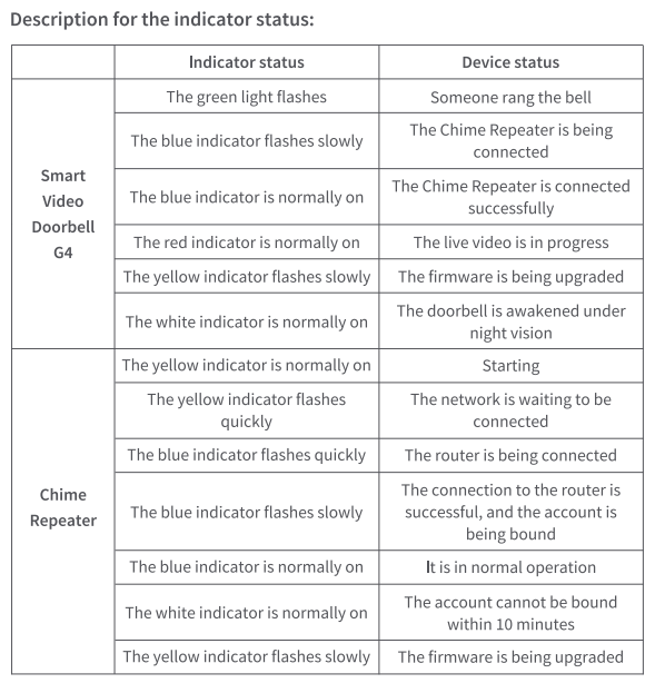

Here are the instructions from Aqara:

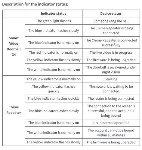

What do the LEDs on the doorbell and the chime indicate?
Does the doorbell respond (the LED lights up) when you press the bell?
Thx alot, John.
Half of my problem is solved. What I did with reseting yesterday:
10 seconds cam-reset + 10x Chime button (messsage “reset successfull”) and the reinstall.
