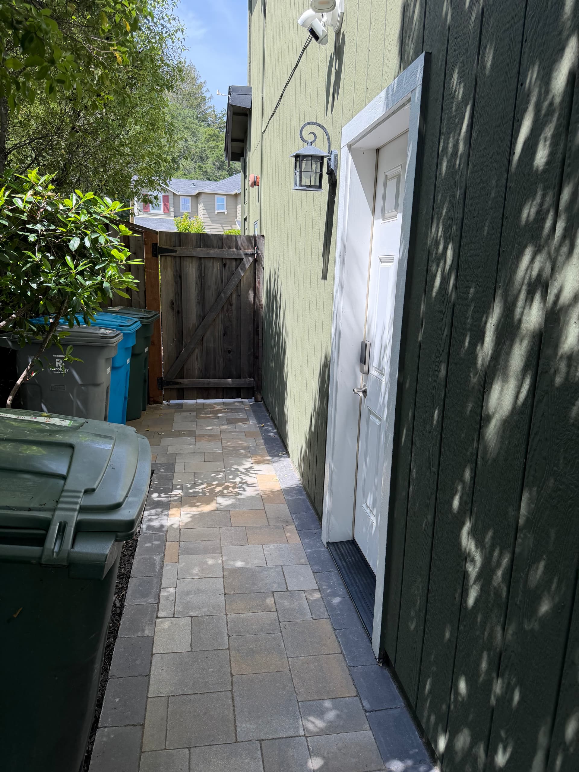

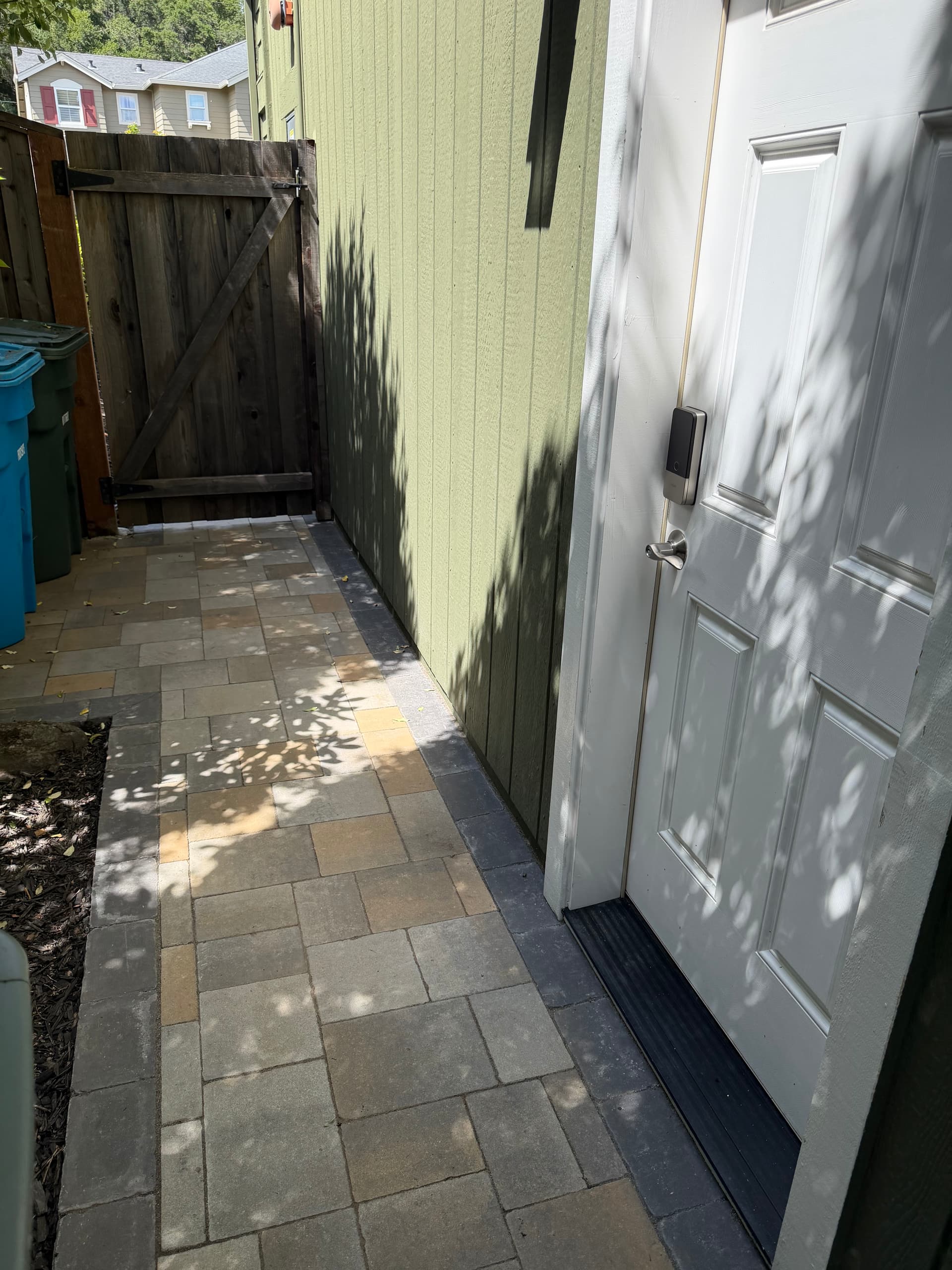

Just installed u400 and setup ok in Apple Home and Aqara app, but having issue with unwanted UWB unlocking.
Lock is installed on entry door near side of house. Long walkway path from front of house to backyard. I have UWB settings to disable Left and Right approach (in both Aqara app and HomeKit). Just front approach default is turned on. Using beta firmware 3110.
Any slow walking near the door from right side will usually trigger an unlock and that’s unwanted. Since the pathway is very narrow, it seems that a direct “Front” on approach would not be possible and can only be approached from left or right side!

As mentioned above, I have learned this as I have a side door along a narrow pathway that frequently gets walking traffic during the day and it falsely unlocks with UWB when walked by from the side even though approach setting is set to front only. I want to install 2 more u400 locks in the house that will work fine with UWB approach as expected. No way to keep the 2 that work fine on UWB Approach and the problem one have UWB turned off! Hope this will be a future fix !
