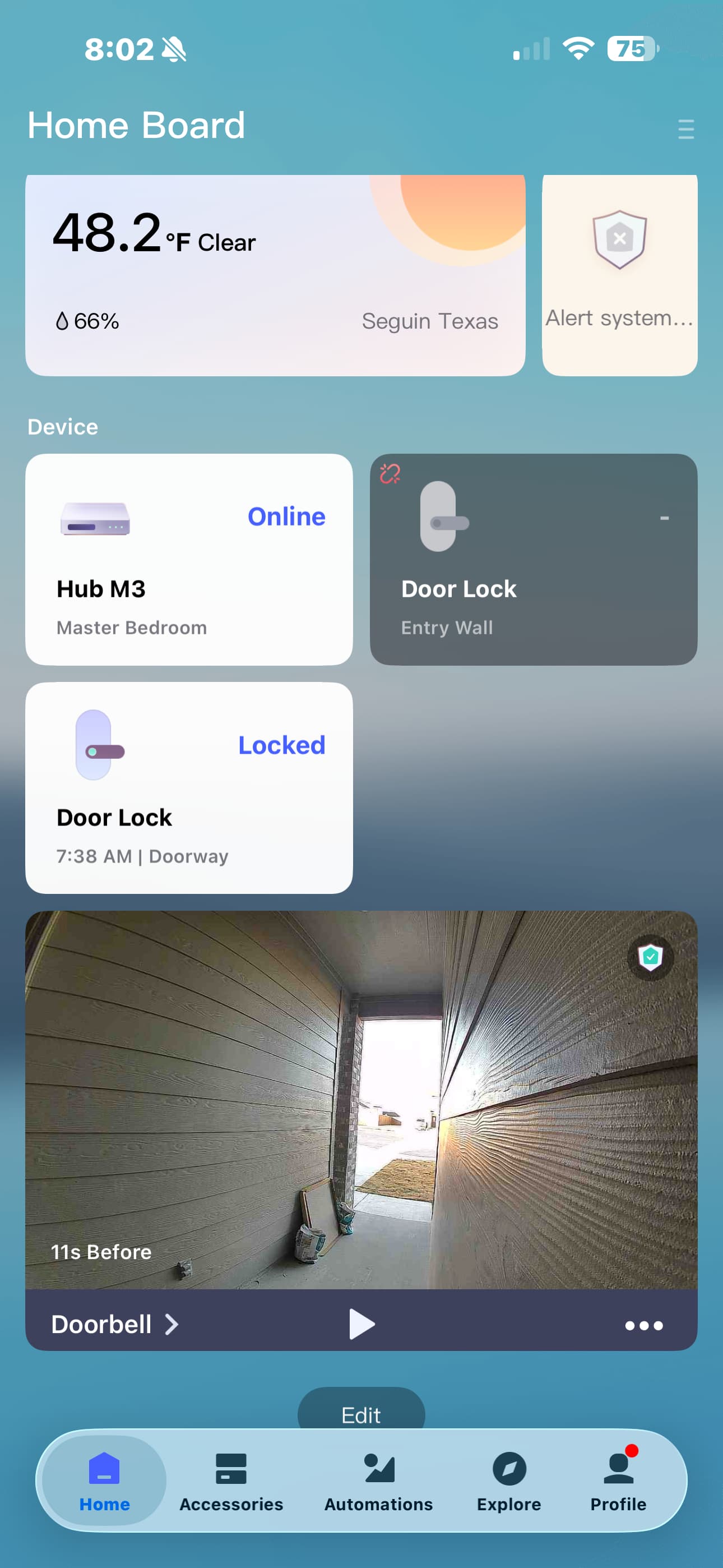

My experience with the U400 so far has been a bit lackluster. Initial setup was straightforward, but I ran into issues when adding it to HomeKit. I’m honestly not sure what I did differently, but after some trial and error, it eventually worked and everything seemed fine.
Unfortunately, after a short power outage (about three brief interruptions), the U400 dropped out of HomeKit. In the Aqara app, it began showing a red indicator in the top-left corner. To try to resolve this, I unpaired the lock and performed a factory reset to start fresh, but I feel that only made things worse.
At this point, I’m unable to add the U400 back to the Aqara hub, which means I also can’t re-add it to HomeKit. To make matters worse, I’ve been locked out of the house once already—the lock reads my fingerprint, but the door does not unlock. I have made sure the bolt area is clear.
I haven’t yet had time to read through other posts to see if anyone else is experiencing similar issues. I’ll be the first to admit that I’m still a bit of a newbie when it comes to smart home setups, but I’m willing to learn. Unfortunately, I only have one day a week where I can really sit down and troubleshoot, which makes this especially frustrating.
I’m hoping someone here may have suggestions or insight into what might be going on.
That kind of reads like you have Network issues? You didn’t mention any Hubs etc but that would be a characteristic of one + Bluetooth use. What Hubs are you using? I would reset the Lock and start over like it is new rather than trying to figure out what went wrong. Long press the reset button for more than 5-seconds.
Sorry, I didn’t include in my tread. I have the Aqara hub M3. I will reset again and see if I have a different outcome. Hopefully resetting for third time will help with the hub connection issue.
