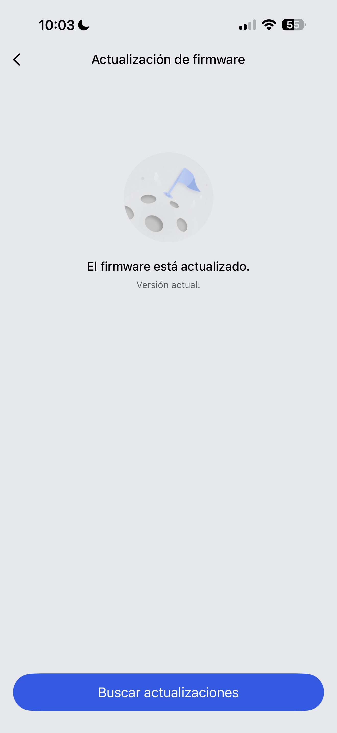

  • confirmed that the firmware was fully updated;

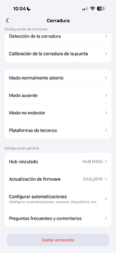

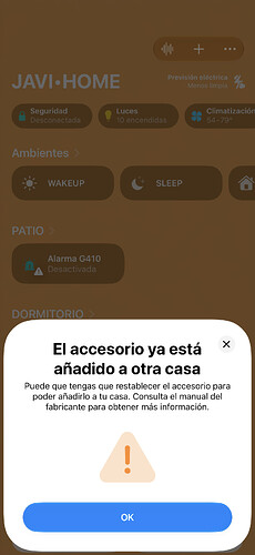

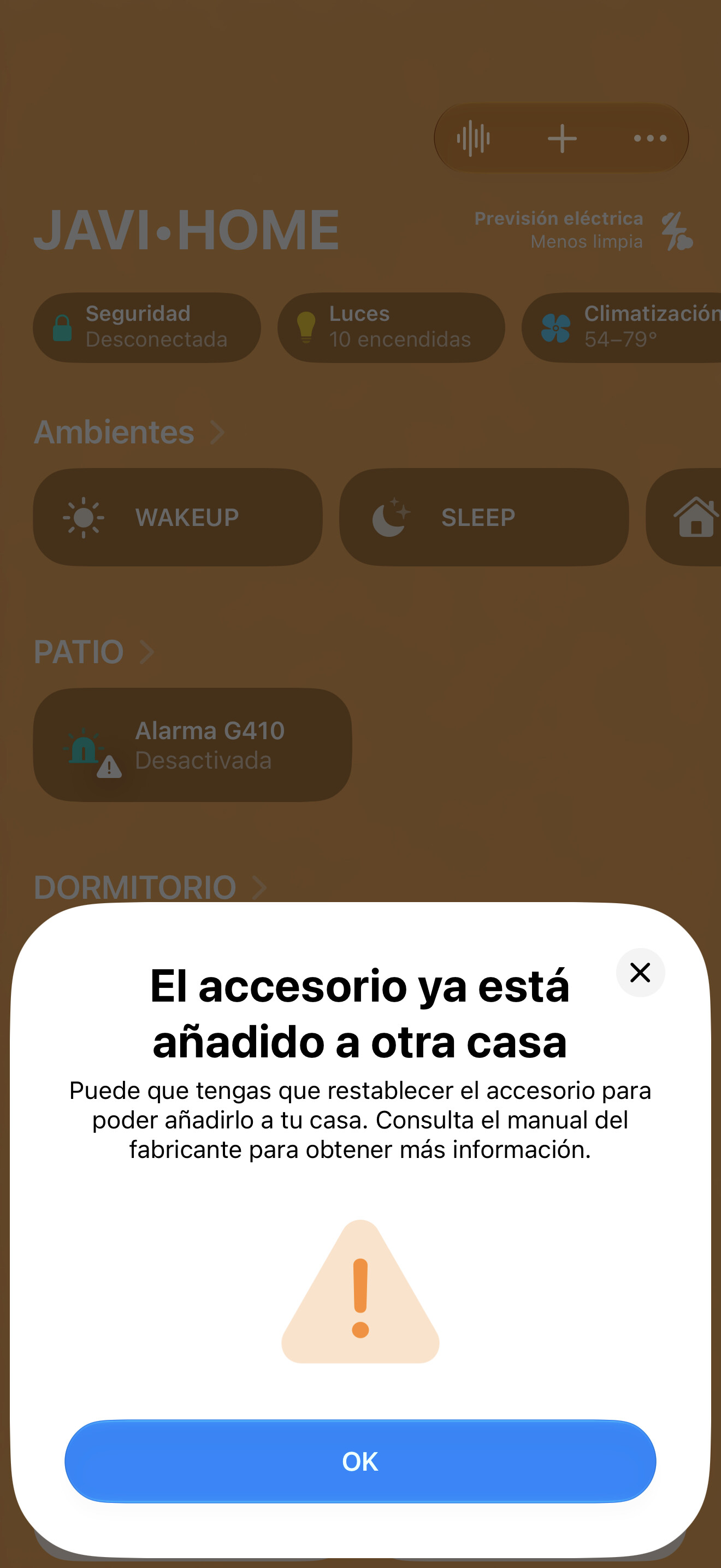

Since the lock had disappeared from Apple Home, I removed it from Apple’s Home app.
However, Aqara Home continued reporting that the lock was still linked to Apple HomeKit.
Because of that inconsistency, every attempt to add the lock back into Apple Home resulted in Apple’s message saying:
“The accessory has already been added to another home.”
Meanwhile, Aqara still believed it remained linked.
I could neither re-add it nor completely remove the HomeKit association.
Eventually, after exhausting every other option, I removed the lock from Aqara Home as well, hoping to start from scratch.

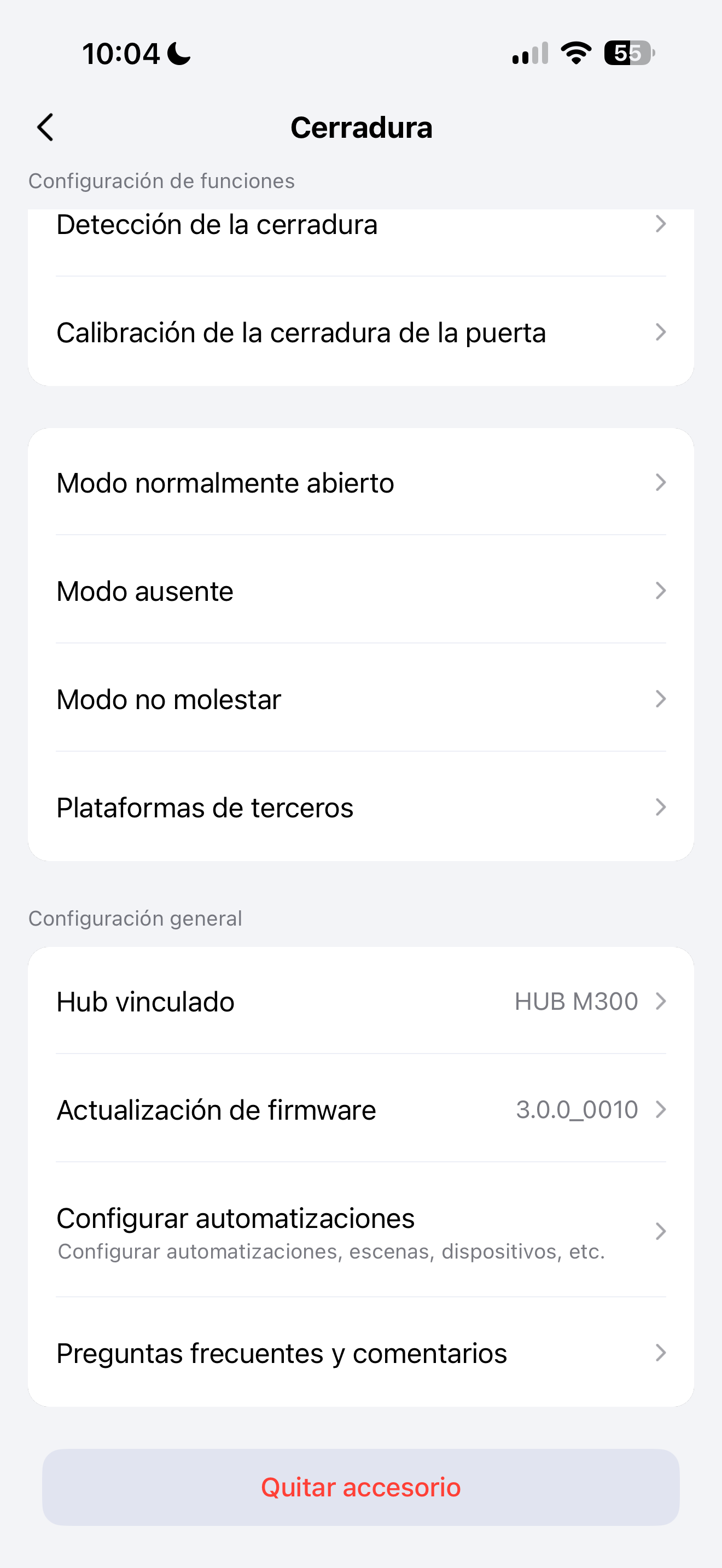

Hi there and welcome to the forum.Well quite a story and I am really sorry to hear that your smart lock is not working as it should.
-now first thing first did you check on settings/general on the matter devices see if the lock it is still there as adding matter/thread devices will store them there too and that is why you get that error telling that you unlock is added on another home.check this first and tell me if is there and if is then eliminate it from there.lets make this steep by steep.also do you use ios27 beta?how many routers do you use on your home?asking all this as there my be so connection issue between or Apple devices and the Aqara smart lock.
-second steep will be to turn off the electricity on you home for 1/2 min so the Apple devices reset the thread connection.
-3th steep is to add again the smart lock again to aqara home app and after is added see if works from there first and if all works then add it to Apple home app but here as I mention you need to check if there is still listed on settings/general/Matter accessories.
