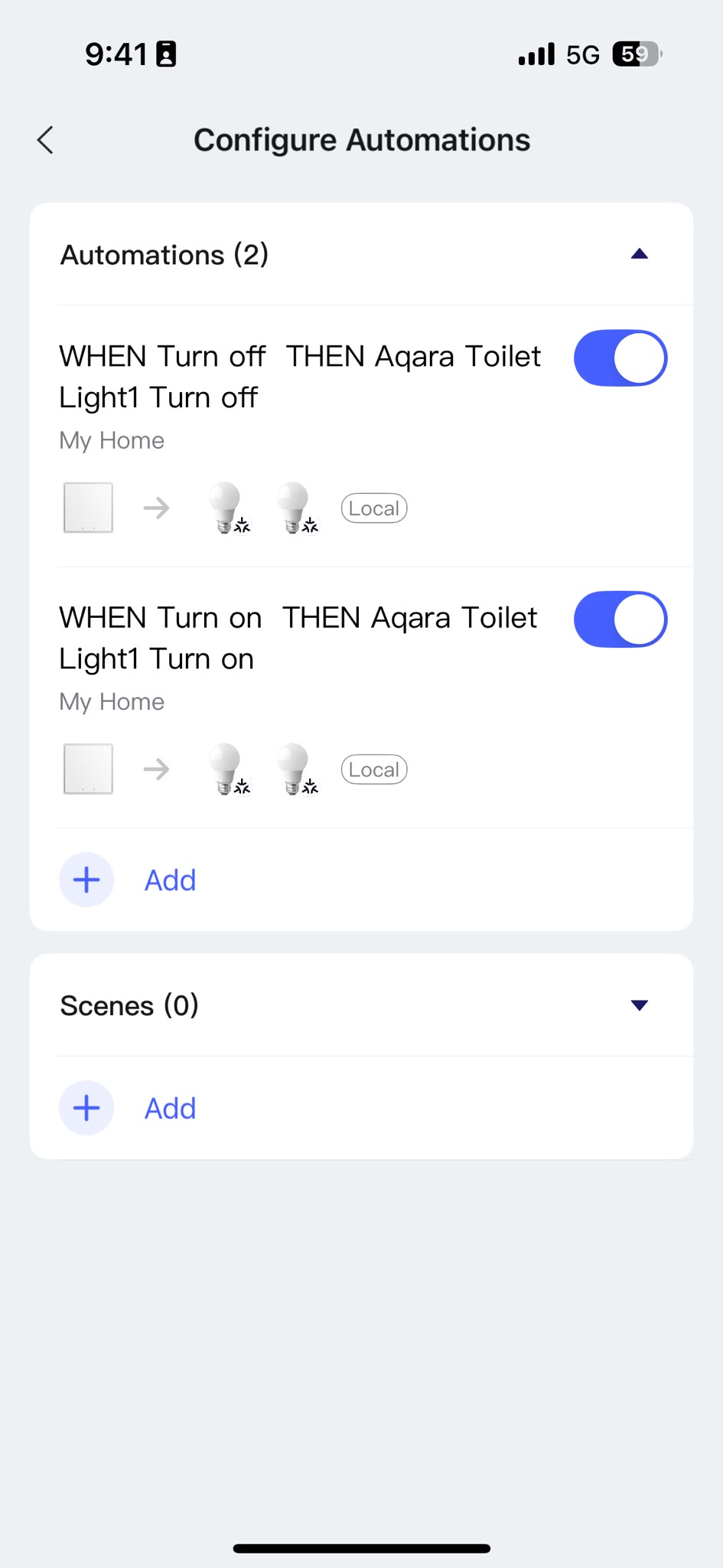

I’m having an intermittent issue with an Aqara switch and Aqara Home automation.
Setup:
  • Hub: Aqara Hub M3
  • Switch: Aqara Toilet Switch, about one concrete wall away from the Hub M3
  • Automation is shown as Local

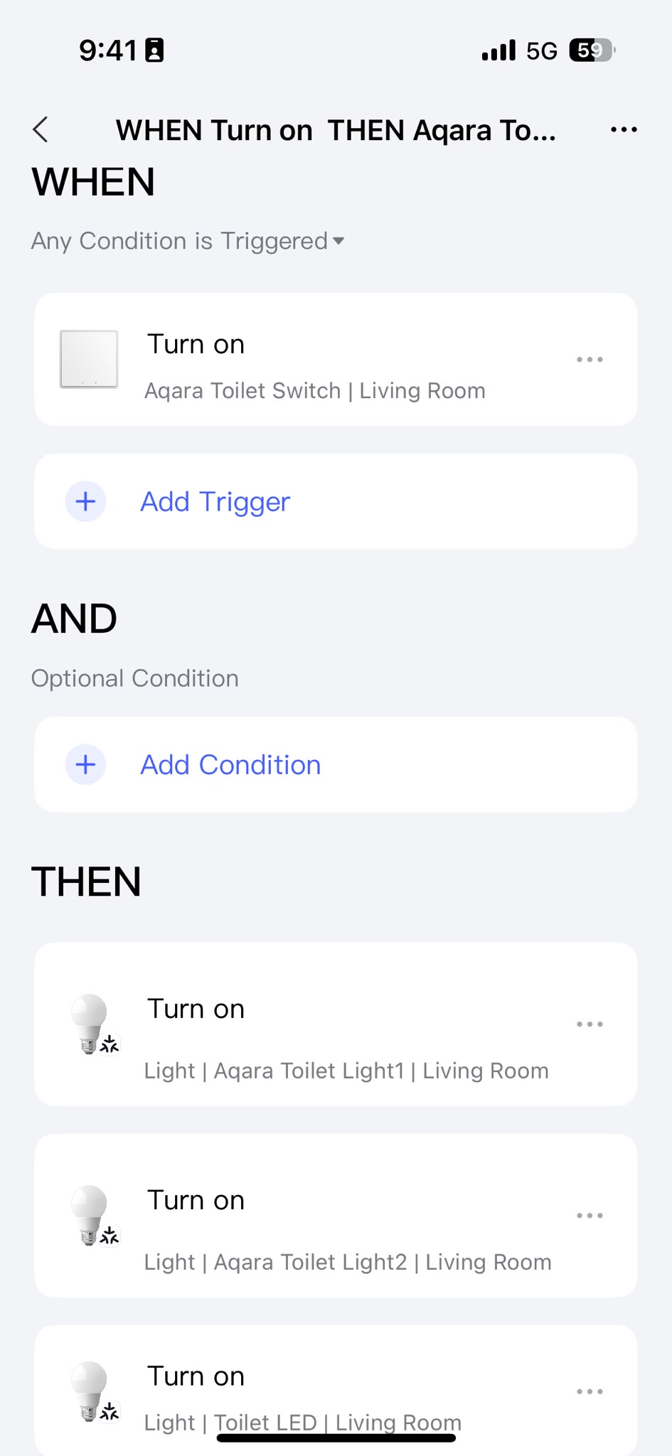

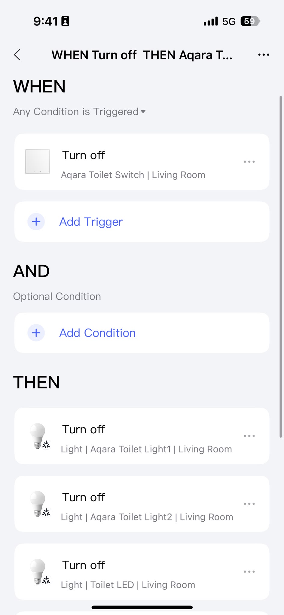

  • Automation logic:
    • WHEN switch turns ON → turn ON lights
    • WHEN switch turns OFF → turn OFF lights
  • Target devices are 3rd-party Matter devices , not Aqara Zigbee lights:
    • Toilet Light1
    • Toilet Light2
    • Toilet LED
Issue:
Sometimes when I press the switch, the switch state updates correctly in Aqara Home, for example it changes to OFF, but the lights stay ON. So it seems the switch event is received, but the automation action to the Matter lights does not always complete.

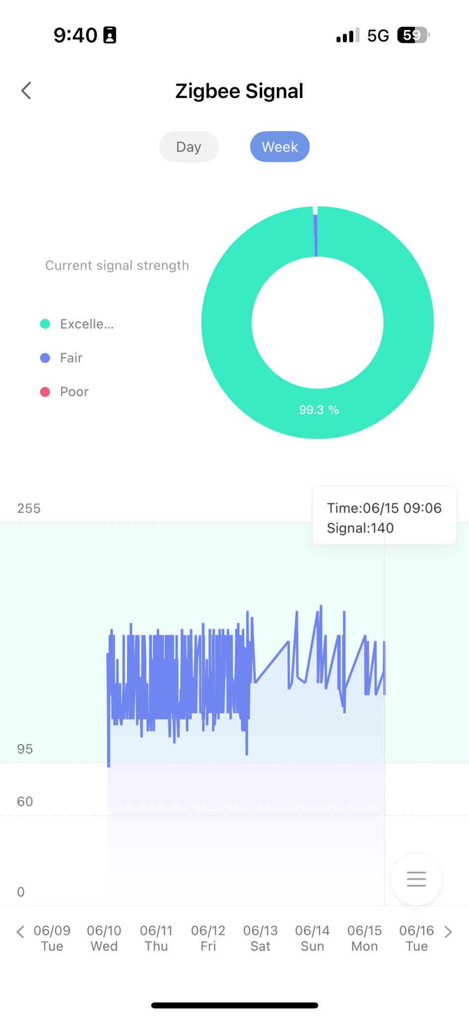

The Zigbee signal for the switch looks mostly excellent in the Aqara app. I also attached screenshots of the Zigbee signal and automation setup.
Questions:
  1. Is this a known issue when Aqara automation controls 3rd-party Matter devices?
  2. Does “Local” automation fully support Matter device actions through Hub M3?
  3. Is there any command retry mechanism if a Matter light does not respond?
  4. Would adding delay between each light action improve reliability?
  5. Any recommended setup to make switch → automation → Matter lights more reliable?
Thanks.

Yes, if possible, you should avoid relying on “reading” the current state in your automations, as the state always has to be queried first, or the last received state is read from a cache or memory.
So, if possible, it’s better to set it up like this:
a) Trigger: Switch is pressed (depending on the switch or mode)
b) Action: Turn on/off (instead of just Turn on or Turn off)
This means that you only need one automation instead of two.

Haha yes, “Aqara Toilet Switch” is not a new secret Aqara product — that was just my very “professional” naming style. :joy:
Thanks a lot for the detailed explanation. That helps me understand the logic better.
To clarify my setup:
  • Switch model: Aqara D1 single gang with neutral
  • I physically press the switch.
  • The switch state then changes correctly in the Aqara app.
  • However, sometimes the lights do not follow the automation.
  • The lights are 3rd-party Matter devices.
  • The lights receive constant power from another source.
  • There is no load wire between this switch and the lights.
I have seen the “Change to wireless switch” / decoupled mode option before, but because there is no physical wire between the switch and the lights, I didn’t really understand how it would apply in my case. From what you explained, I think I may have misunderstood the purpose of decoupled mode.
Also, yes, I noticed that when I turn the Aqara switch on/off quickly, the automation sometimes does not seem to trigger properly.
About using “Turn on/off” instead of separate “Turn on” and “Turn off” actions: I avoided it before because I was trying to keep the switch state matching the light state. For example, switch ON = lights ON, switch OFF = lights OFF.
But now I think maybe I should remove this “requirement” from my mind, because the light state can also be changed by other sources such as Siri, PIR sensor, or other automations. So the physical switch state may not always represent the actual light state anyway.
This is my first time doing a DIY smart home automation setup, so I’m still learning the best practice. Could you share more about how you set up your automation in a similar case, where smart lights can be controlled by a smart switch but also by other sources?
Thanks again for the help. Your explanation is very useful.
