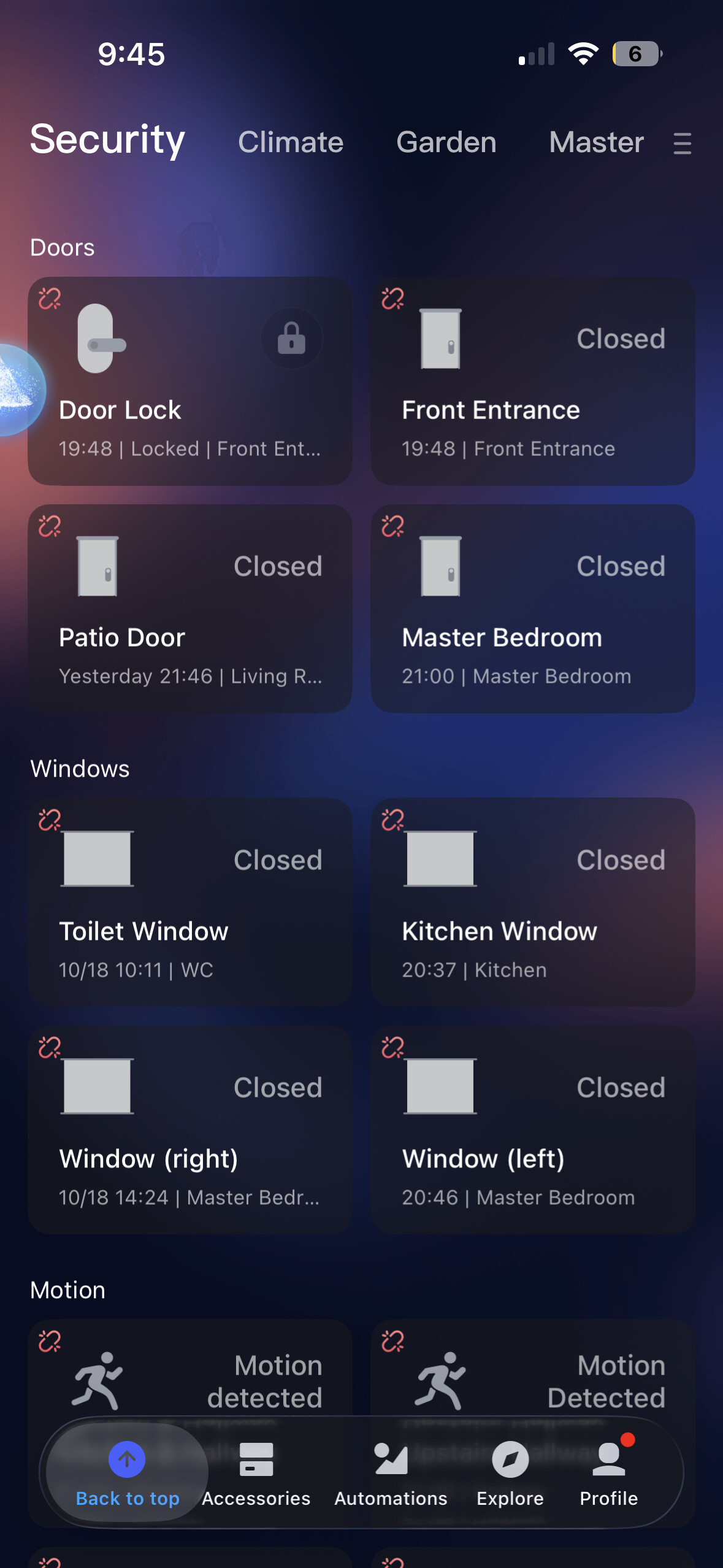

Same issue here. It just went offline. I tried to restart it, nothing changed. It’s reported via matter that is alive, HomeKit works, home assistant as well. I guess we just need to sleep it over, it might come back in the morning :slight_smile:
Interesting thing is, only M3 went offline. M2 and older camera hub are alive, and no issues reported on them.

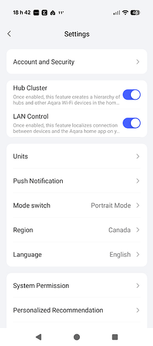

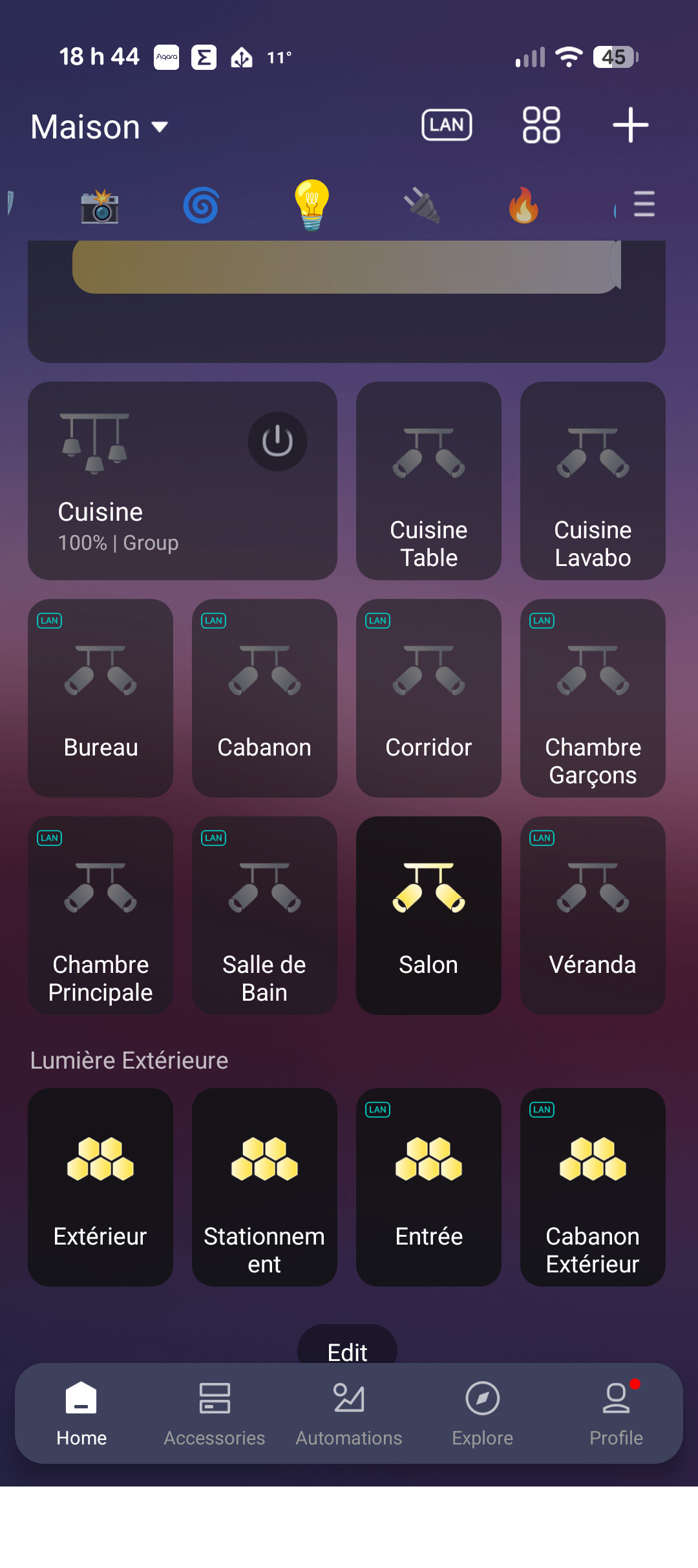

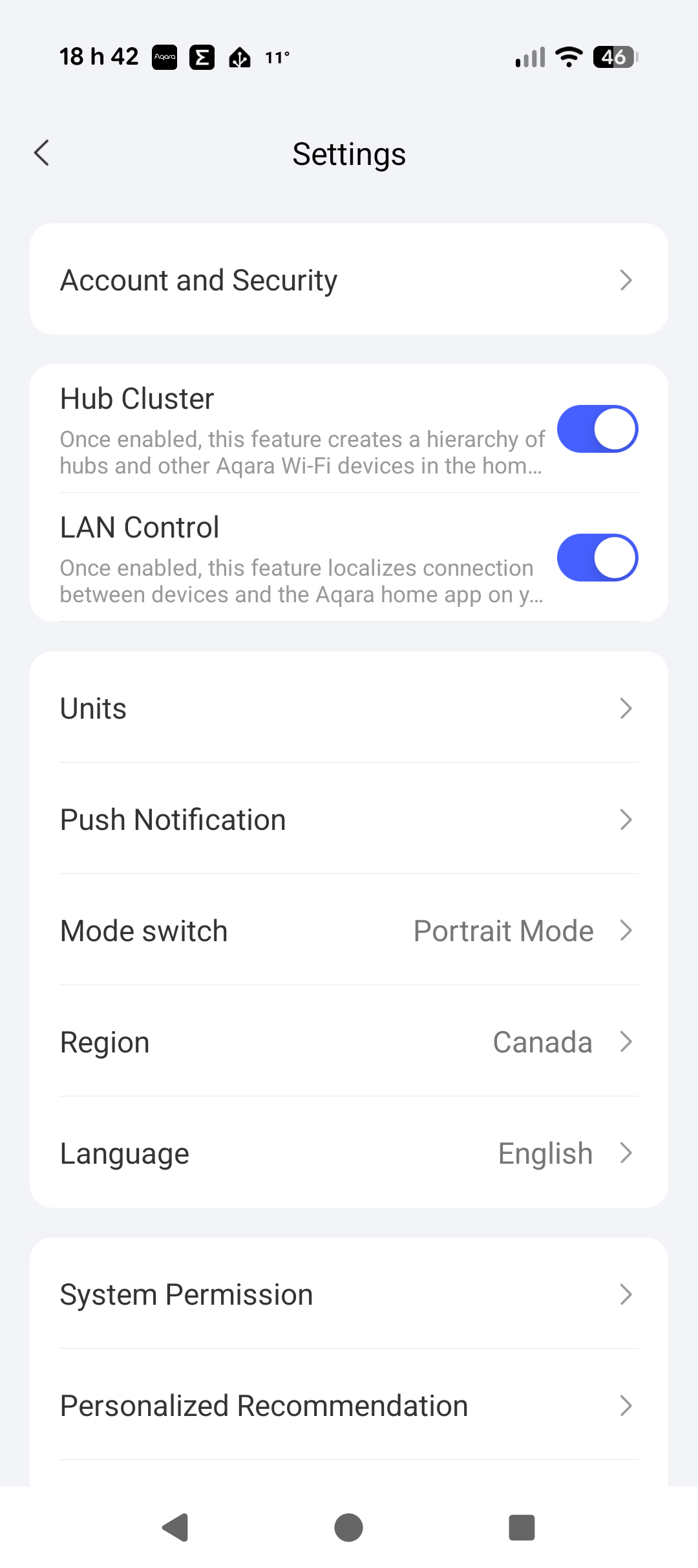

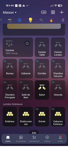

I have LAN control enable for a while now, an everything was dead/offline (M3 Hub blinking blue, and when resetting it, it said “account binding failed”), I could not turn on the lights from the Aqara app (iOS phone) or from the mini switch’s that is used to turn them on/off.
Even my “touchscreen dial (V1 EU)” showed all the connected “LED bulb T2, and the “ceiling light T1M” as offline.
So apparently even in LAN mode, it needs something or a connection to the Aqara servers, just to turn on the lights in our home’s, then we are home pressing the button’s :grimacing:
