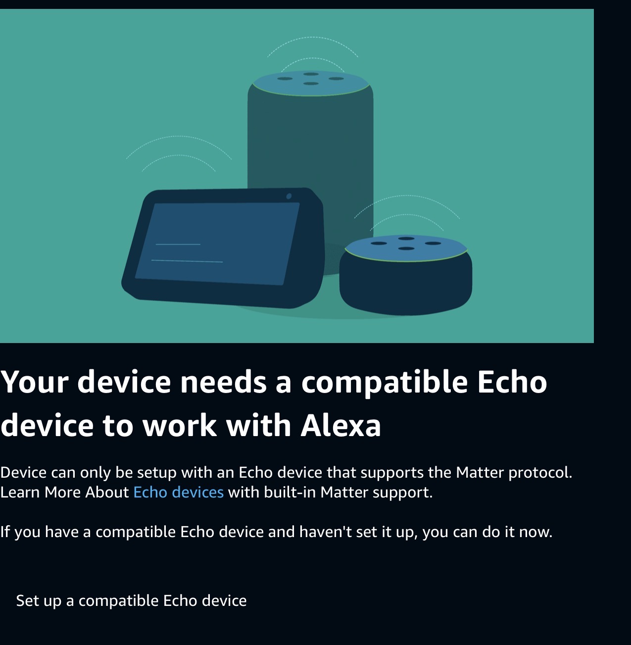

Thanks for the quick, but when I try and add the bulb via matter in the Alexa app I get this message, I guess because I use Sonos speakers for Alexa ?
what version do you have exactly from Alexa / Echo?
Sonos era 100 speakers.
Ok, this is just a speaker which is able to work with Alexa but it isn´t a hub - what hubs are you using? Best would be an Echo gen.4 with thread
Oh sorry, its the Aqara m3 hub, so I can add it all the time to the Aqara app via thread or zigbee, but either way Alexa never finds the new bulb.

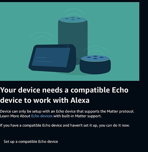

Will be returning this bulb as I have spent so much time getting this working, even called Aqara and they were not sure why and the call just ended after being put on hold. The advice I got was to add the Aqara m3 hub to Alexa but I can’t do this as i get no option to scan a qr code, only that I need a compatible Alexa device. So maybe having Sonos speakers is the issue.
