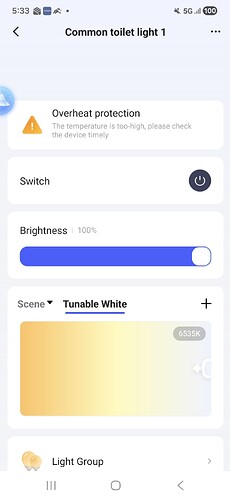

Hi Anyone encountered Aqara T2 GU10 CCT overheating issue? Which leads to the auto shut-off of the light?

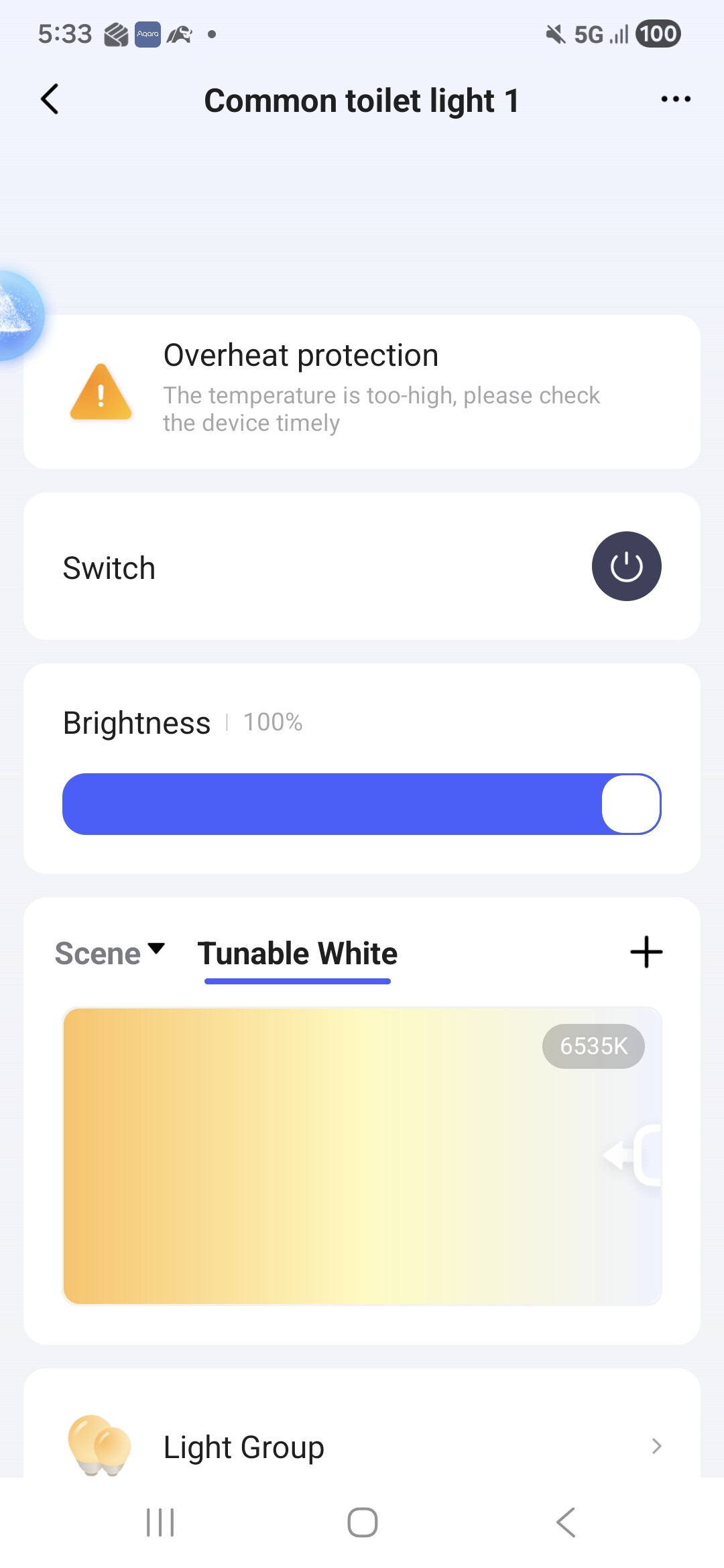

Unfortunately, I have the same problem. I received 3 pieces today and installed them in my bathroom (25-26°C during shower). After about 10 minutes, 2 out of 3 shut off!
