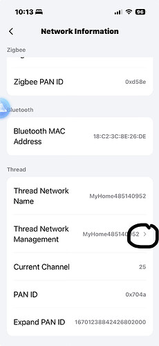

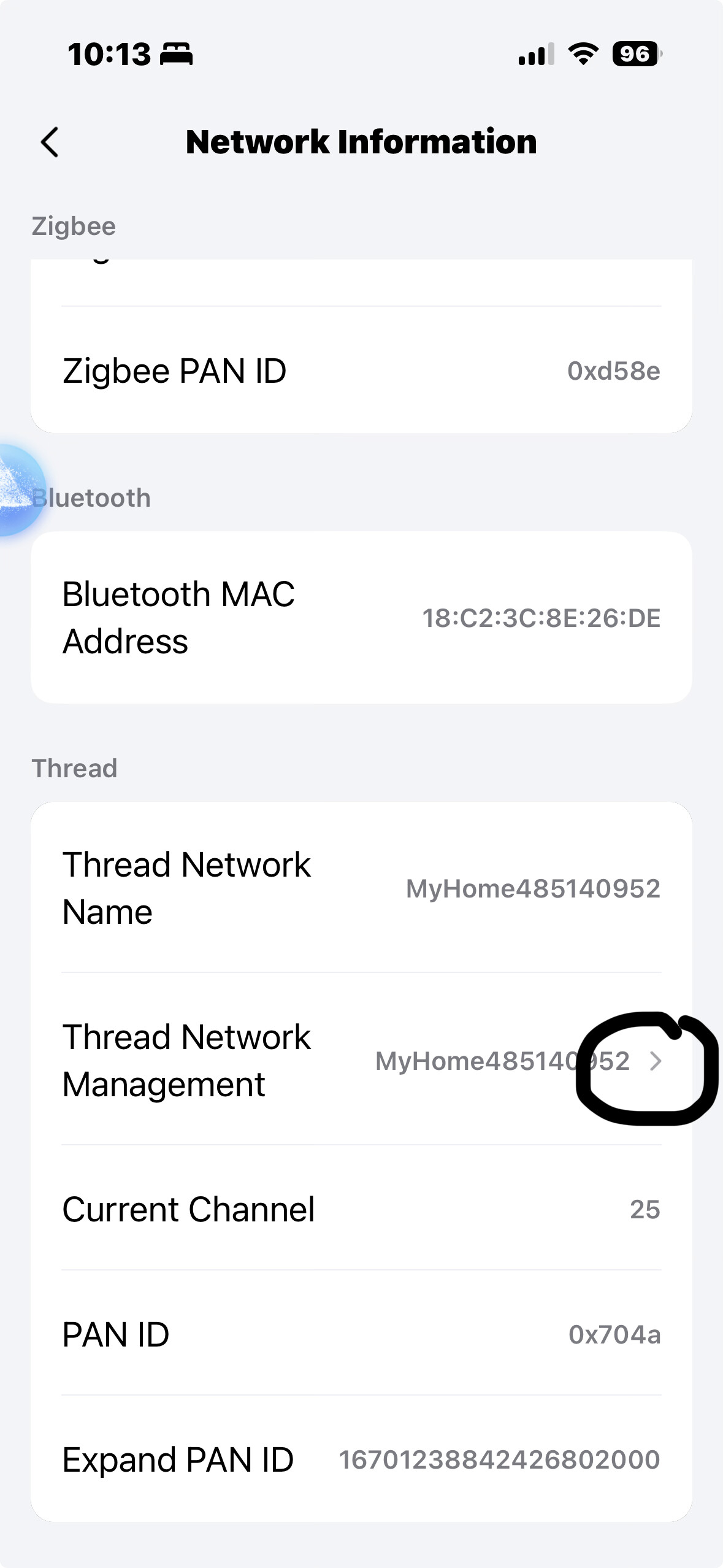

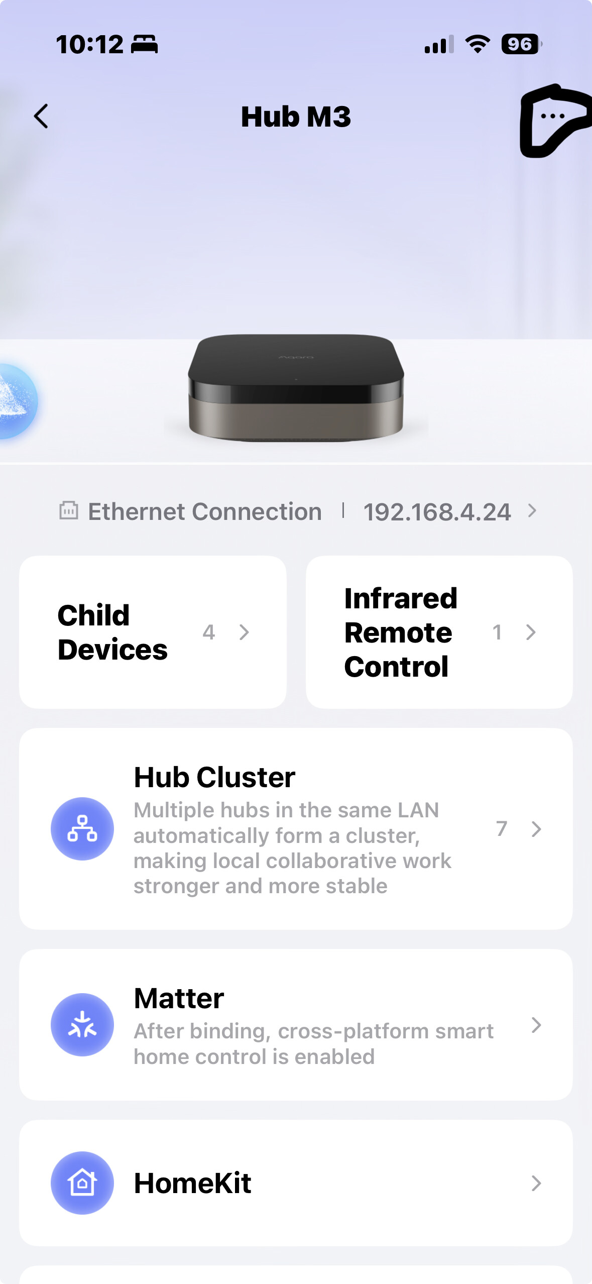

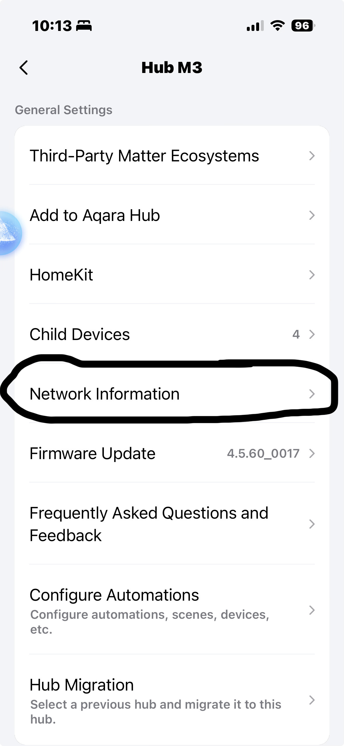

You can change the thread network for the M3 hub or any by going into its settings, if you import the thread networks into your Apple keychain it should show
