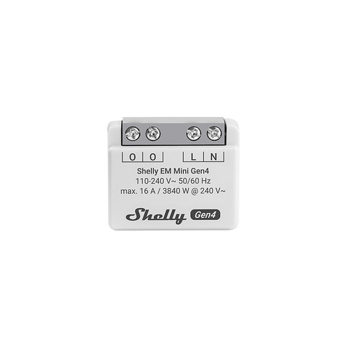

You can wait for the Shelly Gen 4 energy monitor (with matter support) to be available. It should be out soon.
