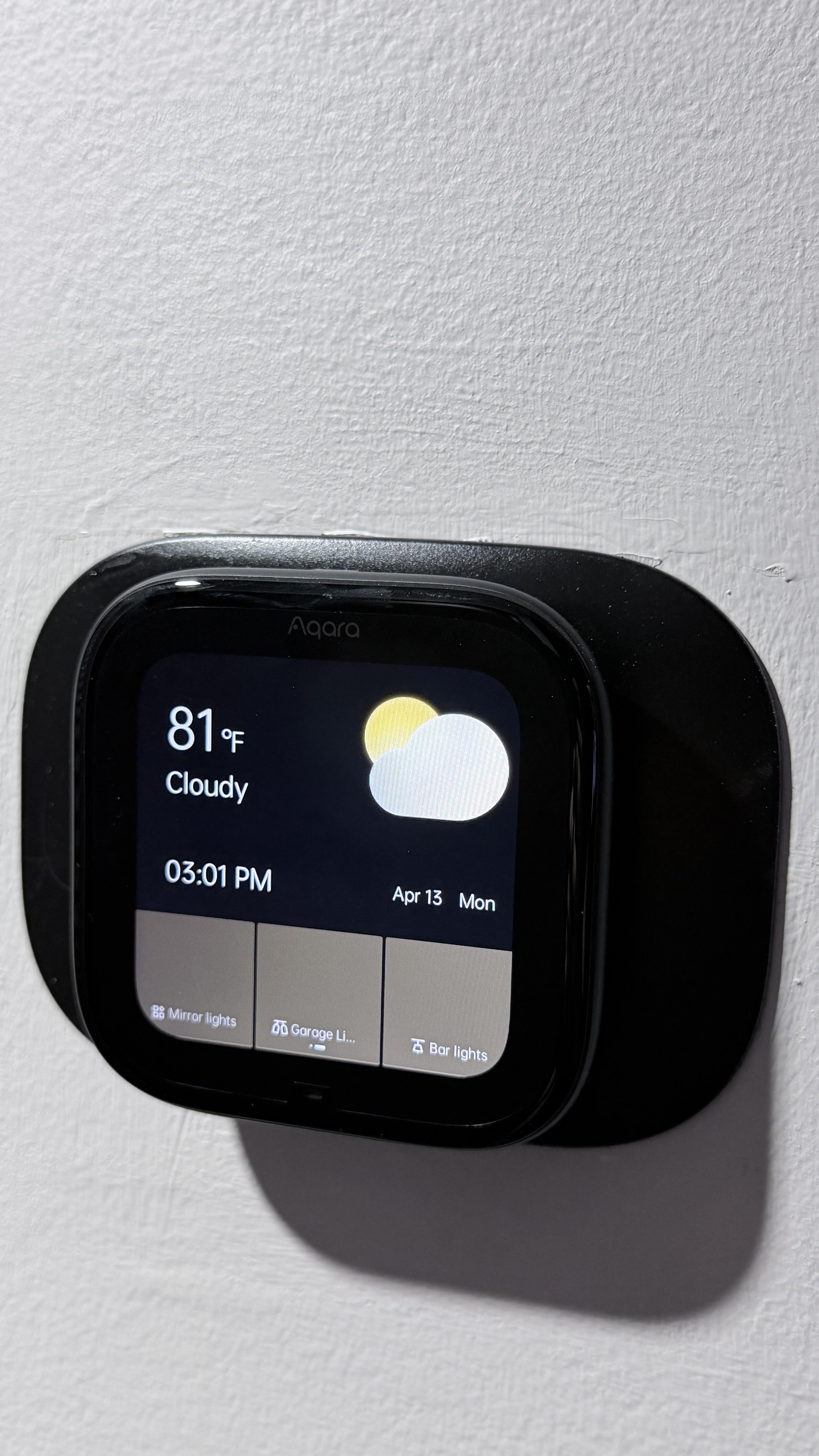

I just recently bought and installed the new W200 . I Come from using last 3 ecobee models over the years .
One thing I have to say is I am bit disappointed by the fact you can’t set a schedule and also be able to use the Apple‘s adaptive temperature. I run a home office and yes, I’m in quite a bit. I do leave and would love to just have the temperature change when I leave, but also be able to schedule for times of day and night when I want the temperature to change
. I guess I may have to play with adaptive schedule from Apple and see if it works for me. All the trim in my home has flat black so I decided match it all.
