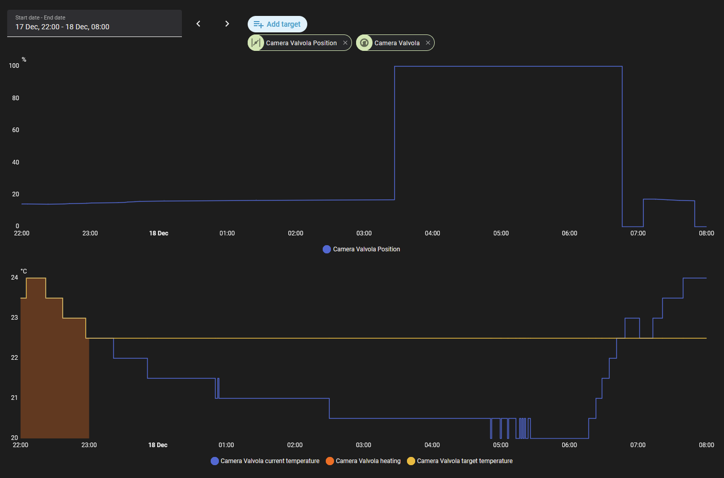

I want to report a strange issue: tonight the W600 has opened the valve for no apparent reason, because it was set to “off”. I woke up in a hot room.
My setup is the following: Home Assistant + Zigbee2MQTT.
At 23:00 the thermostat was turned off. However, the valve was kept open at 15%. The room started to cool down, because the central heating was off.
The TRV opened the valve at 03:26 to 100% for no apparent reason. At 6:46 was closed to 0%, but the central heating was on and the room started to heat. Then, shortly after opened it to 17%.
I was sleeping until 8:00.
This is not a normal behaviour: if the thermostat is set to off, it should simply close the valve and don’t heat.
When I woke up in a hot room and realized what happened, I turned on and turned off the TRV. It seems to be off to 0% since then, but it’s just 2 hours.

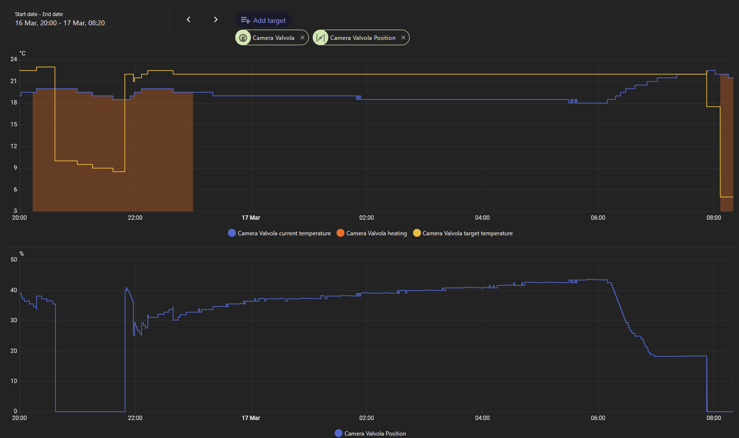

Hi all,
I’ve done a better test and the issue is still not fixed: this morning I woke up in a hot room.
The problem is always the same. The same workaround as before still works: don’t turn off the TRV, set it to a very low temperature.
