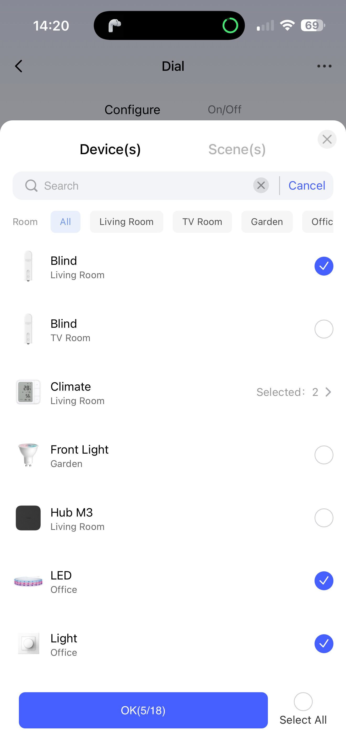

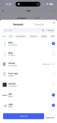

I have two H2’s. Both are in Thread mode because Zigbee mode doesn’t work on the Panel Hub S1 Plus either. Thread does work though.
I have tested in both Thread and Zigbee mode with the dial and neither show up.
If it helps, I can put one of them back in Zigbee mode for testing.
I have attached a screenshot of what devices do show up.
