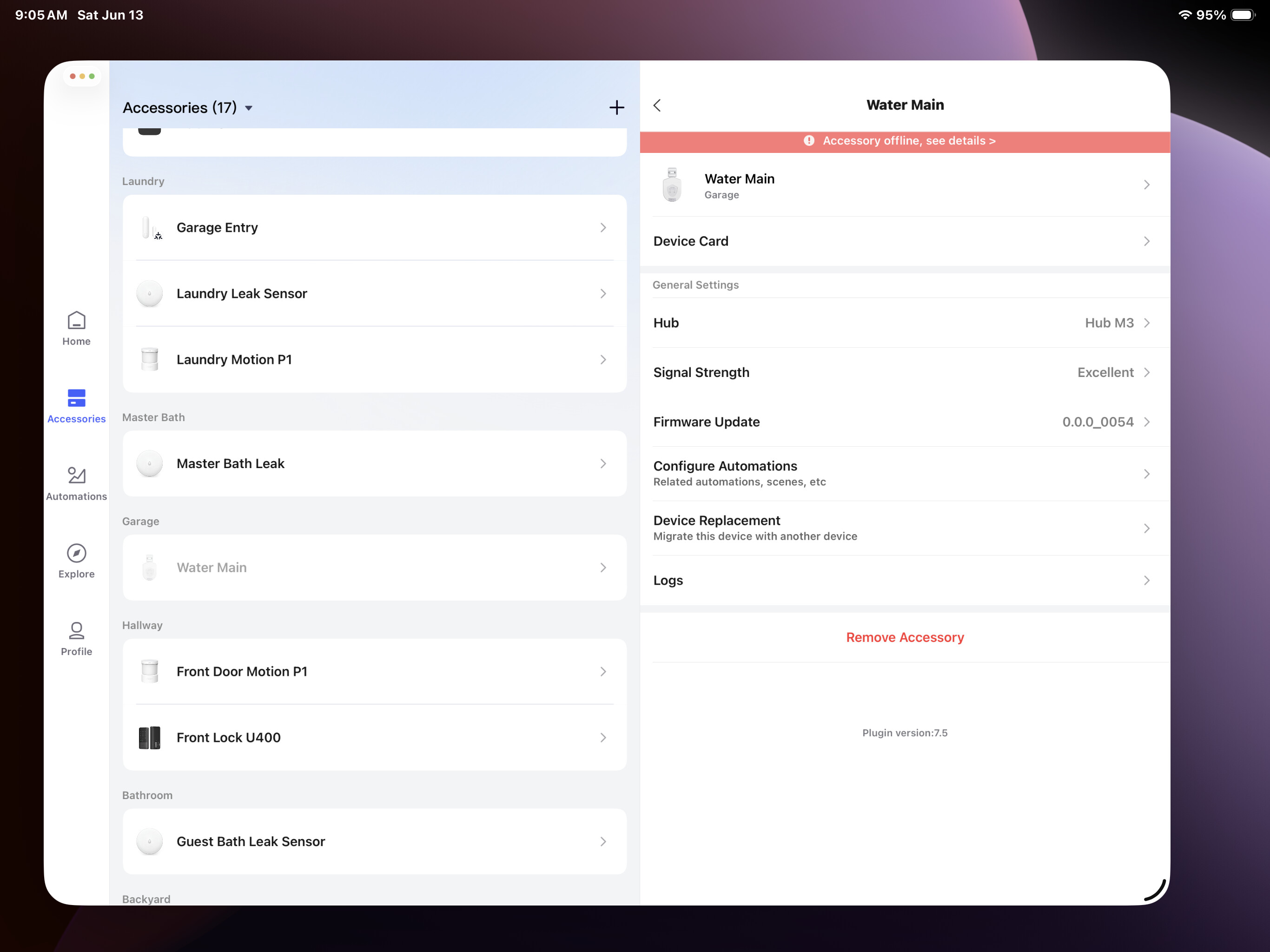

My Aqara valve is connected to my water main and works fine when it is online. But it consistently goes offline, even though it has a strong signal, as shown here. Why?

It’s connected to my M3 hub as shown in the picture in the original post. I have reset the T1 now and it is working correctly but I shouldn’t need to keep resetting it.
