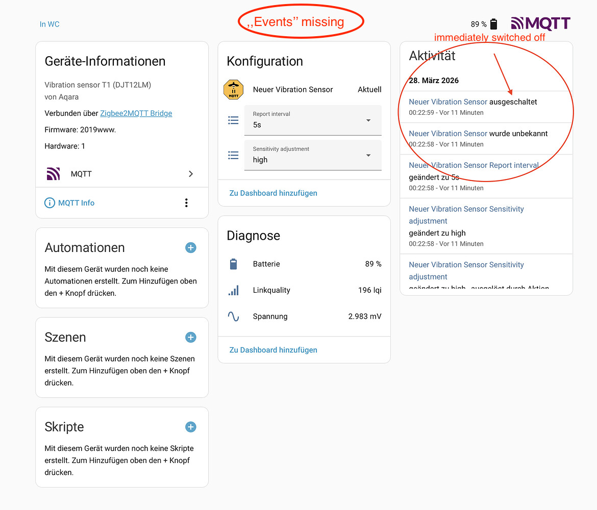

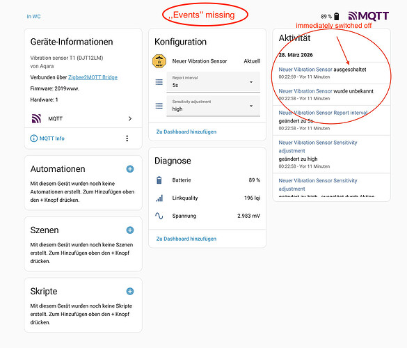

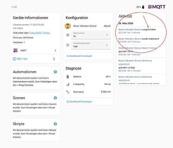

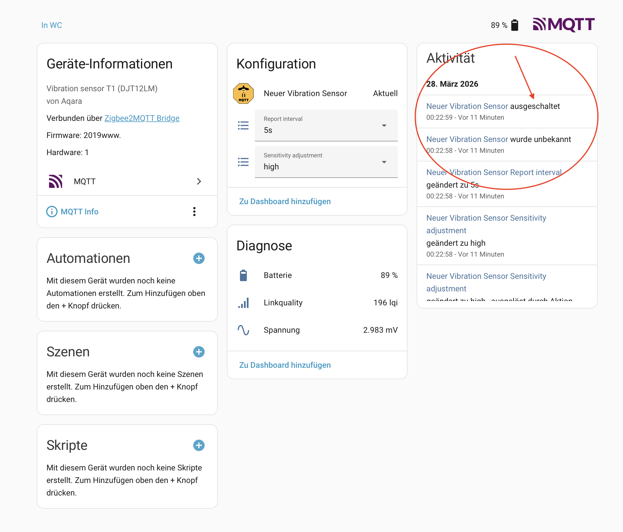

I’m still having trouble with my T1 vibration sensor.
You sent me a picture of your setup.
In that picture, EVENTS and ACTION are displayed.
This section isn’t present in my setup.
My question is:
How does the sensor integrate into Home Assistant as a device for you? Where does it appear there?
For me, it always immediately switches to OFF upon the first activation in MQTT, and it doesn’t appear in HA devices either.
I tried deleting everything I could find related to the T1 sensor using the MQTT Explorer, according to the instructions, without success.
After uninstalling, would I have to delete everything in Z2M and MQTT1??? But I’m not familiar enough with that as a new user.

It will appear in your devices list, under the name you gave it in Z2M. When you click on the “turned off” what is it actually referencing? Are you sure that’s just not the firmware update notification setting to an off state, meaning there isn’t a firmware update available? Have you enabled events in the Z2M HA integration settings, and actually moved the device to trigger an action?

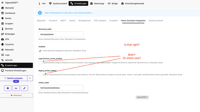

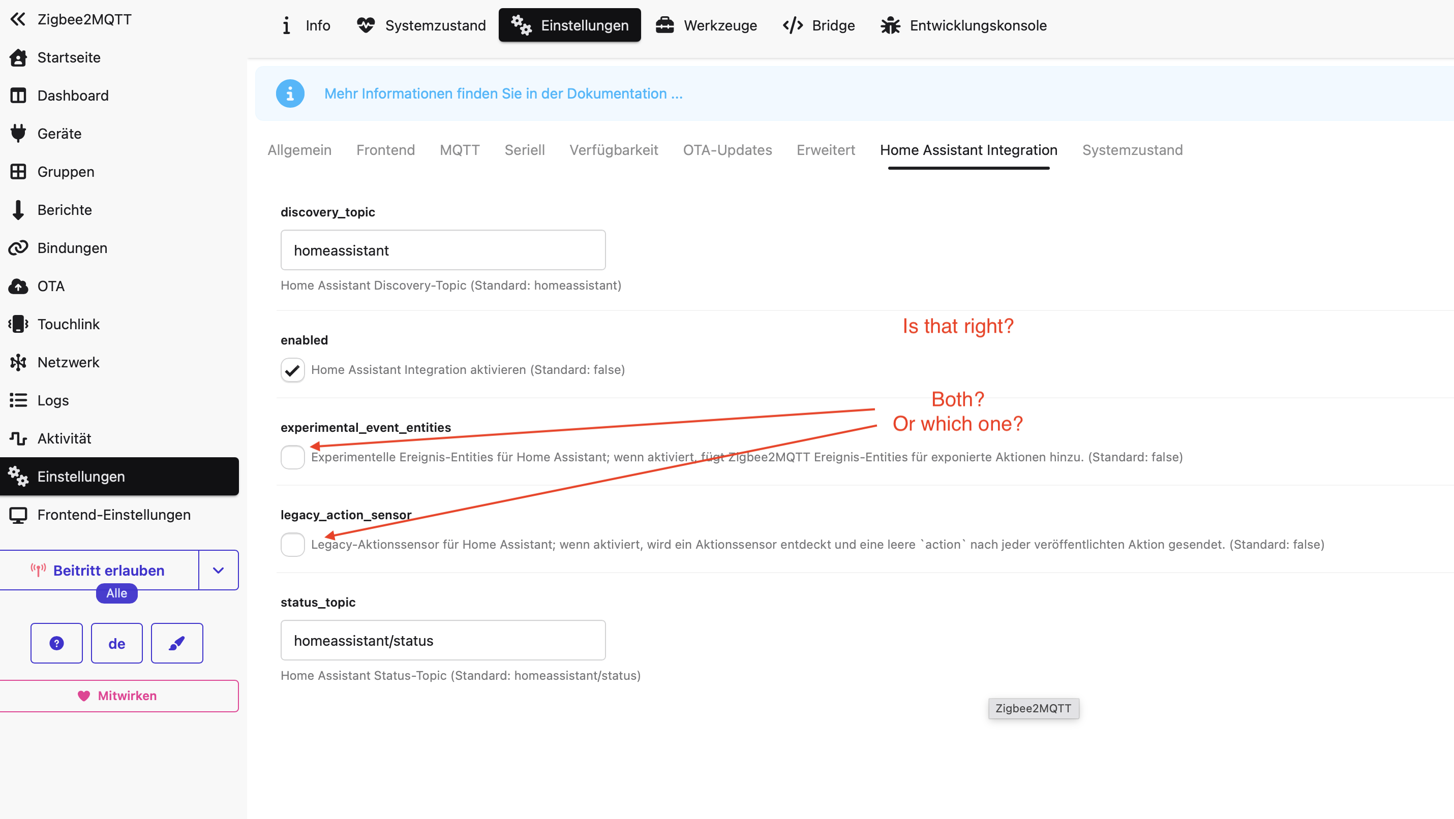

I’m sending a screenshot of the integration settings in Z2M and HA.
What should I configure there before the next installation?
How are you accessing this page if the device doesn’t appear in the device list? Do you have any filters enabled in the devices list?
Enable the event entities.

I will activate them and test them.

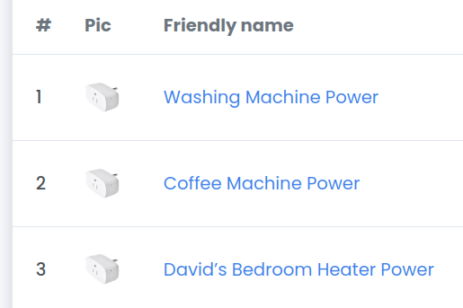

The issue with the device images is simply that you’ve got an HA theme with a white background and the device images are of devices that are white. If you want them to show up better you can only either change your HA theme or change the device images from the default ones to ones with a dark background.

Regarding device images:
I’m 100% certain that these device images were displayed with higher contrast on a white background.
This was definitely fine before an HA update,
then suddenly it’s worse!
Where are the images retrieved from, or…?
Perhaps something happened there?
(GitHub?)
You’ll need to update Zigbee2MQTT when the new version is out.
They’re pulled from the Zigbee2MQTT.io website. They usually only get updated when a new device is added. I doubt all the Aqara images were replaced recently. The change most likely happened in your HA theme setup or your display settings.
If you don’t like a device icon you can replace it with a custom one in the device settings:
