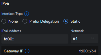

If possible, configure your internet router to use a self-assigned IPv6 prefix (ULA) rather than the IPv6 prefix used by your internet provider (GUA) in your home network.
Thank you for the explanation; I didn’t know the details yet. However, it doesn’t help me.
I have already configured my UniFi network accordingly. As I said, I have 147 devices running on Thread. Only the Climate 100s lose connection from time to time.
