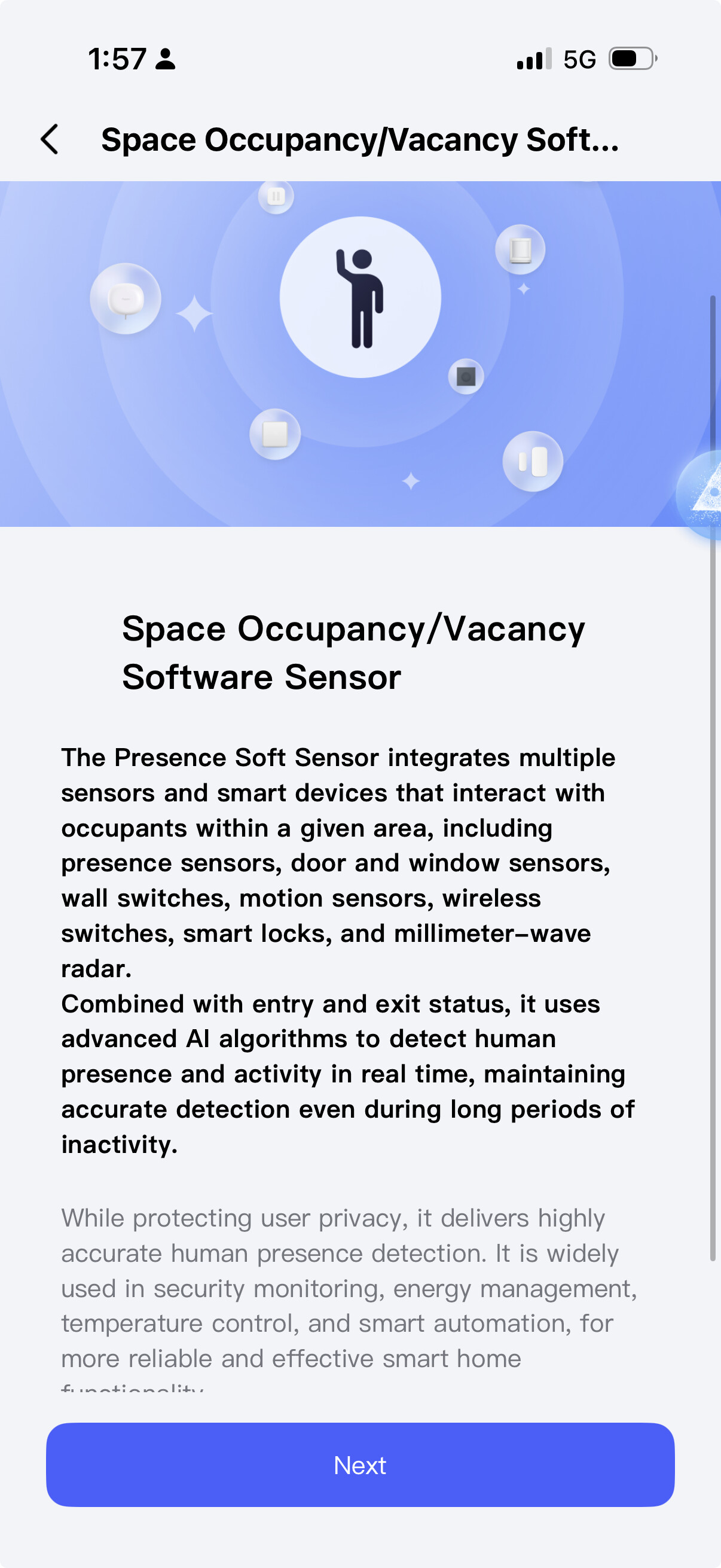

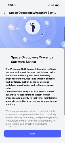

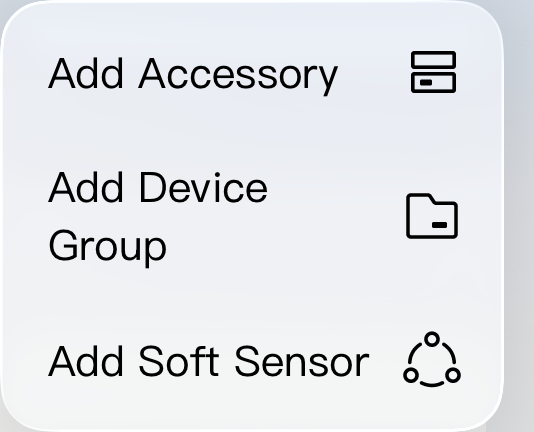

Yes, it’s available now. They call it a “Soft Sensor.” You pick which sensors you want averaged together.
First set up the soft sensor.
*Edited to add screenshots:
Then select it under ‘Set Data Source’ in W200’s settings.
That’s where you’ll also see the other new settings as well like “Follow Presence.”
