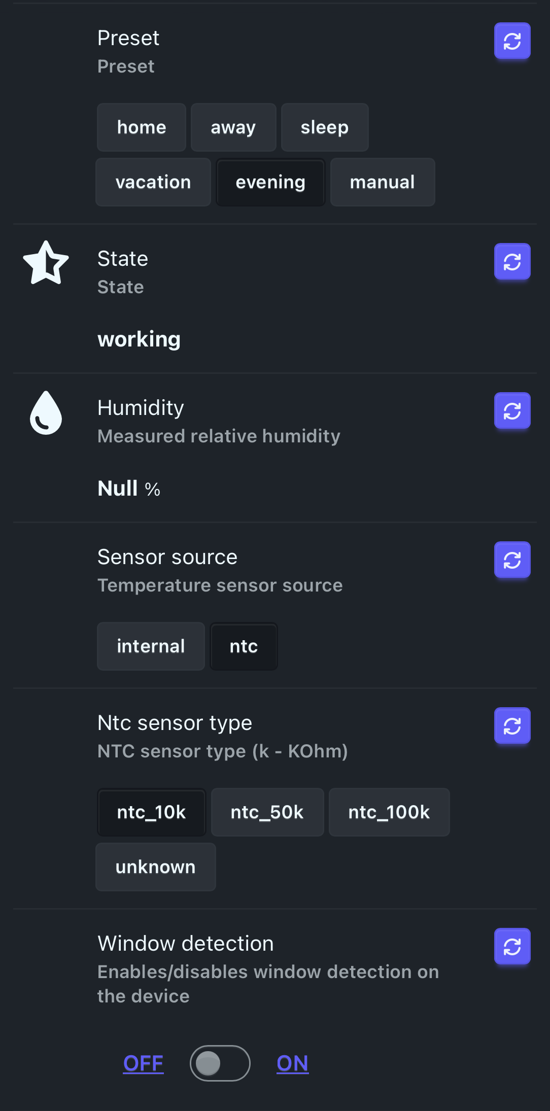

The W500 is now compatible in Zigbee2MQTT. I’ve updated this evening, and now have full control.

Thanks for the info, seems to be a big update. Z2M having a totally different GUI.
For me the device gets detected, listing a lot of stuff to configure - which it did not before - but it is still marked as unsupported. But this could be just me and bad pairing, because my network crashed the other day.

Yeah, I don’t like the GUI. I actually thought it was broken.
Perhaps try deleting and re-adding the stat?

My problem with re-adding (and I had this problem before the update, after deleting / adding a lot for getting the device to work): The device showed up after adding (unsupported), I delete the device, then I add again, it shows up very briefly, disappears on its own and then readding does not work anymore. Also it is still listed in the yaml. I delete it there, but readding still does not work anymore. I don’t think it’s a device issue though, I think it’s my Zigbee messed up (a little).
EDIT:
Setting up my network (again) from scratch. Pairing of the W500 without any problem, seems to work now.
