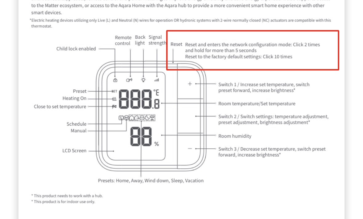

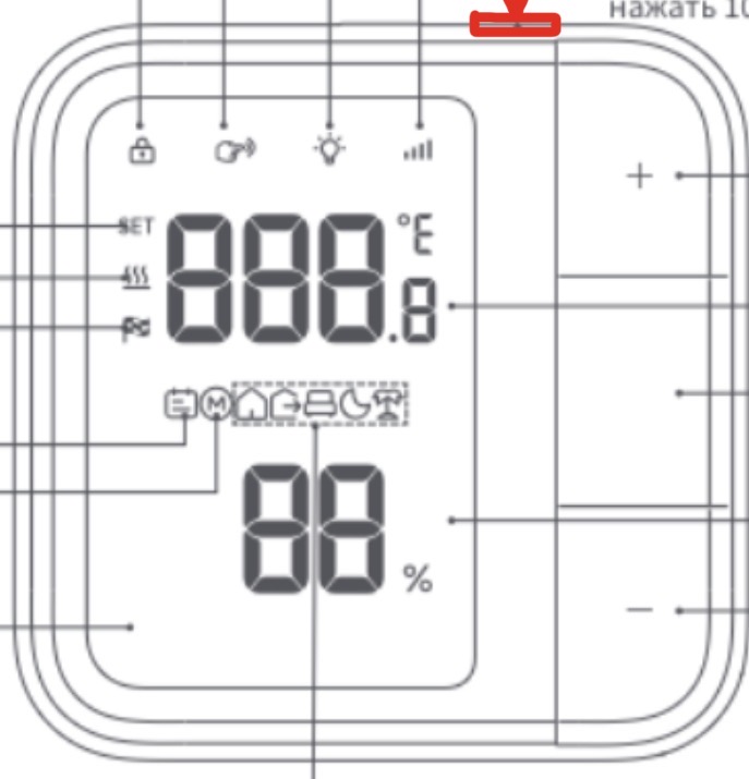

If you need a factory reset, then here is the algorithm:
Press 2 times, pause, press 10 times the ra button.
If you need a network settings reset, here is the reset algorithm:
Press 2 times, pause, press and hold for 5 seconds.
